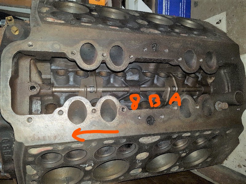

    My brother is in a bit of a ******* contest with them right now up in M***. He bought a 1931 A bodied Brookeville on a 32 reproduction ch***is out of NY. It was a roller without engine and transmission but complete otherwise and had been on the road in NY. He has a NY state registration signed over to him along with a Bill of Sale. He purchased a 1950 flathead V8 and 5 speed and installed it. He has bills of sale for all parts. When he went to get it inspected to get a VIN all was ok except for the engine. The **** he was working with said the flathead had to have a typical Mfg. number on it that could be traced or he wouldn't proceed with the paper work. Even if he did a bonded ***le! He essentially told my brother that if he put a small block Chevy into it from 1968 or later it would have the numbers "he" says it has to have. My brother has actually bought a small block Chevy to put in it just to solve this ******* contest. I think this is ******** that he should have to pull out a complete functioning engine and swap it out to satisfy this guys requirements. I guess the moral of the story is if your doing this in M*** be prepared for a large level of ********! That and have as much do***entation as you can get.

    I'd say that comes down to your brother having the do***entation as to what serial numbers if any that that block might have on it.
    There is supposed to be a partial serial number stamped in the back right hand corner of the mounting surface for the intake that allegedly is visible with head and intake on.
    This photo snagged from this article in the Ford barn8BA engine number location - The Ford Barn
    Sources say that is a date code from when the engine was ***embled but the link I provided a minute ago doesn't jive with that block so I am going to have to turn around and research my flathead books.
    GordonC likes this.

    Mr48chev thanks. I thought whatever numbers he could find on the flattie block should have been good enough but who knows if the thing has been surfaced and they were wiped out? As old as these things are nothing surprises me anymore. Plus in M*** they want the almighty tax dollar. Anything they can do to make you PAY they will do! I lived there for more than 40 years so I have first hand experience with how ugly it can get!
