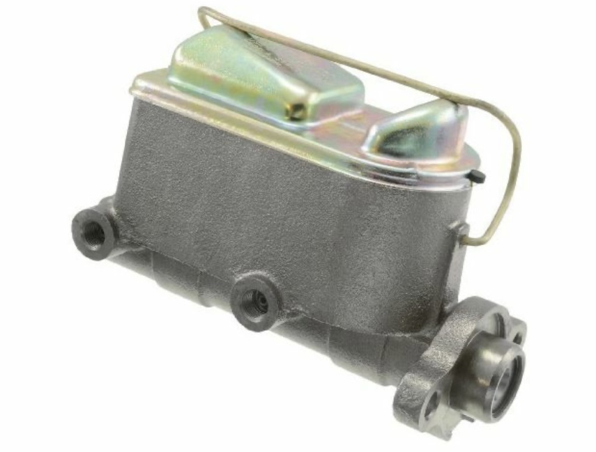

  4. RodStRace
    Joined: Dec 7, 2007
    Posts: 9,289
    RodStRace
    BTW, this is usually the rear reservoir, closest to the firewall.
    So rear brakes in front, front brakes in rear. You want the fronts to grab first, although if everything is bled properly, it will be at the same time.

  5. Johnny Gee
    Joined: Dec 3, 2009
    Posts: 14,451
    Johnny Gee
    from Downey, Ca

  7. RodStRace
    Joined: Dec 7, 2007
    Posts: 9,289
    RodStRace
    Most I've seen are what I showed, but there is always an exception!
    The willwood is probably equal size under the cover, like a corvette 4WDB MC.

  9. MAD MIKE
    Joined: Aug 1, 2009
    Posts: 964
    MAD MIKE
    from 94577
    FWIW
    As posted by Johnny Gee, this disc/drum MC was used in most GM cars/light trucks from '69- ~'80 that used disc front brakes. This MC was then replaced by the 'metric' stepped quick take up plastic reservoir units in the late 70's.
    Handy bit is this disc/drum MCs used the same port sizes as the drum/drum MCs in 67-72. So if you want to convert to disc in those cars(or a car that has used a GM 67-72 drum/drum MC) was simply a matter of changing the MC, no need for adapters or re-plumbing at the MC.
