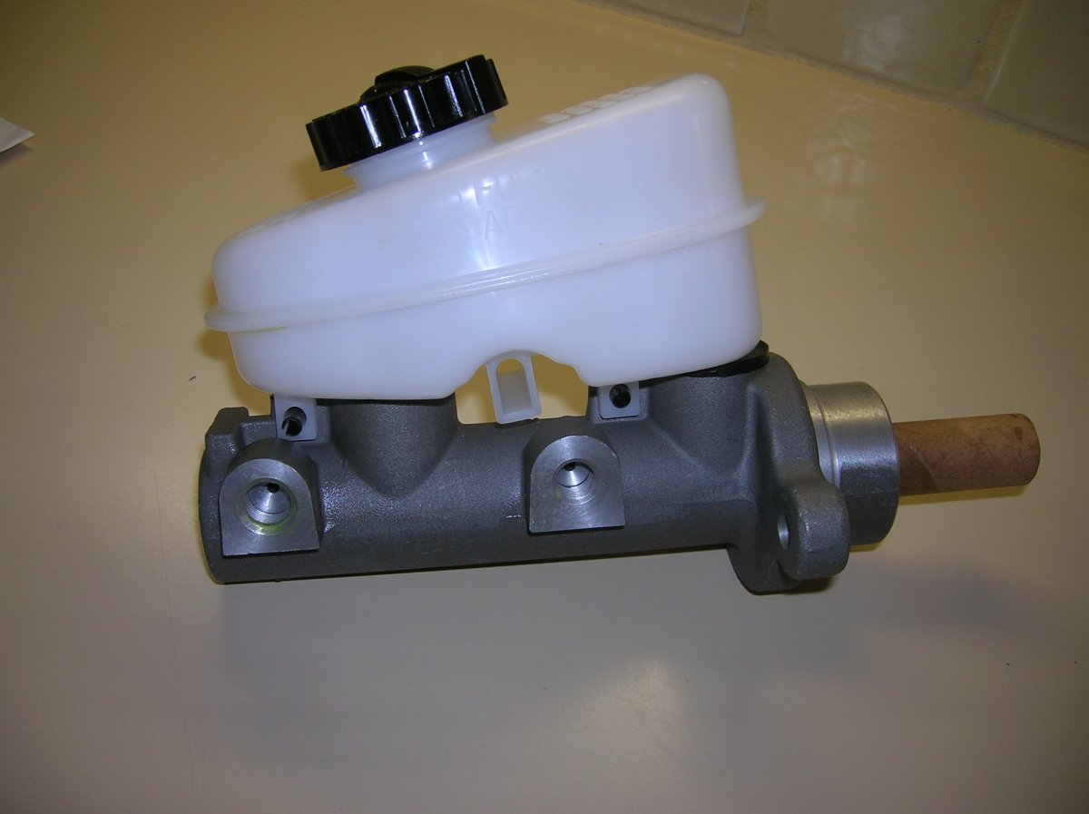

    Here's a photo. Large (12mm) fitting is towards front and small (10mm) fitting towards rear. The orifices are the same size. DSCN2415.JPG

    Learning the OE pri./sec. plumbing is what I meant. That style master was designed to be mounted angled up to level the cap, and it looks like the primary (closest to the mounting flange) section of the reservoir is larger than the secondary, so the primary is probably the front disc circuit. But, I would not use that master mounted level because of the angled reservoir. There are many older style disc/drum 1" masters that have level and obvious disc/drum fluid reservoirs to choose from.

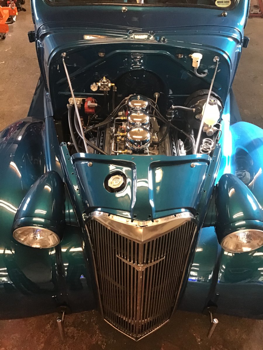

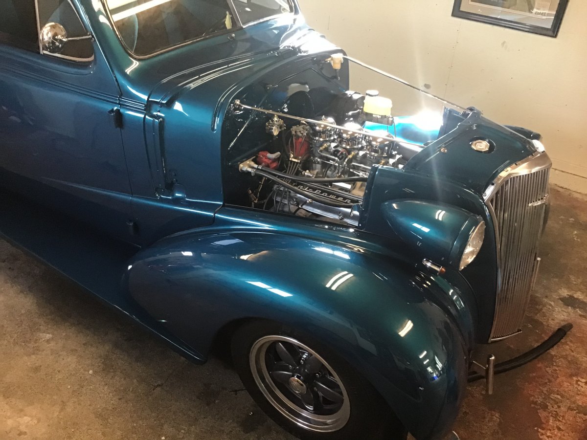

    If you look at the reservoir in my avatar picture it was a early 80s elcamino style and is supposed to be angle mounted but the previous owner mounted it level and it looked odd and wouldn’t fill properly.
    After much research I figured late 90s Chevy s10 master had the same bore as the elcamino master and the fittings even matched up. It was also a direct bolt on to the booster.
    V8 Bob is exactly right this does look like a angled master and it does look like the orifice closest to the firewall is the front disc circuit - also notice on the master you have shown that the larger part of the reservoir is to the rear.
    Here is pictures of my new master.
    Note the thinner 3/16 line is at the rear of my new master but it used to be at the front of my old master...I think.

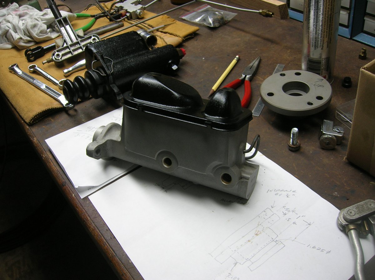

    Yeah, I am not a fan of the angled and plastic reservoir either, however this master cylinder has been used successfully by quite a few 1930s to 1950s Mopar truck owners. It adapts easily and fits in a tight location between the steering box and the starter. I'm thinking the larger reservoirs on many disc / drum master cylinders are made that way only due to more volume of fluid needed on the front disc side as the pads wear down. I think that would be important for daily drivers whom most don't check fluid often if at all? I was able to adapt a disc / drum split master cylinder (15/16" bore) while I was still running all drum brakes. I did this in preparation for the front disc project. I had immediately had a pedal travel issue and other weird braking things after removing the original single stage master cylinder (1.25" bore dia.). I did not do my homework that time and did not install any residual valves in the system, which I'm now thinking was causing the weird braking and possibly excessive pedal travel? Anyhow, my logic was to up the MC bore diameter slightly to 1" to help with the pedal travel. If my calculations are correct? I should have a decent setup calculating at 70lb leg force with a 7.5 pedal ratio = 525 / .785 (mc bore surface area) = 668.8 psi X 4.9087 (2.5"caliper bore surface area) = 3,282.9 clamping force. Does this sound correct or reasonable?
  17. 57 Fargo
    Joined: Jan 22, 2012
    Posts: 6,274
    57 Fargo
    Yes, your pedal travel was a result of the smaller bore, it will increase pressure but at increased pedal travel. You are also correct about the reservoir size.

    I'm am using the same plastic master you pictured off a '98 Cherokee on my '53 Dodge 1/2 ton with disc/drum and a proportioning valve that is plumbed front of master to front of proportioning valve and rear of master to rear of proportioning, then from the rear of the proportioning valve to the front (disc) brakes and from the front of the proportioning valve to the rear (drum) brakes. That is the way it was plumbed on the donor I pulled it from and has worked flawlessly since. Things are kinda tight in there so the proportioning valve is mounted between the master cylinder and the starter. The reservoir is not mounted level.
