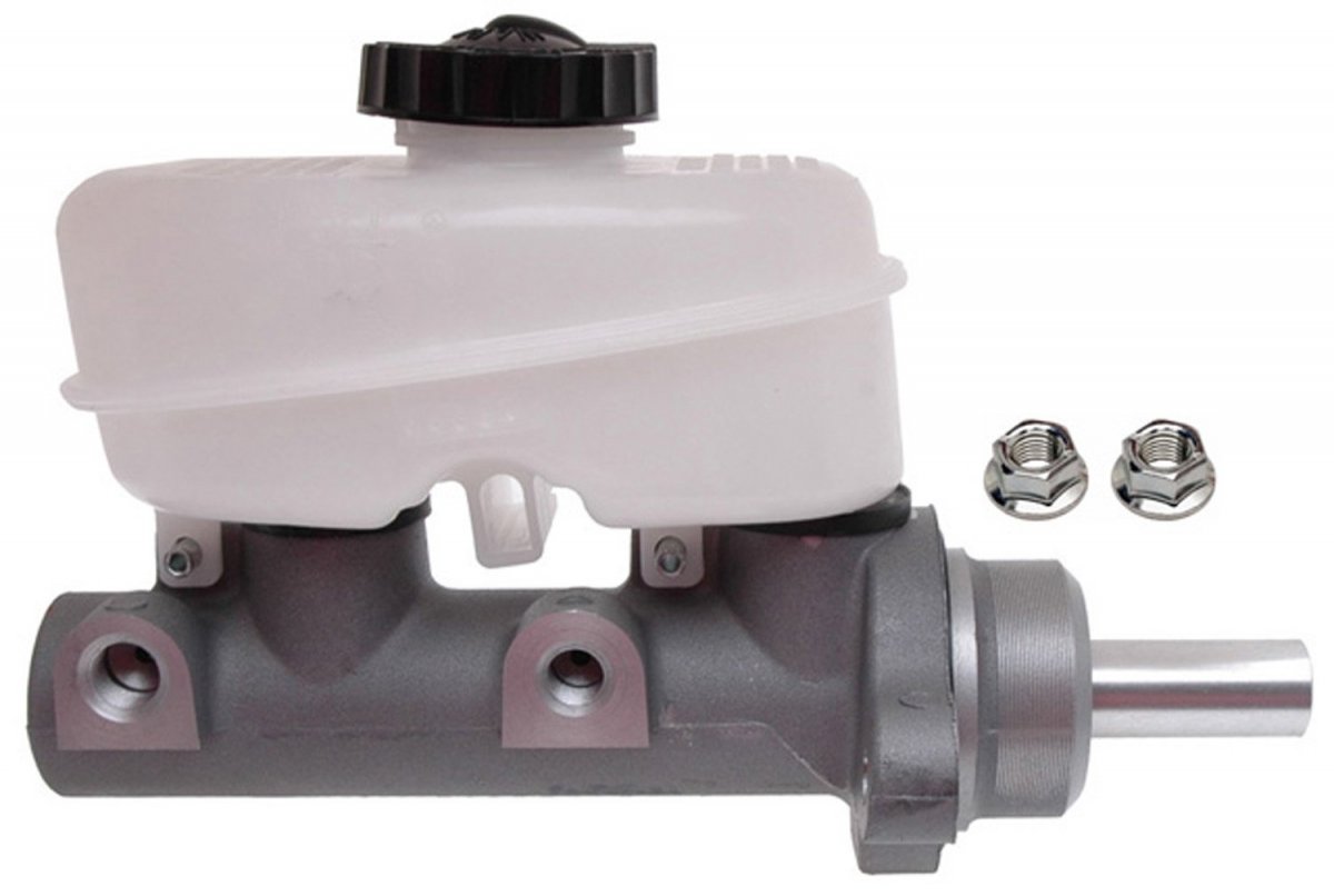

    Here is a list of masters used by g body Malibu’s that convert to manual brakes and different masters they use to get it done . The one in the picture is dodge shadow I believe. The one I use isn’t on the list because they discovered it later . Good news some are dodge.

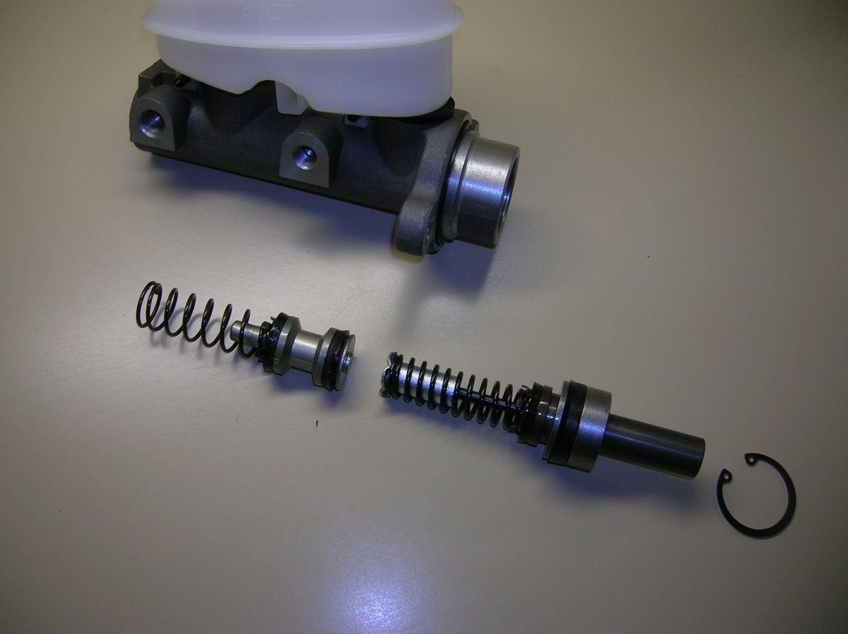

    Yes, that's why I'm trying to find those who have had success with similar applications. Several Dodge / Plymouth truck enthusiasts support the 95 - 01 Jeep MC's. They report having good pedal and stopping ability with the 1" bore master. Of course all of this is anecdotal. Without professional testing facilities and equipment it's impossible to make accurate comparisons. I'll bet there's more than a few street rods with "upgraded" brake systems that were actually downgraded? I do see the advantage of a step bore in some applications and welcome more opinions on them. The Jeep master I have pictured and which is reported to have worked well for others is not a step bore. I'm hoping to keep it as simple as possible. DSCN2419.JPG DSCN2420.JPG

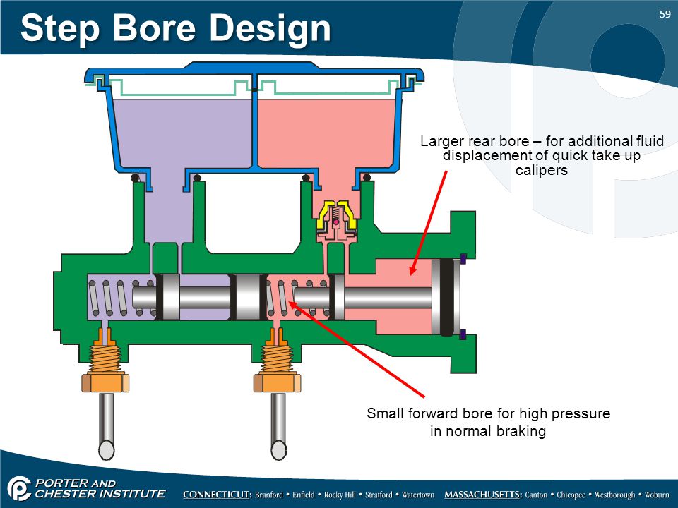

    Steve..... This is a standard type M/C schematic

    This is a stepped bore M/C schematic [also known as a quick uptake M/C]
    And this is the Jeep M/C internals you posted.

    I think I understand the step bore principal? It's not easy to see in my photo, but the larger dia. piece that looks like a piston is only a seal. It goes up against a stepped down flange and can not move after the retaining ring is installed. I'm fairly certain mine is not a step down.

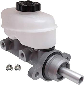

    Thanks! for all your help. I just found the exact same master cylinder that I have with a level reservoir. Of course! After I already bought this one. Lols! I tried finding just the reservoir separately, but no such luck. AC Delco 18M802.jpg Side view AC Delco 18M802.jpg
