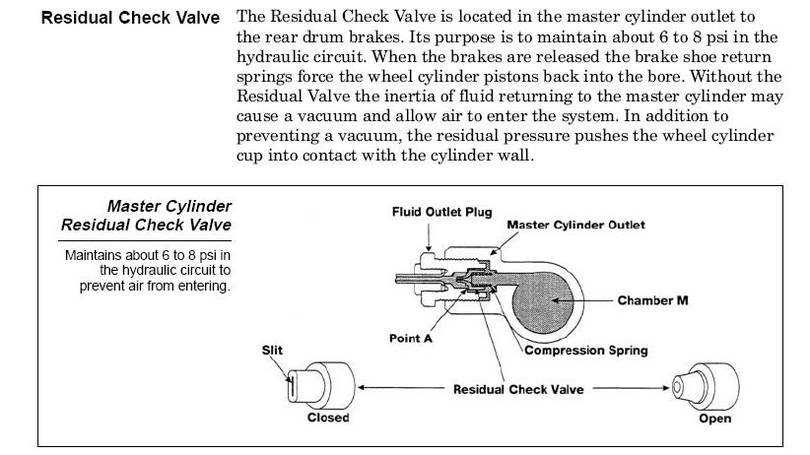

    RESIDUAL+CHECK+VALVE+disc_rear+drum+brakes..jpg Boy since you are the hall monitor, you need to be careful about falsely stating that this is all false.
    So if he has a residual valve in line and a residual valve in the master cylinder is my major point.
    Also there is no cup to hold against the piston wall in a disc brake and it is uncommon to use one on a disc application.
    I stand corrected on the original basis for a residual valve...though that has changed over the years. However I am questioning if his master cylinder is a equipped with a residual valve AND an inline valve plus having a residual valve on the discs

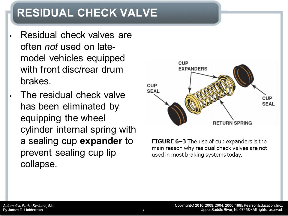

    I’m sorry, it was all false, like it or not, if he has two residual valves I don’t think it would make any difference at all, it’s strictly a one way check valve. You only need a two pound residual valve on disc brakes if the master is below the calipers but it won’t hurt anything.
    The purpose on drum brakes has not changed over the years, sorry again. They were phased out with the advent of cup expanders in wheel cylinders.

    Really hard to know without taking it apart and looking for the cup expanders, the cup seals are the same there will be a metal disc between the spring and seal or the end of the spring will be wound in a taper that fits inside the seal
