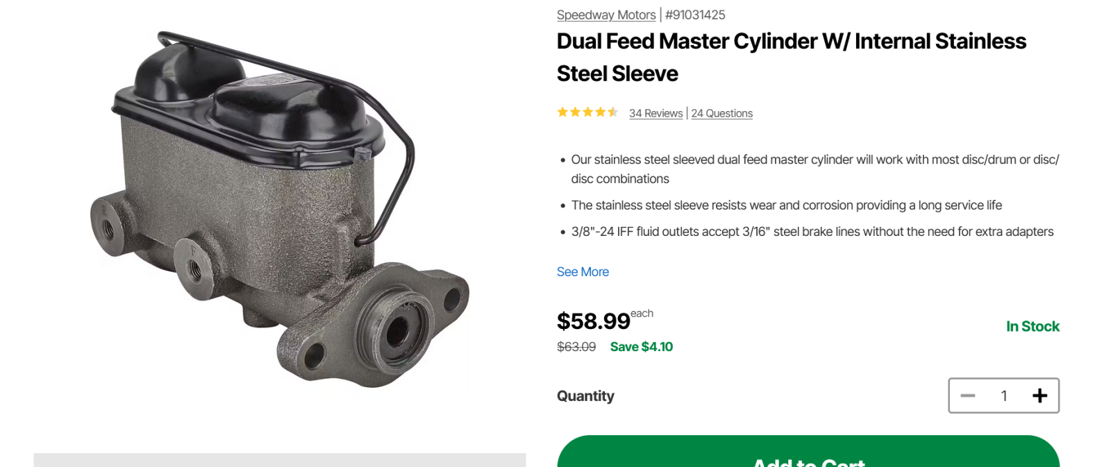

    Hi Tim, I am using Speedways #910-31425. It has a 1" with bore stainless steel sleeve. Stock 40 Ford brake pedal . I purchased it in 2012 It is used with a 11 disc front and ford drum brakes in the rear I have used it for 8 years with no problems. Pedal pressure is very satisfactory.
    Sam
    chryslerfan55 and anothercarguy like this.

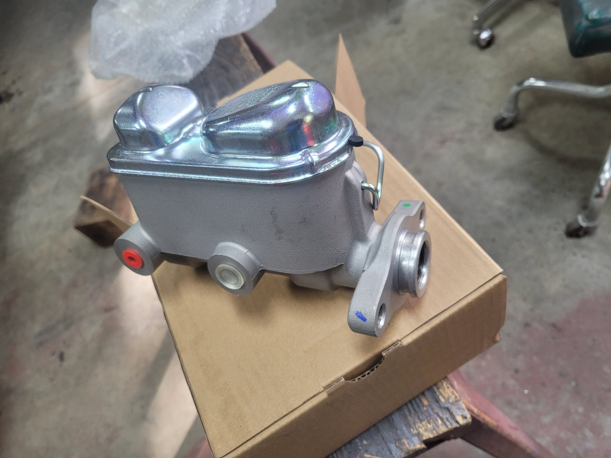

    To close the loop...I ordered the "Quality Built" brand MC from Rock auto. They are indeed made in China as suspected. 20241011_104305.jpg 20241011_104256.jpg The MC looks good and is made of aluminum.

    For all the slagging China gets, they seem to make fairly decent castings.
    It's the finish machining that needs to be carefully checked.
