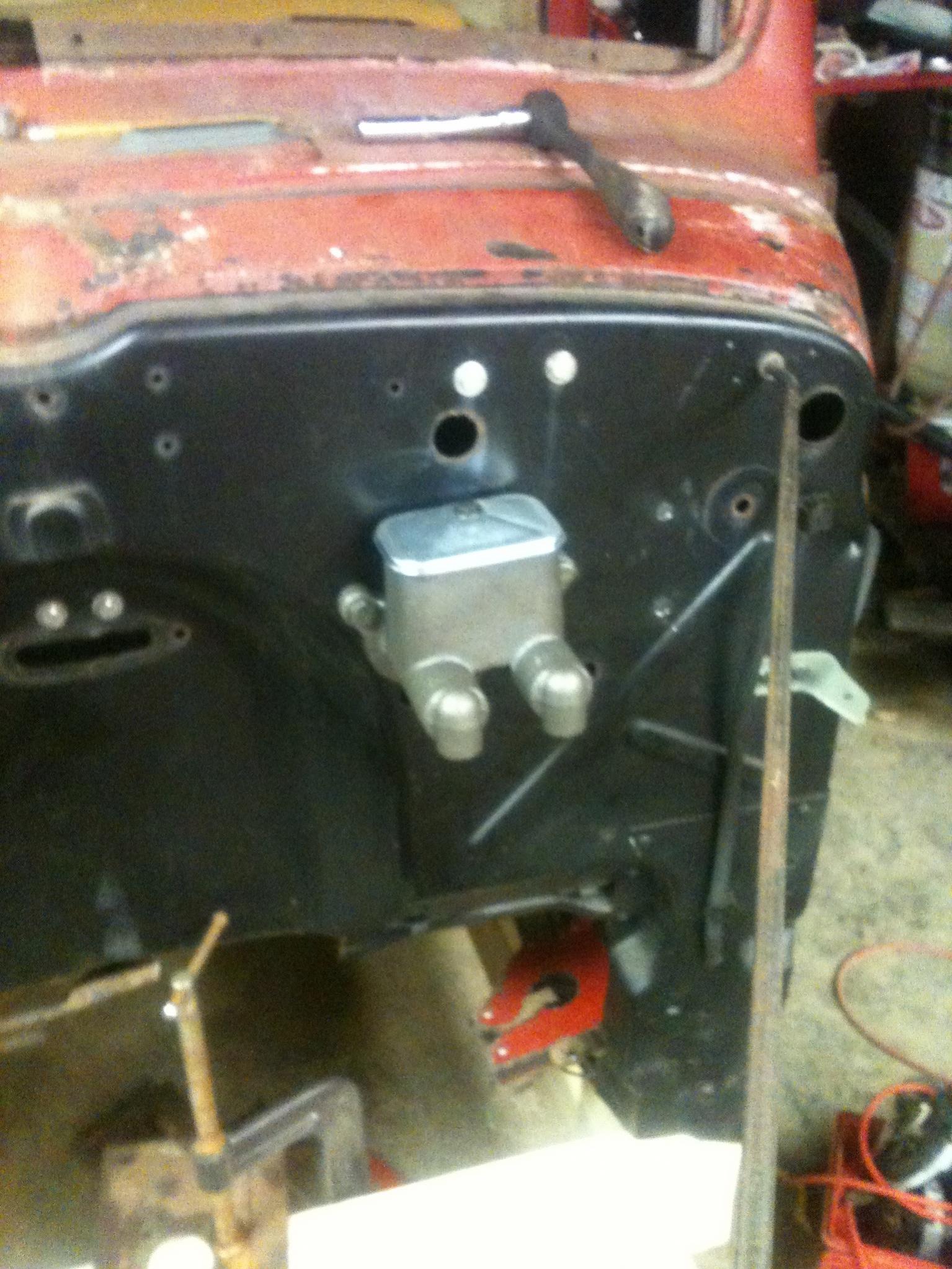

    I'll open my master up tonight and mic. it, but since I have the right pedals, It's kind of a non-issue for me, but might help some body else. I got the holes for the pedals transfered, and removed the stiffening rib so the master sits flat, I also cut a 0.125" steel plate that is to be welded to re-enforce the firewall. Here is a pic from the engine side.
