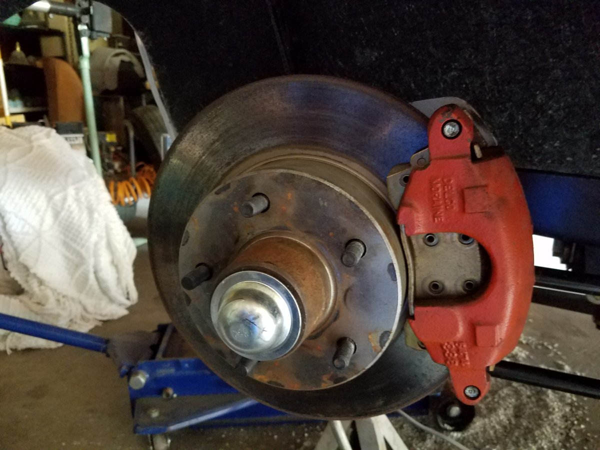

    I've been working on my brakes recently (under floor disc/drum on a model A) I found I had a 68-74 Bronco master and these didn't use discs until later, so I'm thinking this is a drum/drum master. It does have a small/large chamber, so I'm a bit confused. I bought wilwood residuals and adjustable proportioning valve and am about to get a new master. Any ideas for what to use 78 f150? 79 Camaro? Wilwood? Also.....when you get a new master which side has a built in residual valve?

    So I have GM discs from around 79? A matching 79 master should work. In a factory new master it sounds like there would be a residual built into the disc side only, right? 20180712_111937.jpg
  21. Yes on the Master style. The residual is on the Drum side not disc.
