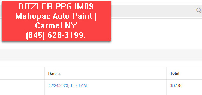

    I Googled "1933 Plymouth Radio Blue" and found a place that mixes up a rattle can for you so I ordered one.
    It looks to be what I was looking for since it will be a total new paint job and doesn't need to be 100% exact. x.jpg

    Must be a BIG rattlecan! :D

  14. How much was that rattle can and how many will it take?

    Test spray is my guess. If good then off to the paint store for the real stuff.
