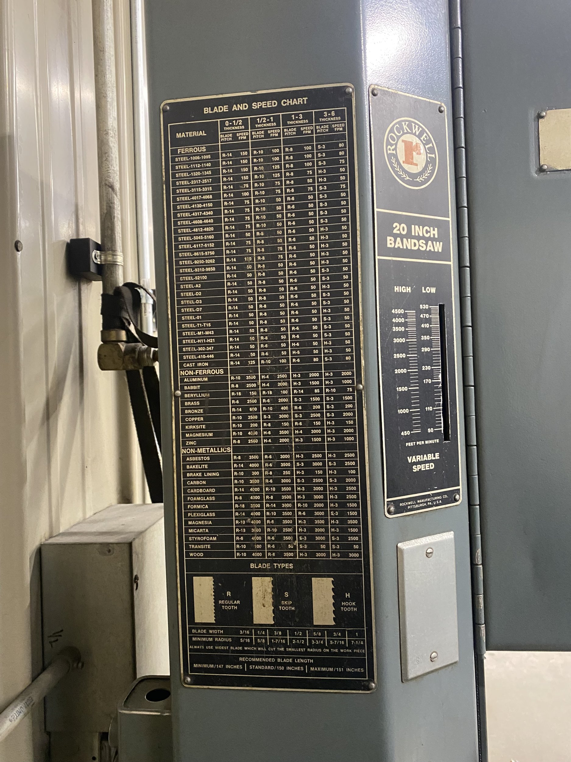

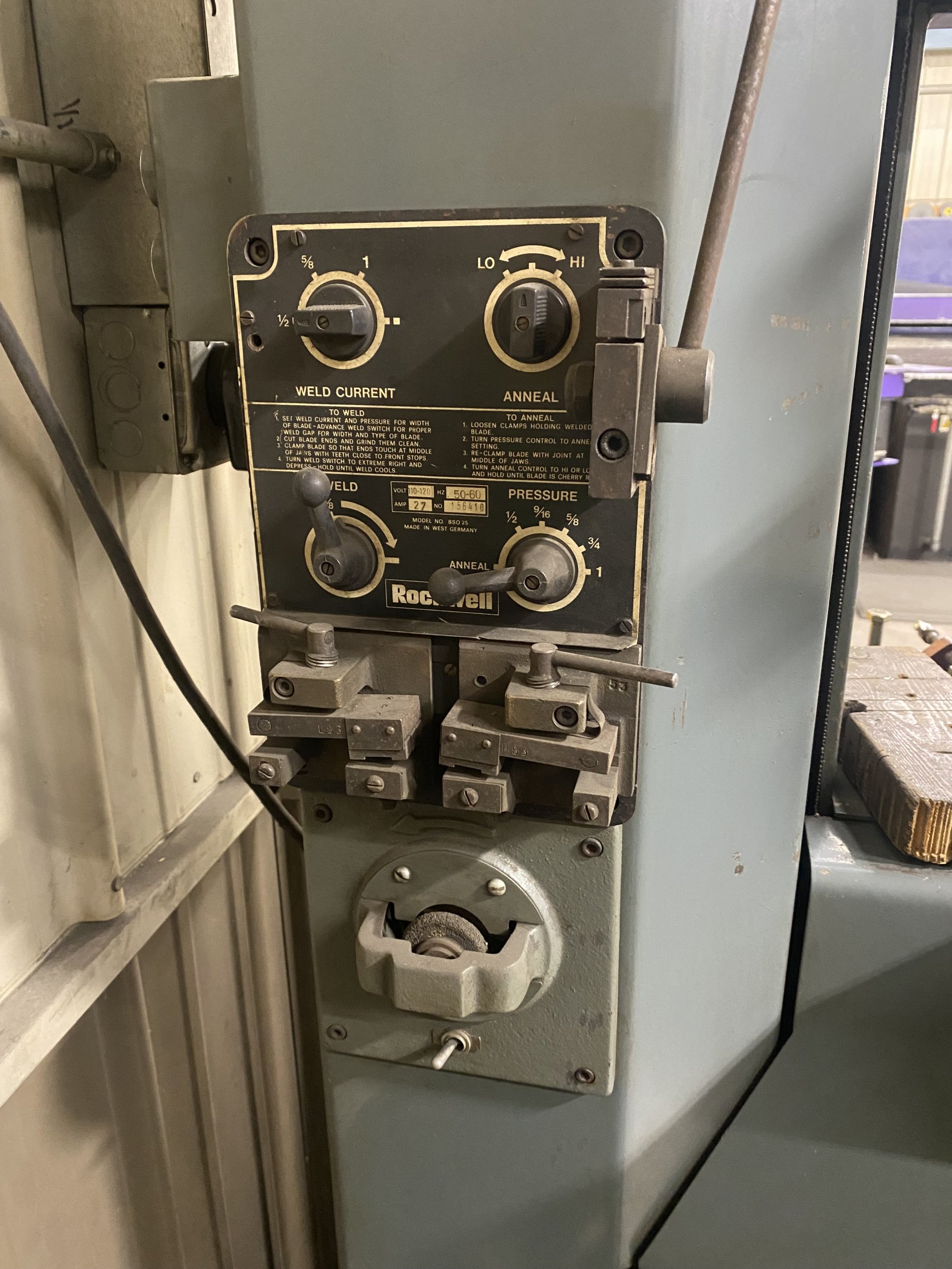

    From our shop saw

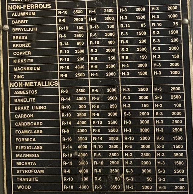

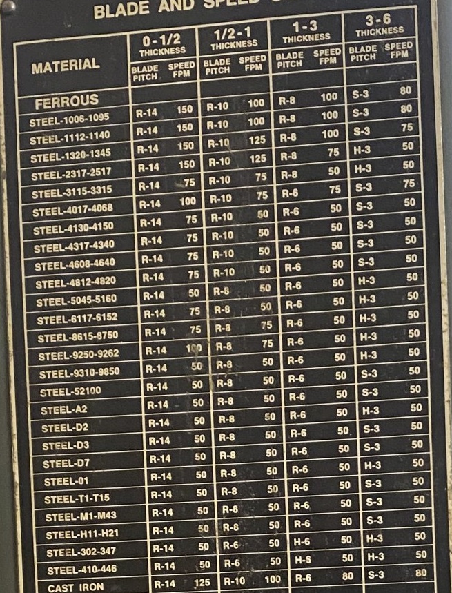

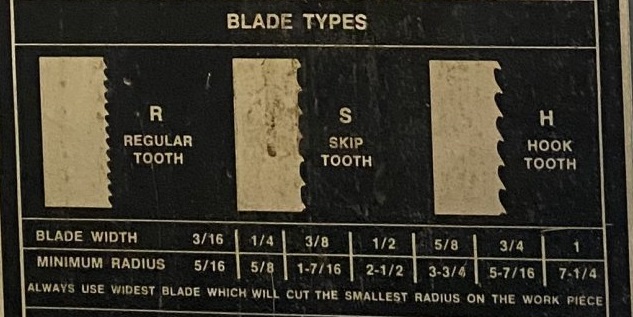

    neat chart! split into smaller photos for easier reading

    Thanks squirrel for the larger pics, those I can read.
