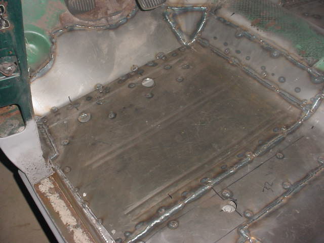

    Just put together my HF bead roller and I think it is gonna be fun! I built a large wheel to replace the crank handle and I can see where the flex is gonna be an issue, I'll have to brace it up but other than that seems like a decent tool. Rolled a bead in a piece of scrap and it seemed to do a decent job.
    Now my question, what gauge material should I use to replace the floors in my shoebox? The roller says it can handle an 18 gauge capacity, would that be sufficient? I would like to go lighter if I could as I don/t really want to max out the tool but dont know if that would be prudent...thanks-
  2. I used 18 gauge in my F-100. But you could probably get away with 20 gauge. I probably wouldn't go much lighter than that for a driver.

    Just used the same tool to do pans for the 39. Use 18 guage. Mine have a bit of "oil can" after the beads were rolled and they are 18 guage. The seat mount stiffening is a must. I test fit my seat stands and with just the floor sheeting, the seat moves around alot. Be sure to brace the
    HF roller, its junk without it on 18 guage. You'll be beading everything thats not nailed down once you get the hang of it!!!

    I kept having that same problem. Then I figured it out. I was tightening the dies down too much and stretching the metal with the flat parts. You can solve this problem by putting very little pressure on the dies. You will find that it still makes beautiful beads and you get a nice straight panel.

    The required amount of pressure is sort of a intuitive type thing. I can't really explain other than to say, if you are warping the panel, there is too much pressure. Do a couple of test pieces and get the feel for it. Tighten one down too much to see what it will do. Barely put any pressure on another and see what that does....
    As far as where the bead starts....Yeah, the middle of the die is the start of the bead.
    As far a guages go...I like 20 ga. but I have used 18 ga. as well. 18 is easier to weld because its a little heavier. 20 ga. is of course lighter and thinner. It goes through the roller easier.
