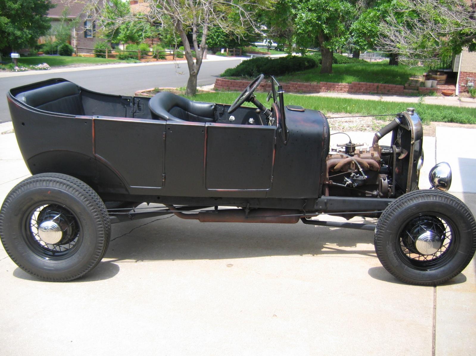

    I have a stock "A" chassis under my 27' Touring. I am going to put a reverse eye spring and a 36' axle under the front to get it down. What is the best or easiest way to lower the rear 3"?

    Assuming those are 16" wheels in the back, I'd say that the easiest way would be to put 10" wheels and tires in the back. ;) :D

    The best way to drop the rear of your car is to put a 3" kick in the frame. if you cut the rails 3 1/2" behind the rear seat riser at a 45 degree angling forward and move the rear section on top of the front section you will get about a 3" drop. The kick will be hidden under the rear seat. By doing this you won't have to modify any other parts.
    Personally I would leave the rear where it is, and just drop the front. They look great with a forwad rake.

    Model T rear spring drops about 3-4 inches depending on which body style A you have. Or in your case T :)
