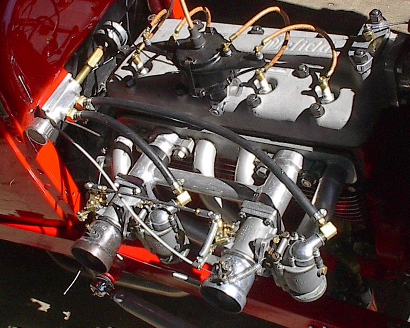

  21. Michael_e
    Joined: Mar 15, 2005
    Posts: 431
    Michael_e
    Just Plain Bill...
    That's one really sweet looking engine ya got there.
    What is that round thing just to the left of the rear 'wing' of the distributor cap? I thought at first it was the coil, but now i'm not so sure.
    Thanks,
    Mike
  22. That is an electric fuel pressure sending unit. After I bought and installed it and when I complained they told me it wouldn't register accurately below 5 lb.
