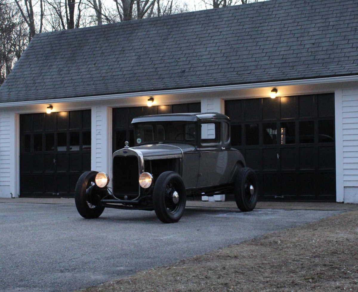

  10. lake_harley
    Joined: Jun 4, 2017
    Posts: 2,484
    lake_harley
    JT1930.....Your garage really says "Hot Rod". What a great looking space, and an upstairs to boot!
    Lynn

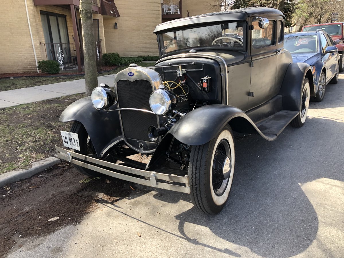

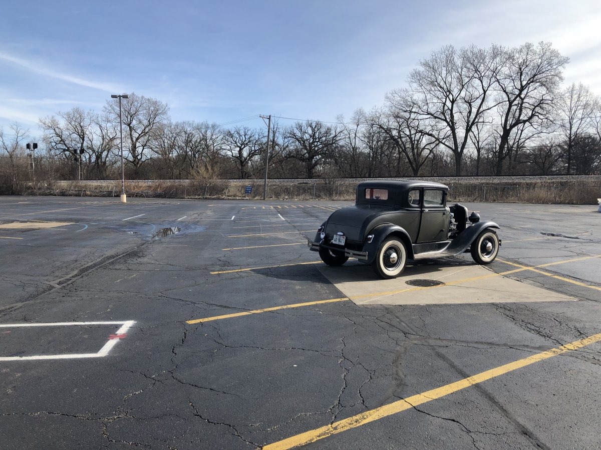

  11. Johnny Nitro
    Joined: Sep 28, 2005
    Posts: 100
    Johnny Nitro
    from Chicago
    Have her out-n-about! After 5 years. Now, working out all the bugs, leaks, and rattles. Thanks to all for the wisdom, and knowledge on this board. You guys kept me going.

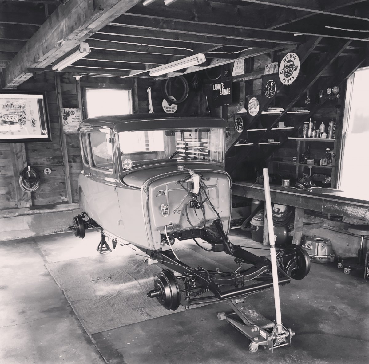

  14. JT1930
    Joined: Jul 1, 2018
    Posts: 220
    JT1930

  23. @JT1930, are you sayin the b+w shot is from '61, or the garage was built then ?
    I'm confused, typically.
    Art
    JT1930 likes this.

  25. JT1930
    Joined: Jul 1, 2018
    Posts: 220
    JT1930
    @Shutter Speed the garage was built in 1961.
    That would be really cool if it was a shot from the 50/60s
