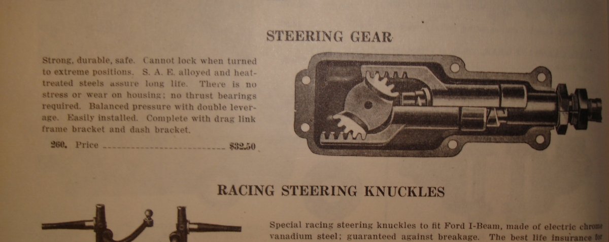

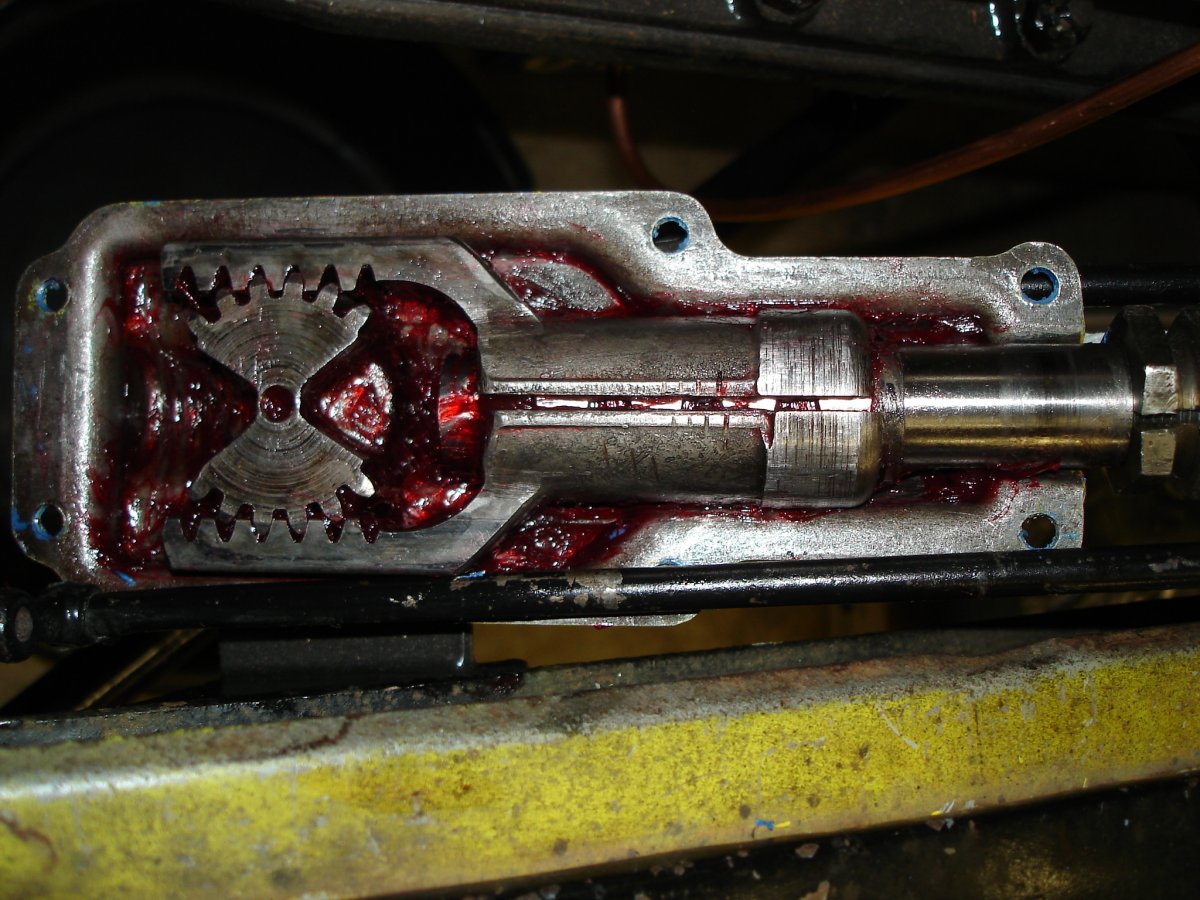

    There is a real deal T accessory steering gear on the MTFCA site, where you posted your ad. It's a "Recording Devices Balanced Pressure Steering Gear". Here's a pic of the one in my Mercury Speedster fullsizeoutput_11f.jpeg

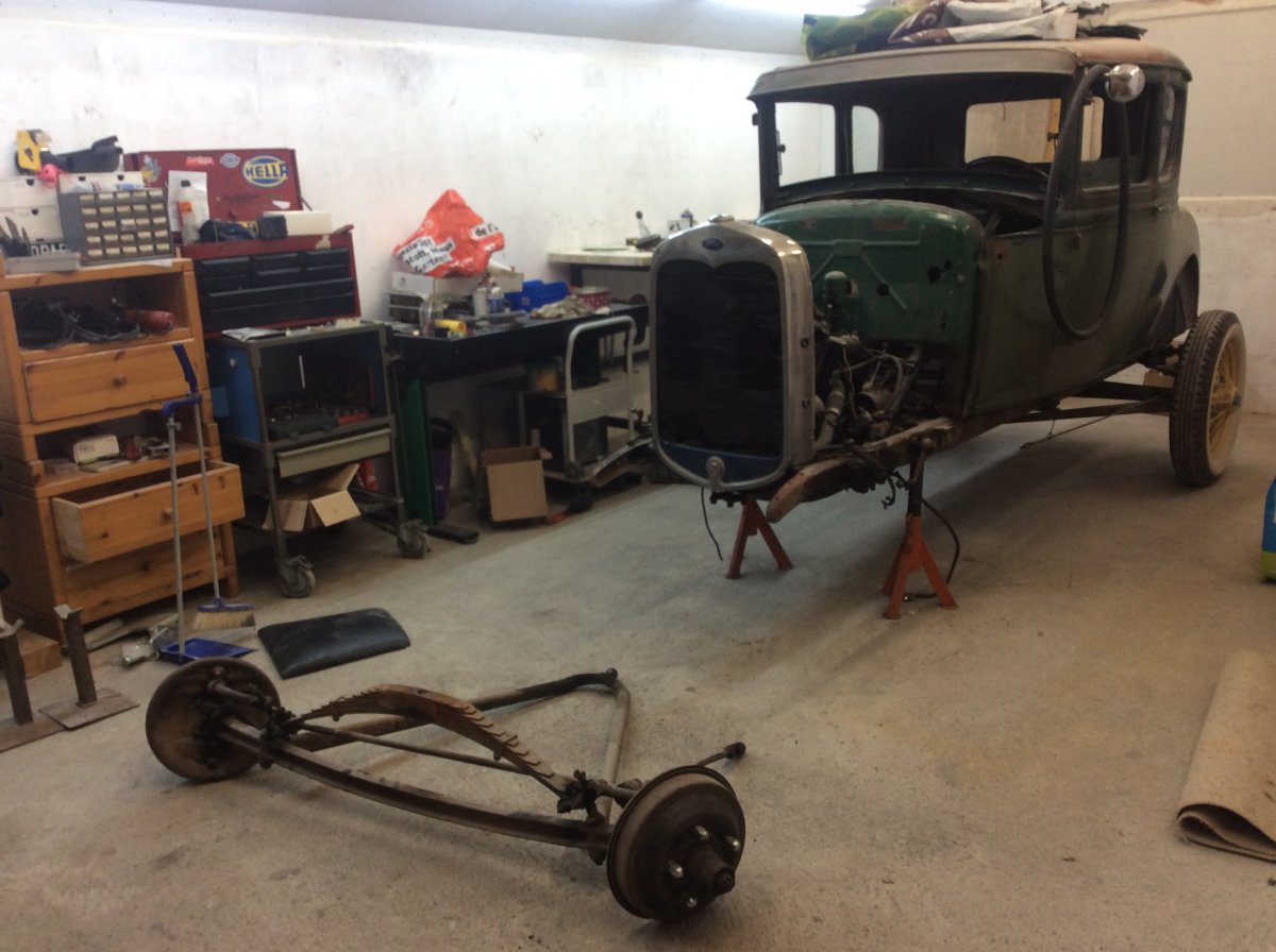

  2. Checking in for the first time, after having the A in storage, life getting in the way, making the garage usable. I have made a start!!!!

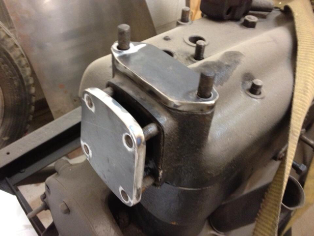

    Lynn, I’d have the block pressuretested. Making a couple of flanges for in and out lets is easy, I just use tap water pressure- showed my “head gasket eating” (or so I thought) B block to be cracked. :-(

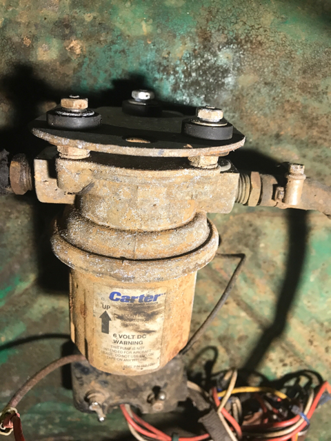

    I’m running this Carter 6 volt pump, but just meassured it to put out 8,5 psi (0,6 kp/cm2), so looking for a new setup. Are there any good adjustable 6 volt pumps on the market?

    I would just put put a pressure regulator between the pump and the carb. They aren't very expensive through jegs or summit or speedway. Would be cheaper than a new pump. I know you are on Europe so it might be a wait. I got my malipasi piece from a place in England. Units without the filter were available too and were less than the filter ones. In the US most auto parts have cheaper ones also.

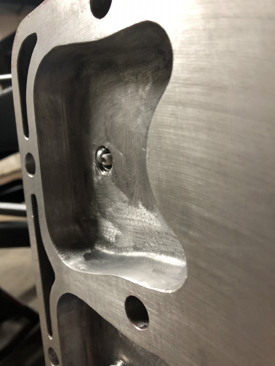

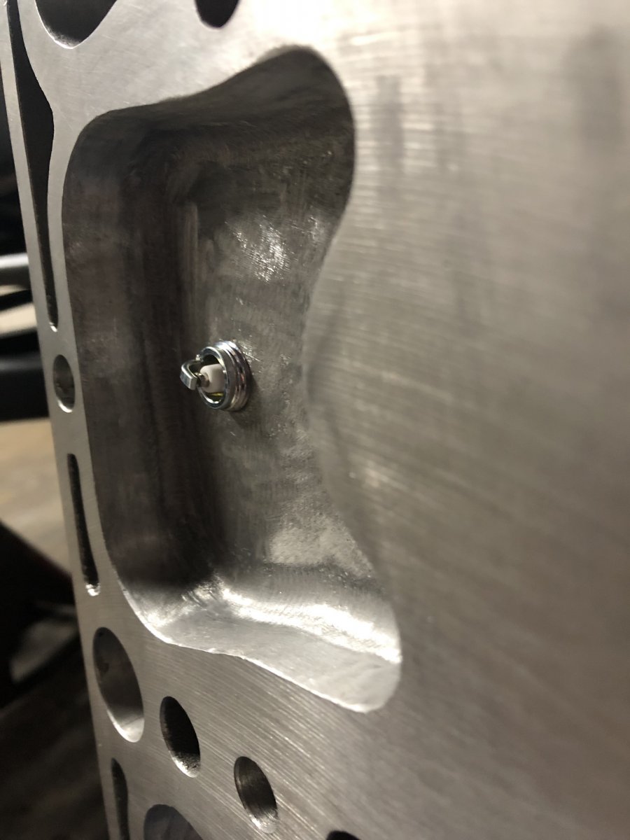

    Gents. On my Winfield 6.1 head I’ve been told to run either the ngk bp6hs 1/2” reach(first picture) or the ngk bp6es 3/4” reach(second picture). The 3/4” are too long and the 1/2” look too short.
    What do you guys run in these heads. Can I get shims for the 3/4” or are the 1/2” good?

    short reach
    JT1930 likes this.
  12. Both plugs will work
    If you can find some Plug indexing washers you can run the 3/4"easily
    The 1/2" looks too short, could also have the plug recess machined down some.

    I would clay top it to be sure .

    I used the longer reach Ngk and made some copper washers to index to the correct height

    I don't have the racing experience John has but every book I have read says no threads exposed in the combustion chamber. If you can get the right reach plug in a heat range you want I would use the long ones with spacers as has been suggested.

    Copper plug indexing washers come in a couple different thicknesses and I have used them stacked to get an odd plug to project properly. Check good old Speedway motors, usually a bag assortment is available.
    On some old Briggs alky motors, the plug liked to be pointing electrode towards ex valve to burn on intake side before ex valve opening. Big difference over 5k revs.

    I got a set of Moroso spacers coming. I’ll get it worked out. Thanks hambers

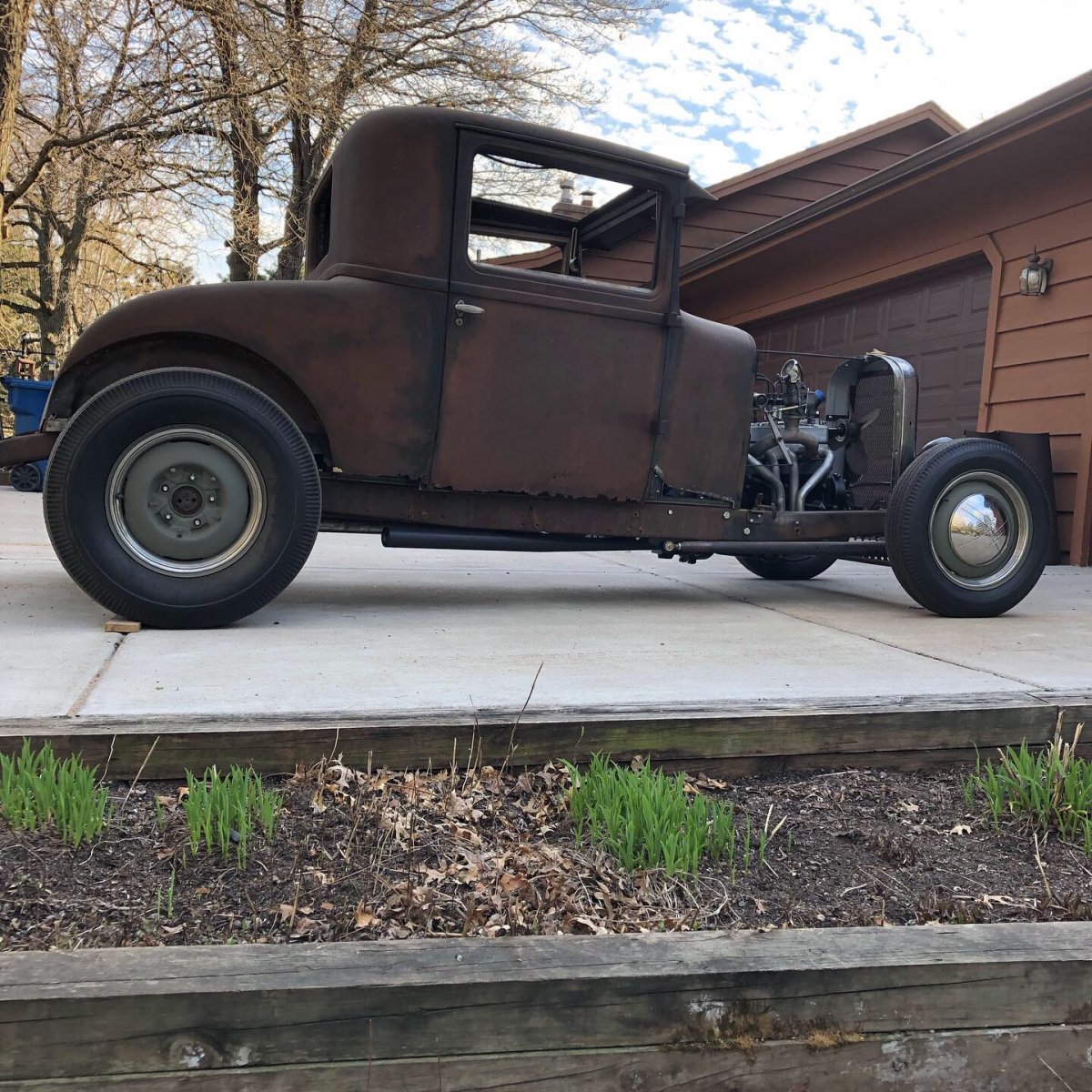

    checking in for the month getting closer run some wires,run a fuel line and finish brakes should be running soon

    Same head, doing the same with spacers on 3/4" plugs. Any recommendations on where the electrode should be facing? Might as well index them since I have to use spacers.

    Mine protruded with the 3/4 plug, no threads,just that 'shoulder' with a crush washer on plug. Did you measure piston protrusion?you might need to relieve the head

    @railcarmover piston does come out of the hole a little but that’s all taken care of with the right head gasket. Even if I were to relive the head that will not solve the spark plug issue. This is a repop head so I don’t expect it to be like the originals. The 3/4 plugs go too far in for my liking. Spacing them out will get the right protrusion.
    @MJW ideally you want the gap side of the plug facing your intake valve. (Ground strap end pointing at intake valve)

    what kinda coupe ? ………………….. steve
