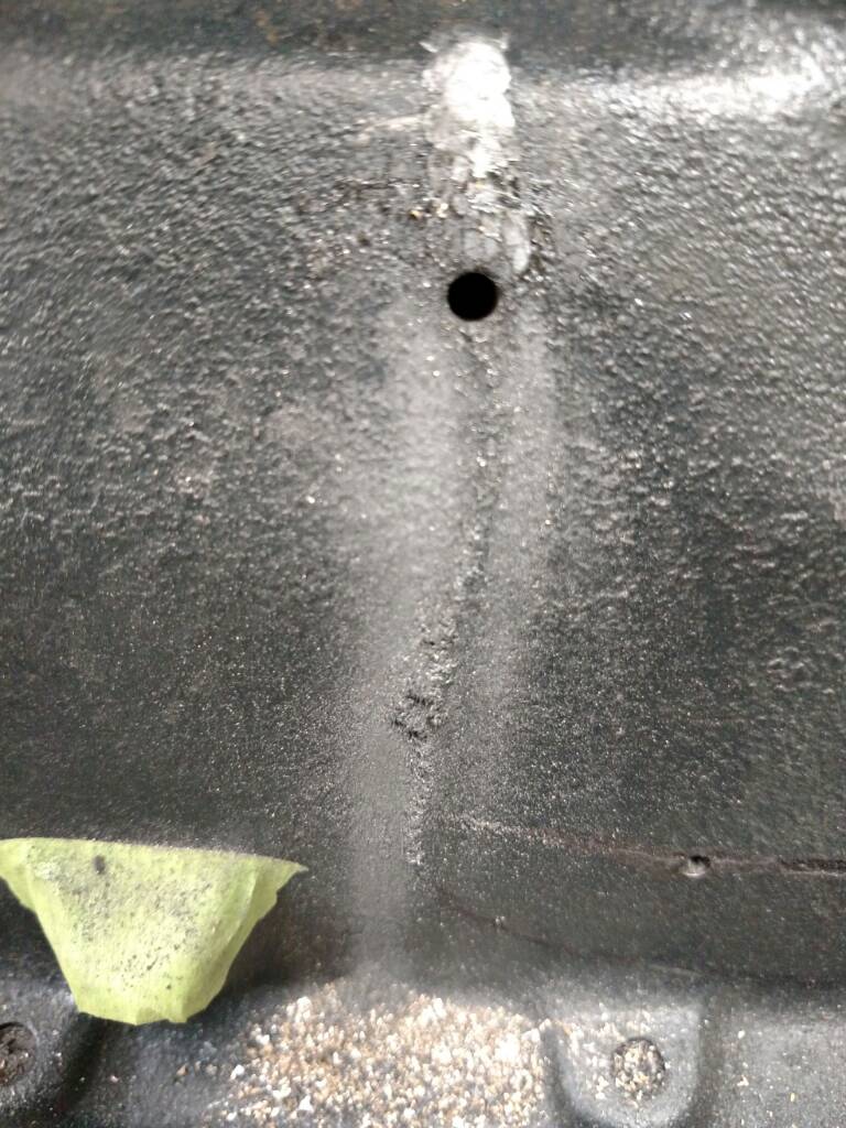

    No, another engine, it is a B that I built with .040 over 392 Hemi pistons that come .086 above the deck, inserted also. It is a total of
    .140 over. It was in the Cabriolet last time it was at Hill Climb. Smoothest engine I've ever had. The block was brazed from the backside for a repair by a previous owner. It looked OK but it leaks oil...all over. I'm thinking this might be a candidate for another OHV conversion...first things first, crack repair then figuring out if the pistons will work with the head. Then there is getting a head gasket that has a fire ring that doesn't hang into the cylinder. Banger power...the most money that can be spent to go slow. It's an addiction...but I don't smoke or drink.

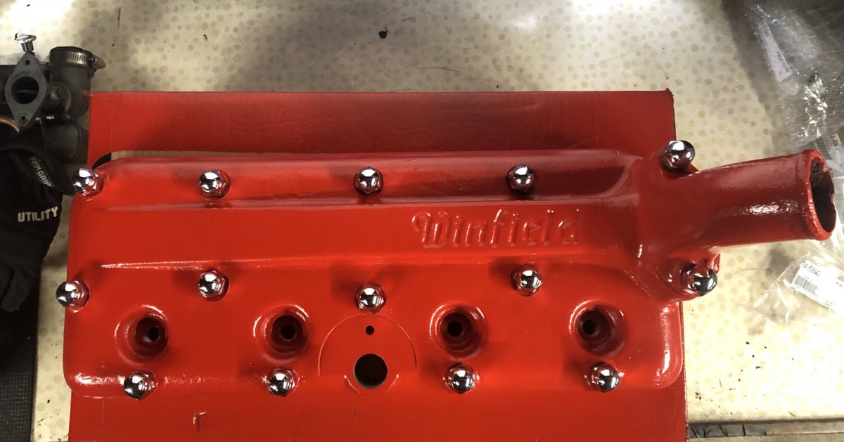

    B50301E6-A21A-4DA5-8E2E-4AB7953F41AF.jpeg @railcarmover Now you got me thinking hahaha but also could be more meat where you thread your plug into outside of the chamber. Mine are sunk in looking from the top.

    nice head ……..….

    I dont know a thing about casting and foundry work could the mold have been changed? maybe.Logic says any deviation comes with machining..

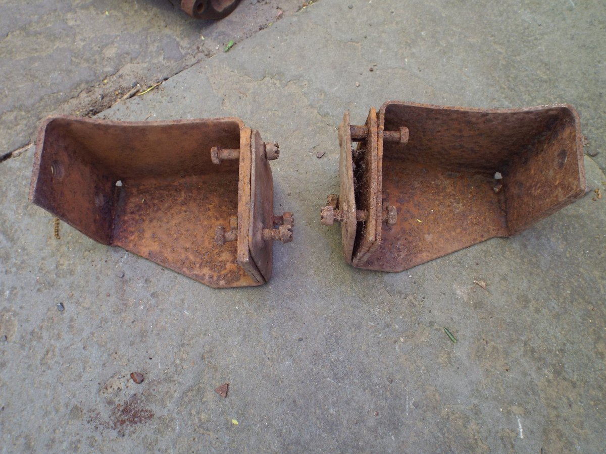

    DSCF0862.JPG Are these rear motor mounts early AR or AA Truck items? They have the early forged outer plates. Thanks! Bob

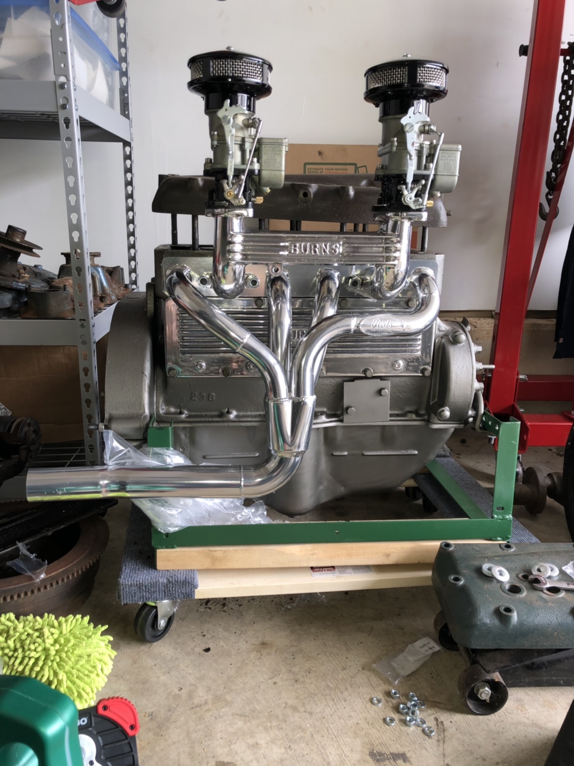

    Getting ready, finally, for my rebuilt diamond block. Mocked my bling up on a spare motor. Thinking of a copper coil from the B fuel pump to the strombergs. Still not set on 81s or 97s. 1.5 intakes and winfield grind cam.[​IMG]
    Tim, Dannerr, winduptoy and 5 others like this.
