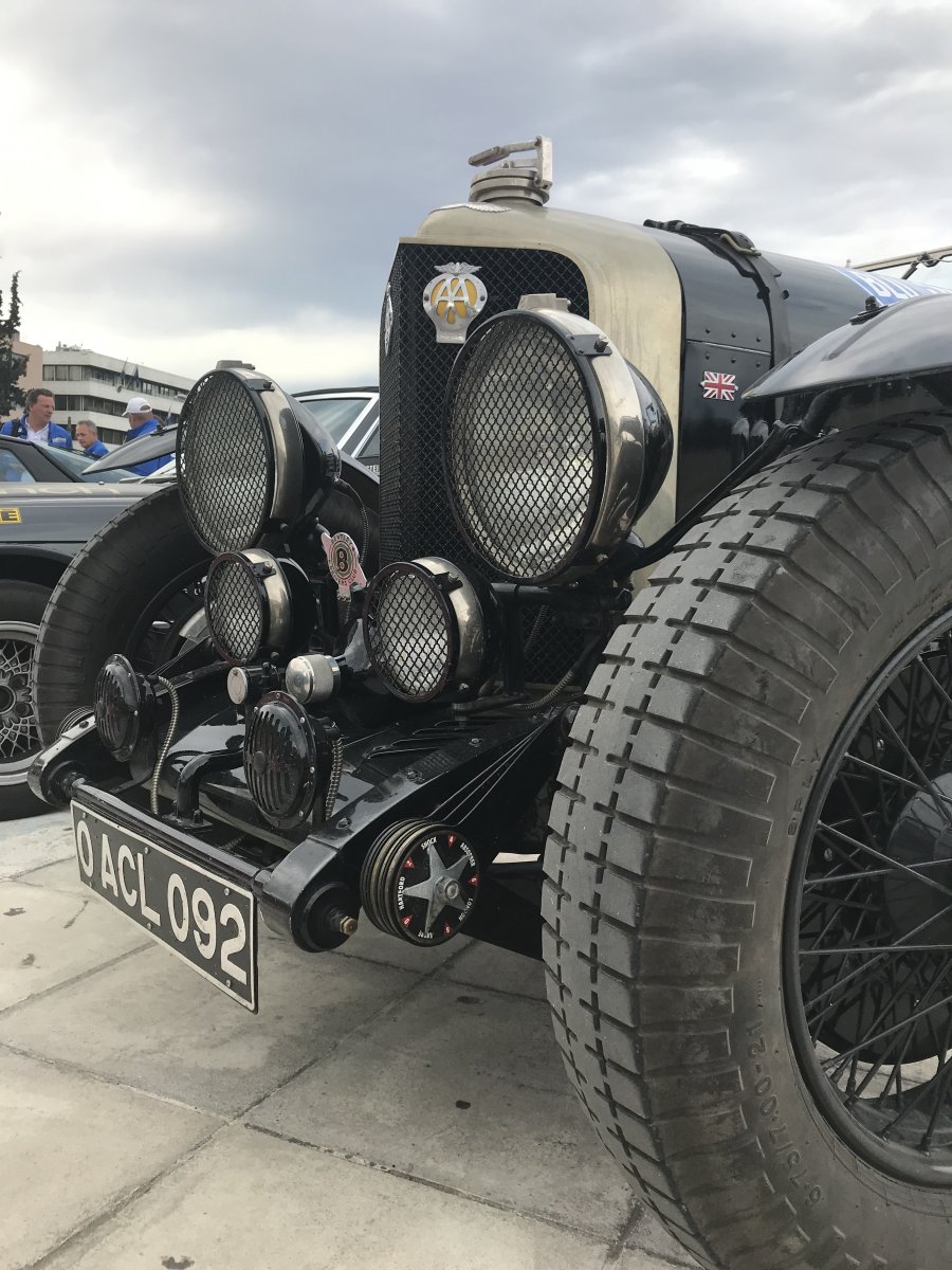

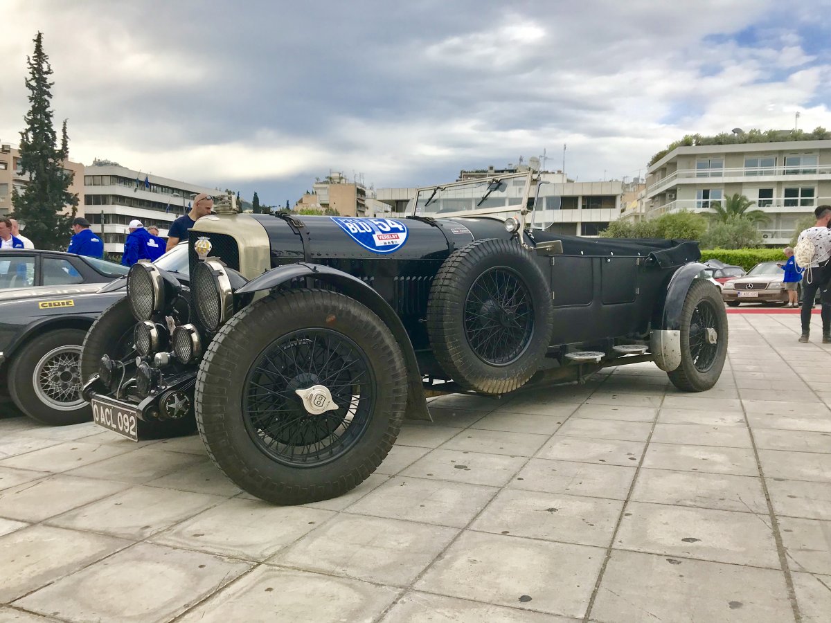

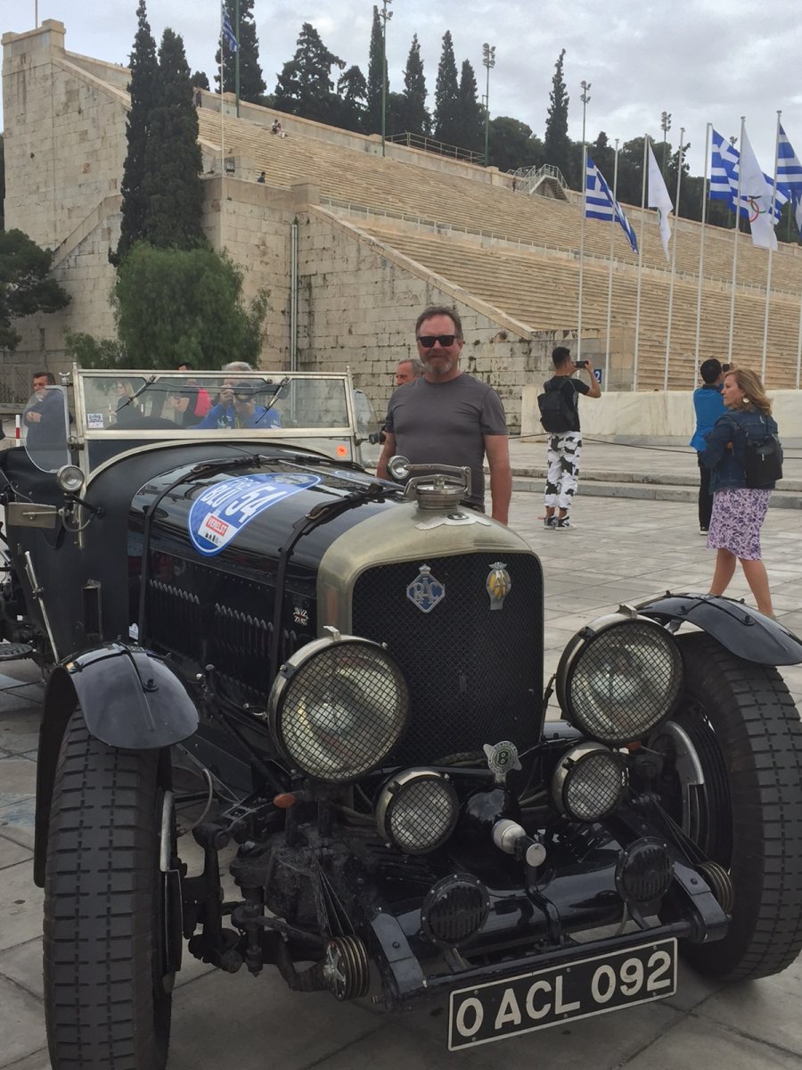

    Traveling last week, stumbled onto a king-sized banger! Unfortunately they didn't open the hood while I was there... 908885F8-F080-4C2B-8CD2-EFFC85C28D56.jpeg B8474E00-A5CE-463F-8F73-8B5D2ACEAFE2.jpeg

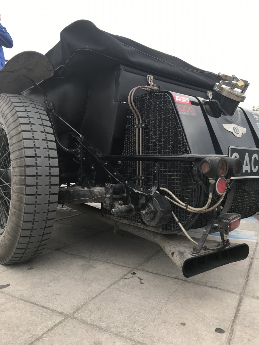

    4C4BAAD2-BFF7-40C3-8F95-CC80377FE7CE.jpeg 421F3C21-E292-4492-8B31-6914832C2754.jpeg Thing is built like a tank!

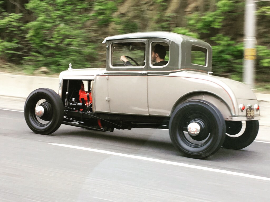

    Well HAMB’ers I swapped the Winfield head off for the stock head. Started right up. The f150 trans is awesome. 60-63 mph on the highway today. Round trip about 100ish miles.

    good looking car , glad its running

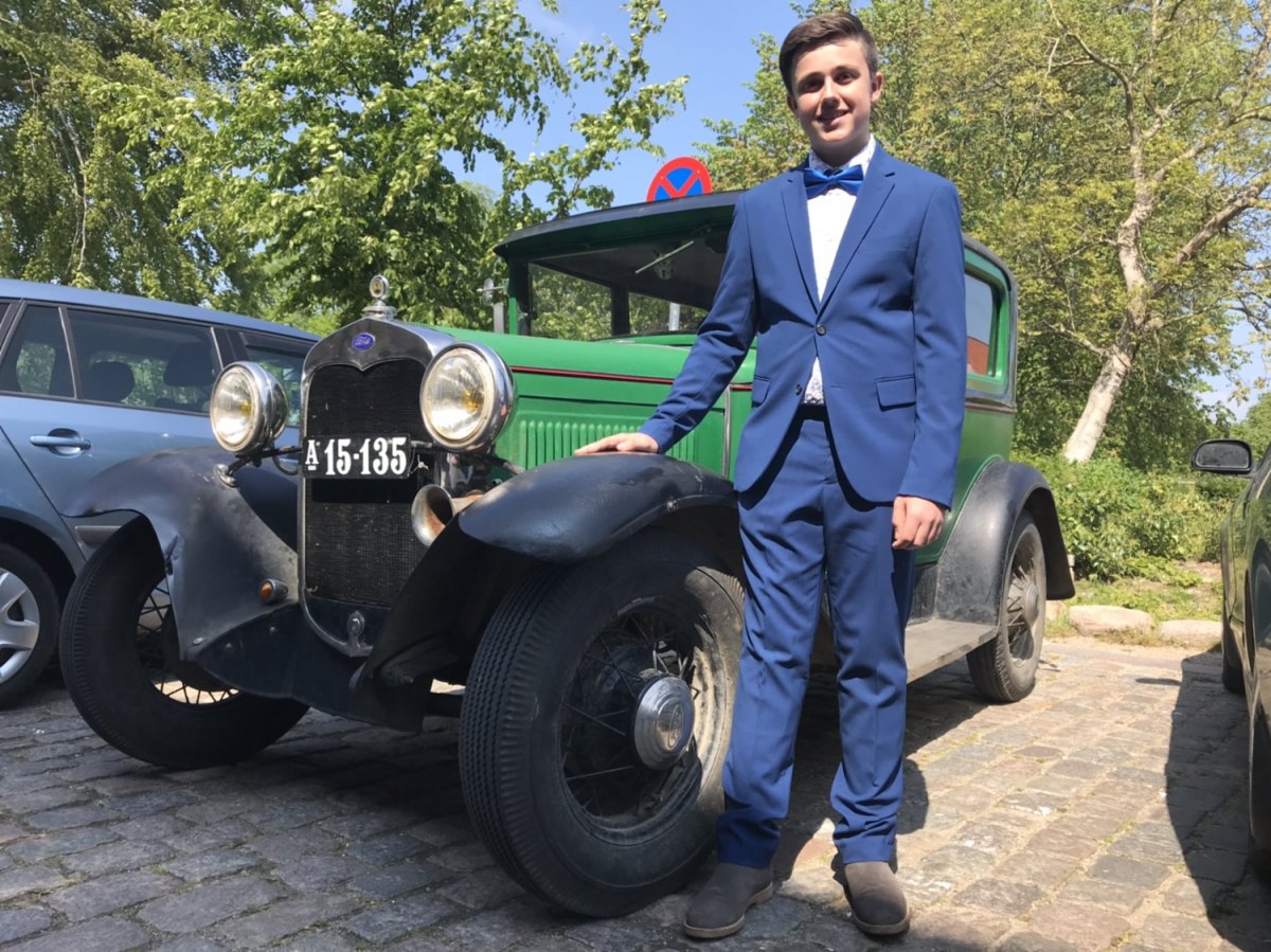

  21. Thanx, @Binger.
    And so I did. I knew, I was in the 11th hour, not having any time being a new dad, but this went way out of control!
    I went to ebay, to find a decent one, and went with the Holley 12-804, going for $32. But shipping would be after the weekend, so I phoned the local US-parts dealers, and the two, who had them, had them priced at $82. [emoji21] Looking into finding another pump, with no succes, time kept ticking, and I was as late as 3 days before take-off, before I decided to pick the overpriced one up. But that don’t come with plugs and nipples, which I normally can make at work, but with no time left, I had to pay for those too. Totalling- hold on to your hats, gents- $167! [emoji37]
    So, this past friday I set out for the just shy of 4 hour trip, to be at my little brothers confirmation the next day. And car ran great!
    Below are pictures from his big day; at the church, when we stopped by Hunseby Strand (beach) and Bandholm Elektricitetsværk (power staion), one of the kuulest could-be-a-great-garage-buildings in the (my, at least) world, where I played alot as a kid.
    Thanks again for your inputs, @Binger, they are highly appriciated!
    Keep ‘em kruzin!

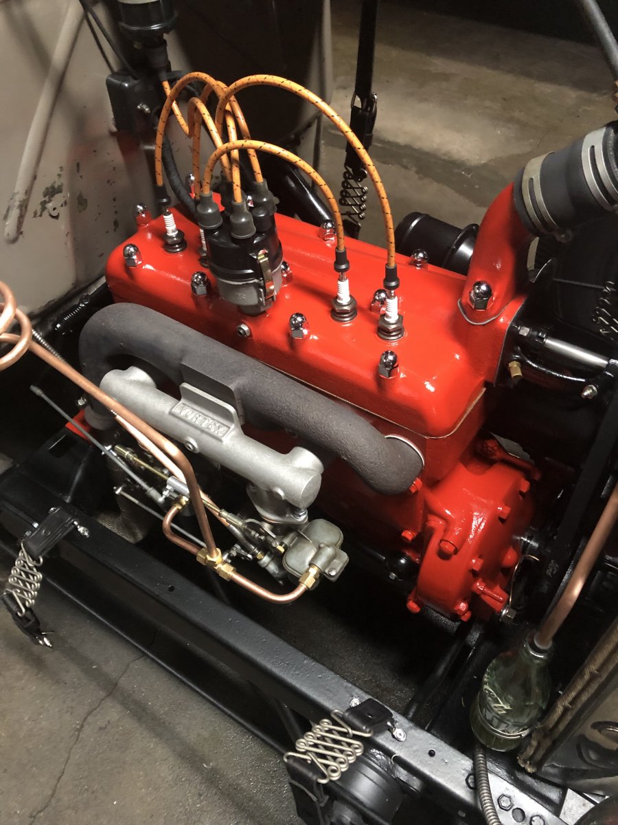

    453944B4-FEEC-4C59-A5D9-E49EE690050B.jpeg @railcarmover at the moment stock head. I’m going to get the head relieved a little. See if that helps with starting.

    Glad you got your car running well. Looks like a great day and a nice trip.

    The distance between the top of the piston at TDC and the combustion chamber is called the quench. Ideal quench is .040 .To figure quench you need to know piston protrusion,how much the piston sticks out of the block at TDC and factor head gasket 'crushed'.Generally fly cutting piston reliefs in the head equal to the piston protrusion from the deck yields a quench of head gasket crush..about .050

    With the model b premium gasket from Snyder’s I had a little over .050 of clearance. We’re going to be putting in the Bridgeport and milling it’s a bit. The motor spun by hand so the piston was no where near the head to stop it.

    If you didnt hit the head its doubtful that raw compression is causing your starter drag...the fly cut for piston relief doesn't drop the compression that much.

    This is true, 6v starter still starts my 8:1. It's slow(er) but it starts fine even down in the 30's. I would check brushes/ bushings, brush connectors, etc.
    -slightly bent shaft caused me grief on an old Chevy once, it would spin fine outside but not when engaged in the ring gear. Just my 2-1/2¢
