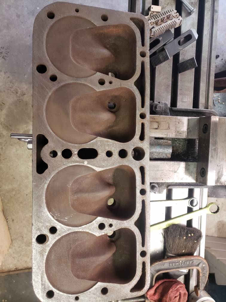

  2. If you find yourself more in love with that 6-1 head, Ill buy the lion3 off of you ;)

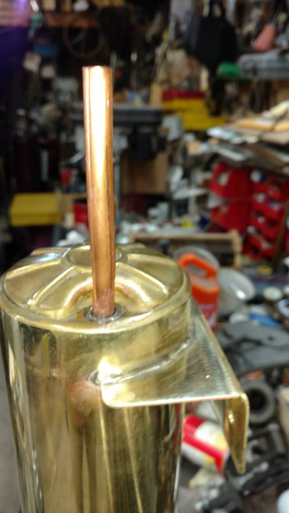

    Bent, soldered brackets and overflow tube on a fire extinguisher overflow today. Cleaned it up and now for clear coat IMG_20200505_150911096.jpeg IMG_20200505_160418392.jpeg IMG_20200505_170511301.jpeg

    ^^^5 hp increase in shine alone^^^

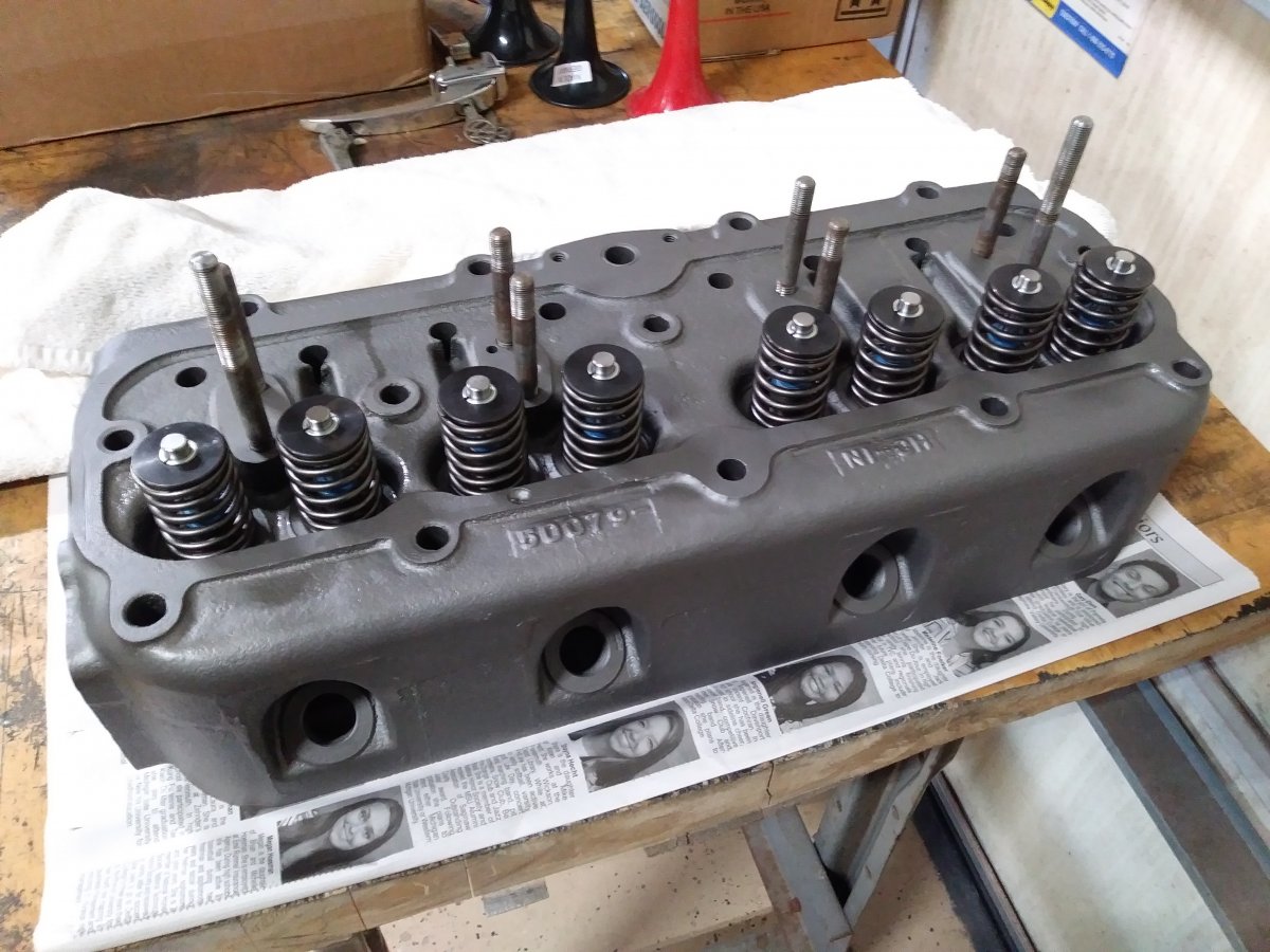

    Checking in... OHV head rebuilt, custom milled valves.
    Just waiting on rocker rebuild, then custom pushrods, then we'll get her running again.
    chryslerfan55, poshdbs, burl and 4 others like this.

    Ill play. Check out this head i found. Just put it on my A along with a dual updraft vortex intake and 2 zenith-2s. Runs like a ****d ape now. Car already had a touring cam. Its .200 taller than a stock a head, so i had to make a custom distributor shaft. Also uses champion #7 plugs. 20200412_145546.jpeg 20200412_145620.jpeg 20200412_145626.jpeg 20200412_145648.jpeg IMG_20200422_141911_914.jpeg

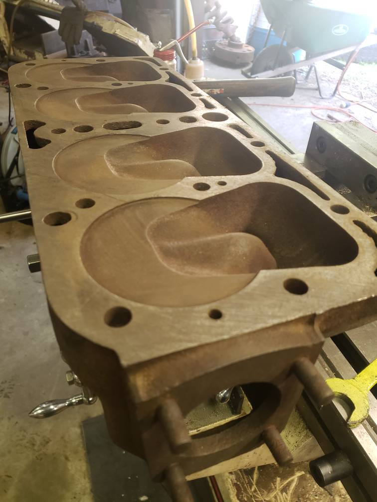

    I found an old Gemsa Morales casting that was never finished.
    Put guides and seats in this week. Not sure what it will finish as, thinking SOHC.
    chryslerfan55, GuyW, Jet96 and 6 others like this.

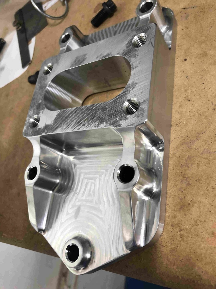

    I don't know for sure, I have a friend who is putting two of them on a blown flathead V8. I made an adaptor to go from a Fraser manifold to a Scott blower.

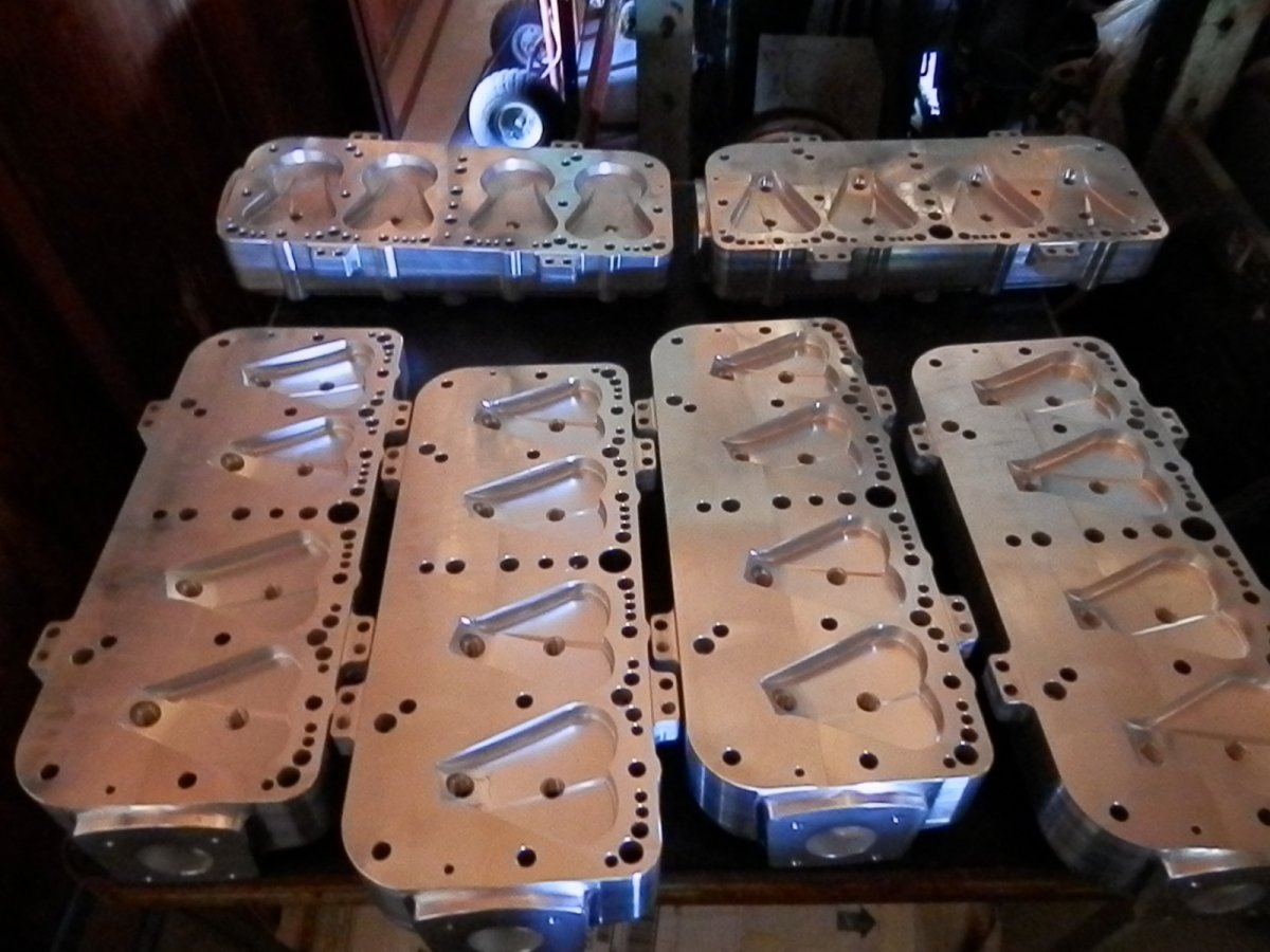

    More Banger heads to chew on " look closely there are three different heads "
    Regular Head
    Dome Piston Head
    Reverse Flow Head
    Jet96, Old Dawg, burl and 3 others like this.

  27. 97
    Joined: May 18, 2005
    Posts: 1,983
    97
    So are you going to tell us , or is it a puzzle for us to solve?:D
    Who makes these heads? Do they come as blanks for you to machine or are they custom made to order?
    The high dome head is obvious , and from what I can see the two outside heads in the front row are the reverse flow heads?, it is kind of hard to tell which way the ramp goes in some of the pics, I guess due to lighting/reflections, or it may just be my eyes!
    The extra coolant p***ages are interesting , is the coolant cavity modified as well? Can we see the rest of the reverse flow block and porting and the high dome pistons in and out of the block, or is it area 57 material? Who grinds the reverse flow cams and what firing order do you use?
    I note that you have cast in extra clamping lugs , what do they tie into ? girdle ?

    The heads were machined from 6061 by Pat Gary in Paso Robles CA , they are no loinger available. The lugs on the side of the head were for mounting the billet in the CNC machine . The holes for cooling actually line up with the holes in the block , Crane grinds the reverse cams the firing order is standard 1 - 2 - 4 - 3
