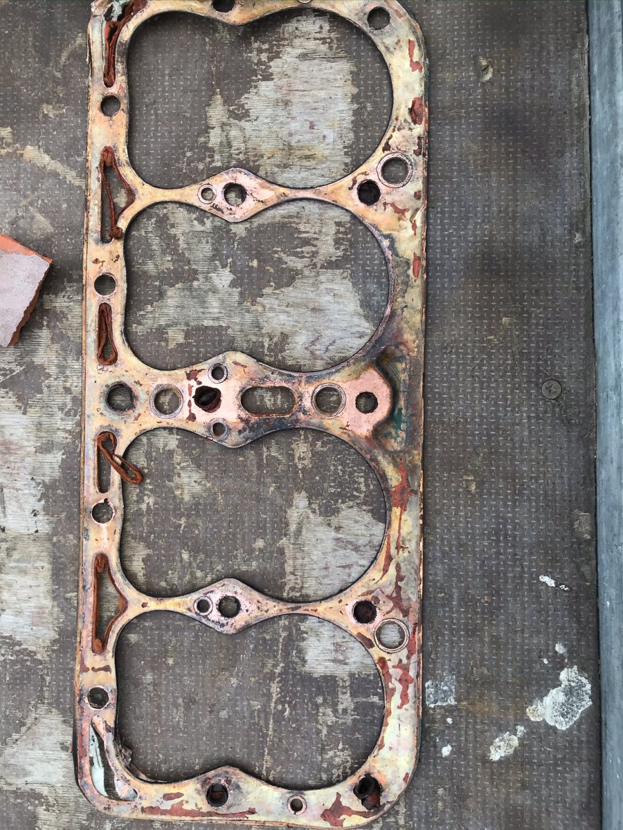

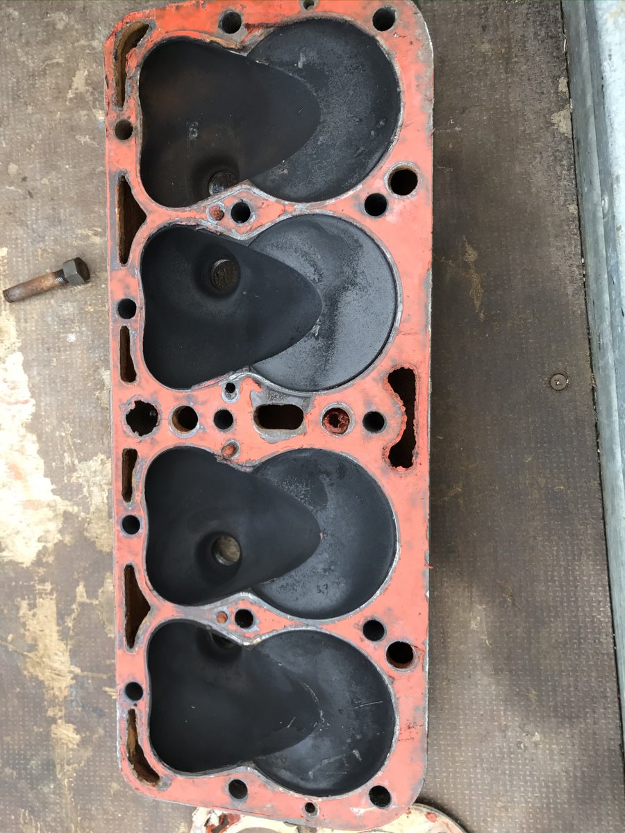

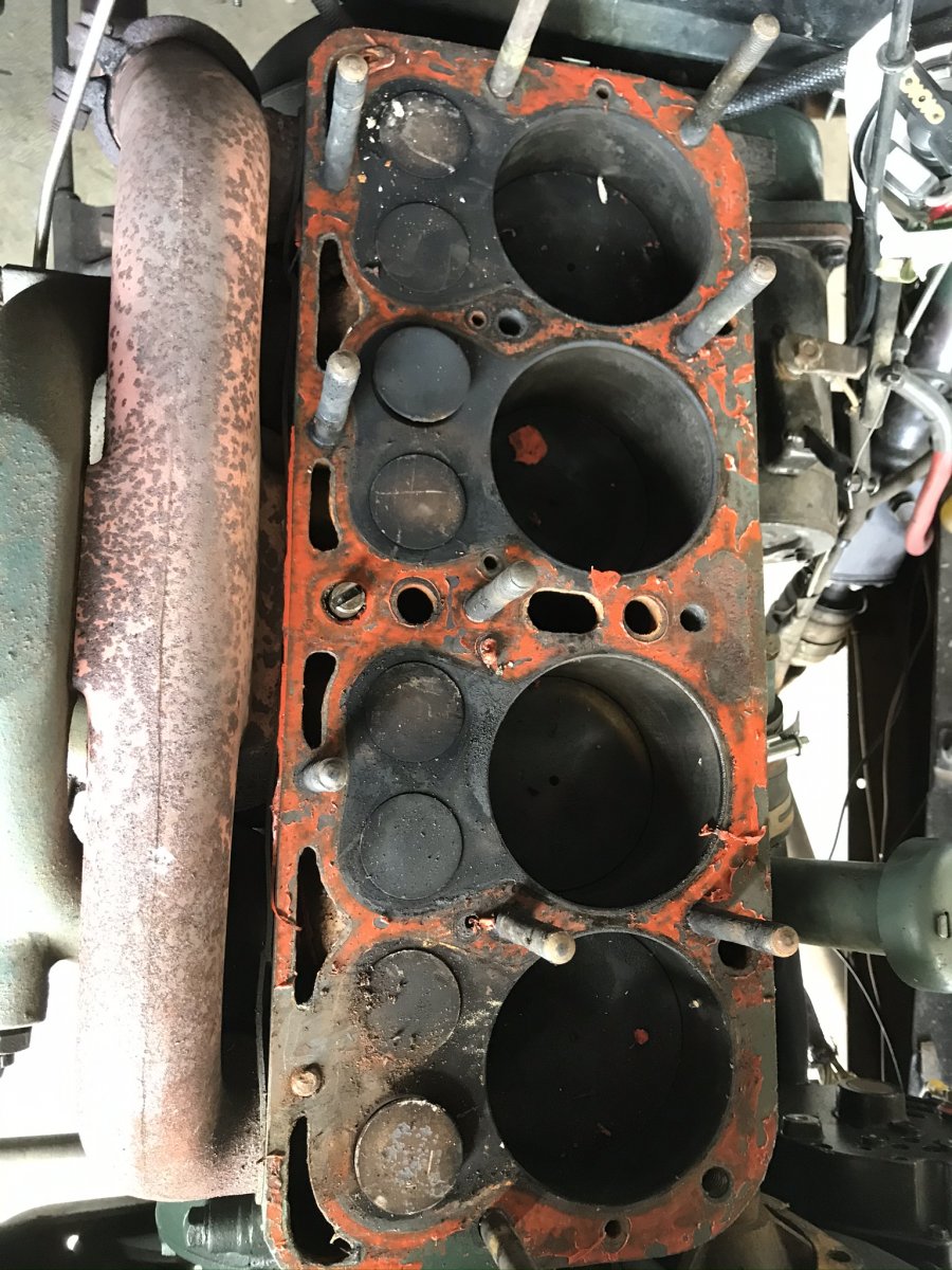

    Red snot everywhere. Driving to town and just got 1/2 mile from home on a cold motor ,next thing just nudging 60mph the windscreen got covered in water as the original radiator cap on the 32 disappeared in the bushes/gr*** never to be seen again. Came home filled it up , as soon as we get to 45 mph water tries to escape the cap . Gave it the TeKay gas in the radiator test and it came back positive.
    Its never overheated , grabbed my IR thermometer and got the motor as hot as I could and it was just 83 on the top tank and 76 on the bottom .
    Popped the head off and yikes red snot slathered everywhere, blocked steam holes , traces in the combustion chamber. Could not easily see a blown gasket or any block cracks. BFA3BD67-3480-4F09-938D-60903826CE86.jpeg 1BFB4DDD-20DA-4A29-BD5D-A03E4D7F9089.jpeg 1833C379-001D-48EB-B5A2-5AA30C7234DE.jpeg

    Red silicone on a head gasket ...nice before going too far Id clean and straight edge the deck and head,hope that snot isnt a "leveling course"

    Who knows what the PO thought . Have not checked block as yet. But head has gone to machine shop for a check and clean. Some slight pitting on deck between 2 and 3 where the elliptical hole in head is. Will check block this AM

    Checked my block for straight as in above posting. I could see a little light under the straight edge , but the only feeler gauge I had that would go under was metric .050 mm , google says .00196 or somewhere there .
  7. Well you look like you have some work to do.
    Both 1 and 2 are leaking into the water, 1 by ex valve and 2 towards the center of head and block..
    If your straight edge test is even half way accurate the block needs to be trued.
    Getting that stud out may be a *****, you can probably weld a nut to it and pull it out.
    If not and you helicoil it, do not drill thru to the water jacket, that just causes problems.
    That's a nice "B" block, do what you can to save it.

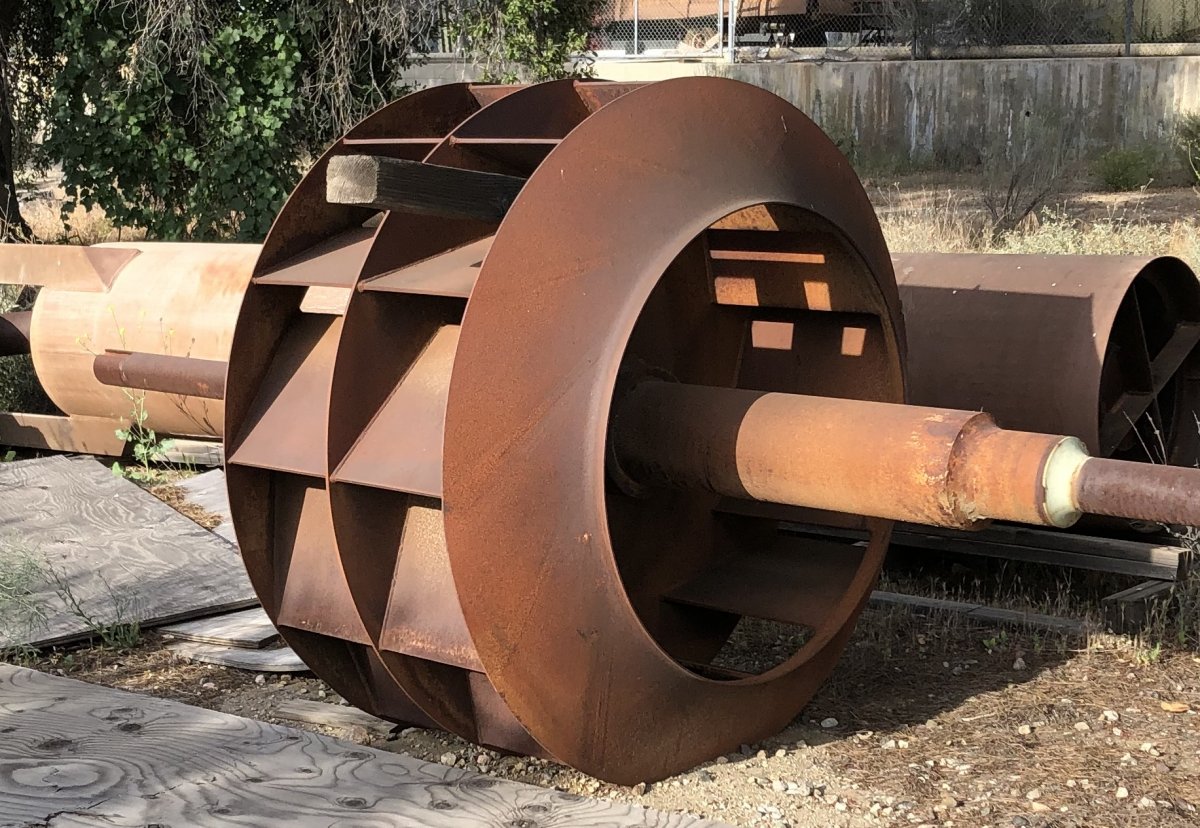

  12. Not really 4 banger, I found a new impeller for the dyno.

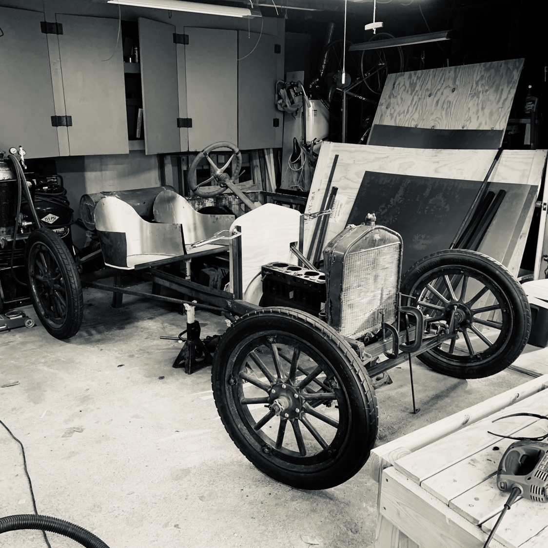

  15. Got to sit in my speedster this evening. Seats mocked up. Felt nice.

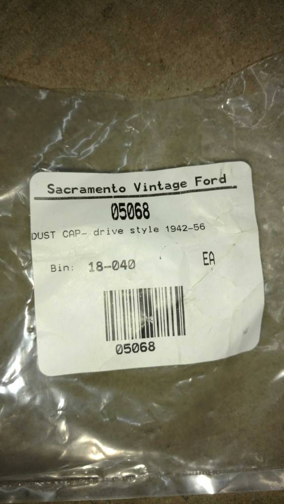

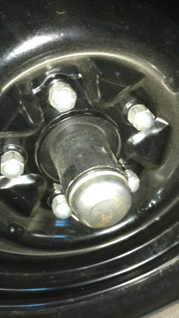

    Thanks for that. I had them in stock. I hauled that old 53 carc*** home in the early 70's and as far as I can remember this is the first time I've used anything from it, haha.
    Found a ball in my inventory about the right size and raised the worst of the dents. These poor dust caps had lived a hard life. Surprised me how strong the steel is compared to the modern soft dust caps. 20200515_192015 (Small).jpg

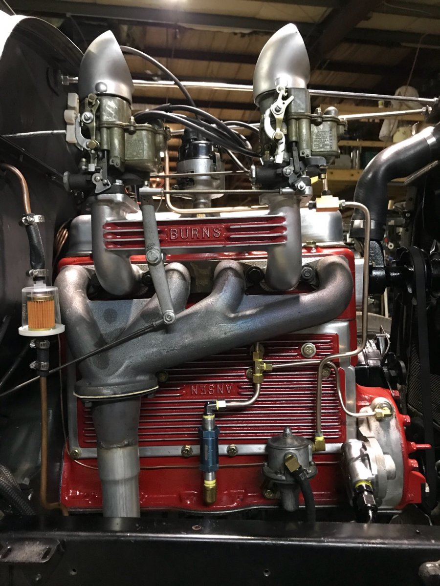

    Anyone recognize this exhaust manifold/header?

  19. Looks like one that Tod ****ermore (427designer) did recently.

    Moonlight,
    Clean looking setup.
    Would you mind explaining the oil flow as it goes through the external hard lines?
    Also:
    What is the blue inline device?
    Is there a remote oil filter after the timing cover? If so, where is the filtered oil being sent to?

    ***** bummer ! i use copper coat on both side of head gasket , twice !!!

    *** nice motor . some aftermarket cast iron header . also i know a good plummer

    That's a great picture,
    helps me understand how to rout a pressure relief valve.Thanks

    Blue device looks like a pressure relief valve but I hope he explains whats going on
  25. The Blue device looks like a check valve and possibly a pill restricted output.
    The filter mount looks to have two lines going back under the firewall.
    I would guess an external pump not seen? or not finished

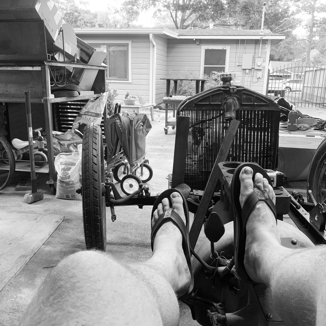

  26. Bit of firewall and steering brace work. Trying to figure out a clean way to keep the steering column from “wiggling”. Thinking of 2 sets of triangulation. One set under the hood, from the top of the cowl to the frame and secured. The second, being the floor board angle and mouthing. Nice to be able to pop out to the shop after work, instead of a 90 minute drive in traffic.

    I think the oil pump is mounted on the side of the timing cover (in place of the inspection cover) driven off of the cam gear.

    Doesn't look to me like there's room in that cover for a gear to run on the cam gear. Looks like the whole thing is behind the cam gear.

    Snyder/ ****ermore header

    Like railcar said Snyders sells that style header but Duke Hallock designed that and sold them back in the late 30's or early 40's.
