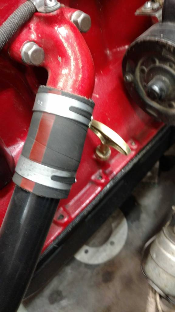

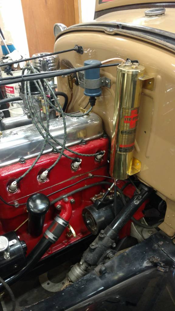

    Got the overflow tank finished and mounted on the firewall
    I used the pump handle on the dip stick. It will be easy to change sticks if I decide I don't like it. If the crankcase pressure blows it out, I've got problems.... 1590175713424.jpeg 1590175941472.jpeg

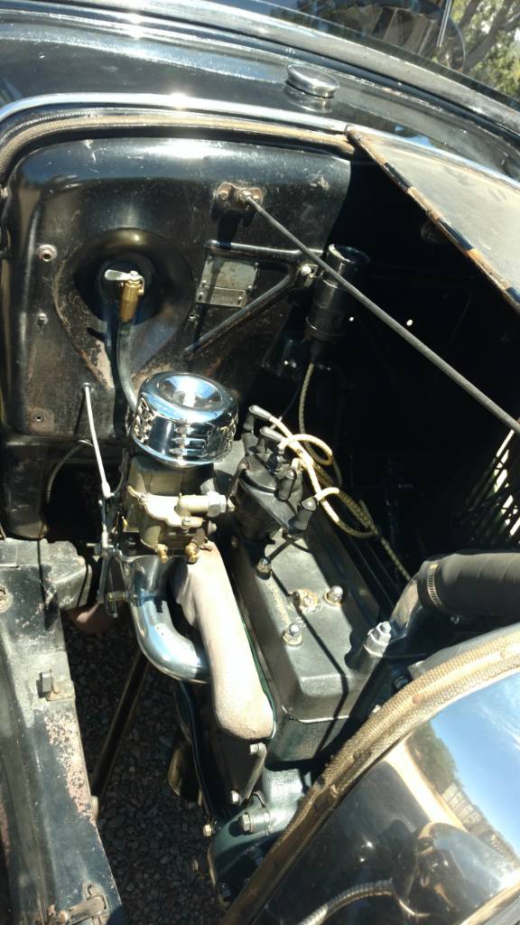

    I finally got smart and made it gravity feed. A larger 3/8" tank outlet to a banjo fitting on the carb.... IMG_20200522_134324303.jpeg
