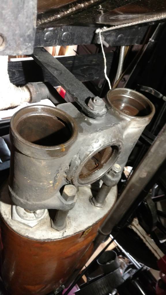

    Went sideways today... I worked on a two cylinder engine that has as many power strokes in one revolution of the crank as a V-8.
    Got the heads off... the pistons are stuck in the bore IMG_20200524_145931821.jpeg

    Winduptoy, working on a Stanley I see.

    You've worked on one of these before. That's how the steam chest and heads came off. Get mad, use 3# hammer and br*** bar stock, go for drive in a screaming GMC Diesel powered truck afterwards. This car was Fred Marriots at the factory. Fred set the land speed record in 1906 at 127.659 MPH at Ormond Beach in a steam car. The record stood, for a steam powered car, for over a hundred years. There is a reason we aren't all driving steam powered cars today.

    Looks like that Stanley has had a rough life. Bob

    Yes, it has. It's the case with a lot of these cars. I wasn't very bright when I took this on and you have to fabricate the parts that are beyond repair or missing. This is a 1919... Only made 488 total production across all models for the year. That's why I like bangers, they were plentyful and many more still around. Turn the key and go, well for the most part. The clutch in the Vicki is slipping. Next project...

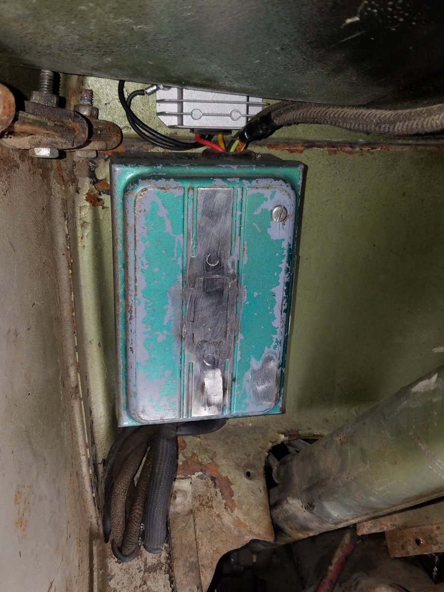

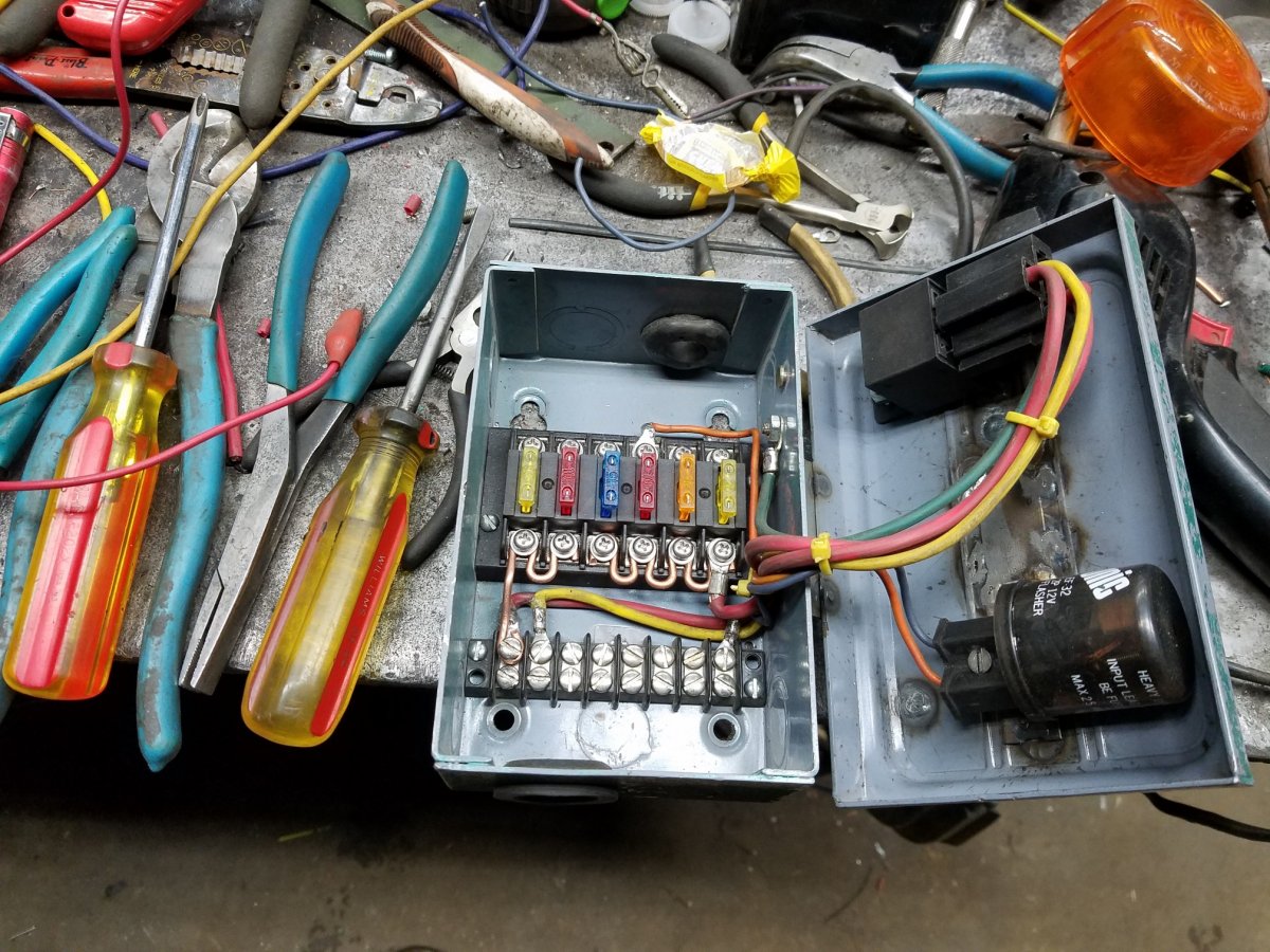

    I just finished up the new wiring in my "Tan Sedan". Switched to 12 volts and not being a big fan of walking home in the dark I decided I wanted some individual circuits with protection.
    I dug around in my inventory and came up with the original switch box that came on my dad's Powermatic table saw in the early 70's. It's about 4 x 6 and maybe 3 and a 1/2 inches deep. Has a nice slightly art decco cover which I hinged. It was a tight squeeze but I got 6 circuits and all the wires in there.
    I only used one relay so I could take the load off the little ignition switch and still turn off everything but the head lights with the key. I put the flasher and the relay in the cover.
    The 2 circuits on the left are hot all the time and the other 4 are heated up by the relay.
    Those are self resetting breakers. I ordered them same time as the fuse block thinking the block used mini fuses. When it all got here the breakers were mini and the block was for standard fuses, but they fit and seem to work fine.
    I could have done a little neater job, but the car is an all stock (for now) driver and will never be a show car. As it was I've probably got most of a week invested and life is demanding that I move on to other jobs around here, haha.
