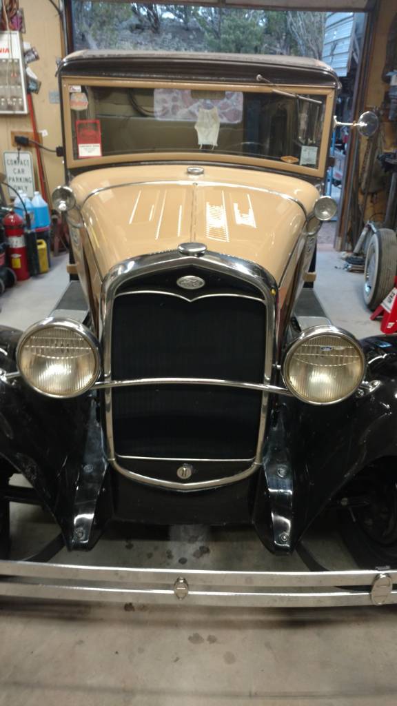

    Clutch back in, louvered hood on. Coffee and Cruise tomorrow. Clutch doesn't slip. New Sterling Flywheel, it did get safety wire. IMG_20200529_151650676.jpeg IMG_20200529_162225593.jpeg IMG_20200529_200549356.jpeg

    Did you face your aluminum flywheel and how much does it weigh?

    I don't know if you were asking me. It's a new steel flywheel that has a dynamic absorber in it. I imported 20 from the UK. I got 5 count 64 pound ones, 15 count 34 pound ones and 5 count 22 pound ones. The one pictured is a 64 lb one. Nobody wants them the others are all gone. It revs fine... Like I can turn 4400 RPM and feel like I could go higher. I have a 33 lb one on a flathead banger, same outcome and I can't tell much difference between the two. Going to see about Dyno results as soon as I can get access.
    Hope that answers your question...
