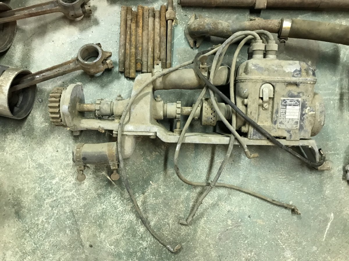

  3. Anyone familiar with this style of water pump? I've seen it on a few bangers, was this a factory part, or did it come off a tractor or something? DC660053-75F7-448B-8DDC-B1EDCDA25707.jpeg
    GuyW likes this.
  4. drtrcrV-8
    Joined: Jan 6, 2013
    Posts: 1,813
    drtrcrV-8
    Retson : Carefully clean that ***embly & look for a name in it somewhere : several different "brands" used something similar for their OH conversions on "B" blocks (pushrod or OHC) to simplify the waterpump/magneto mounting. There would be another housing that went over the original camshaft gear that the gear on the left end of your ***embly would go into to drive this & keep it in time, etc.
  5. Unfortunately this is a photo I found, this is what I have.

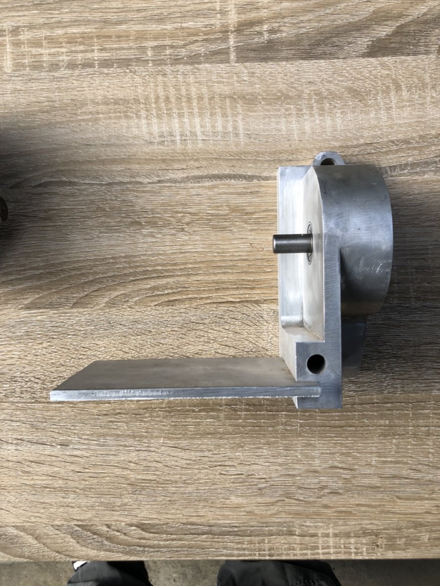

  10. Just got the mag! Seems it isn’t as easy of a connection as I was led to believe. Anyone have advice in gears to adapt this? IMG_4020.JPG IMG_4021.JPG IMG_4022.JPG IMG_4023.JPG
  11. grumpy gaby 2
    Joined: Aug 10, 2019
    Posts: 466
    grumpy gaby 2
    That mag is a low base. You need a high base to line up to the other shaft. Or a spacer.

  13. noboD
    Joined: Jan 29, 2004
    Posts: 8,995
    noboD
    Why not use a spacer under the mag to get it to line up? Should be easy to get a measurement.

    this looks and I say looks like a set up that was my HAL dohc engine I am no expert mine might have been from a tractor or something
    Gasolinedeniz likes this.

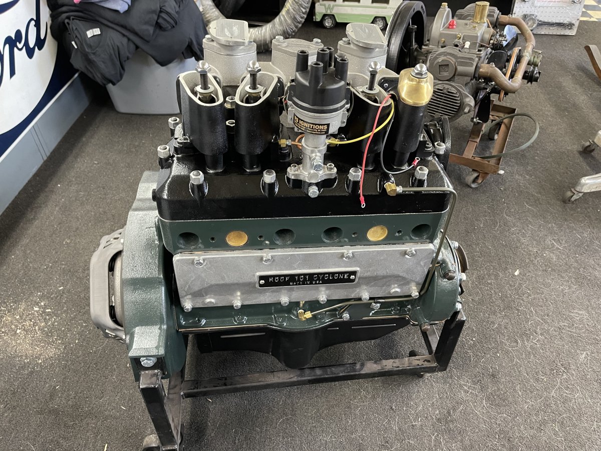

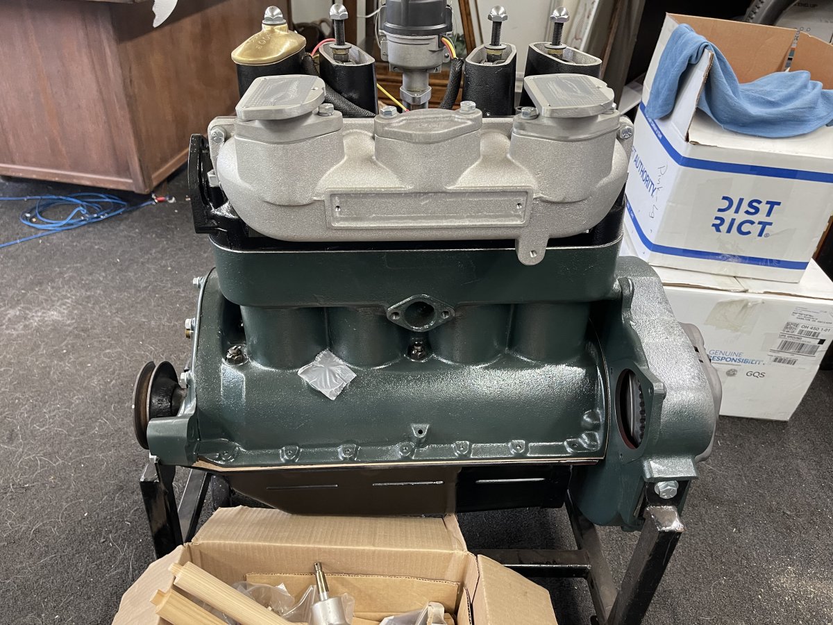

    6EFCFF95-2230-4448-A057-A517E4D0B641.jpeg 37C95AE7-D58C-4162-AD74-ED6349845A9F.jpeg Got my roof overhead B engine finished
    GuyW, v8flat44, chriseakin and 8 others like this.
  21. How “unobtainable” are these Frontenac Water pumps?
    I found out you can use them combined with a side drive magneto!
  22. $um Fun
    Joined: Dec 13, 2008
    Posts: 680
    $um Fun
    from Nor Cal
    That's not a Frontenac water pump, its a 1915 Dodge, the only year they were br*** after that they were cast iron. The Frontenac pump was aluminum and was much different looking. I have one in the shop I will take a picture and post.
    The mag mount is also different and you need the water tube casting from the pump to the side of the block. Oh, you could also drive a oil pump on the side.
    97, Old Dawg and Retson the Racer like this.
  23. noboD
    Posts: 8,995
    noboD
    Please don't use up that br*** water pump for this. I have several cast iron ones if you want one.

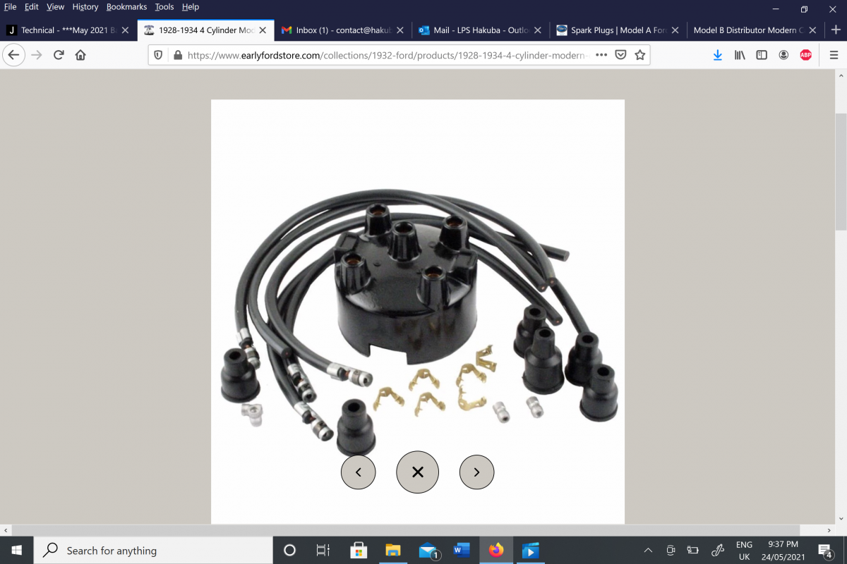

  28. I did this about a year ago on my bone stock Sport Coupe I had. I ordered everything from MACS and it worked out well.
    Attached is a link to the rotor I used.
    https://www.macsautoparts.com/distributor-rotor-4-cylinder-ford-model-b-47-26234-1.html
    panhead_pete likes this.
