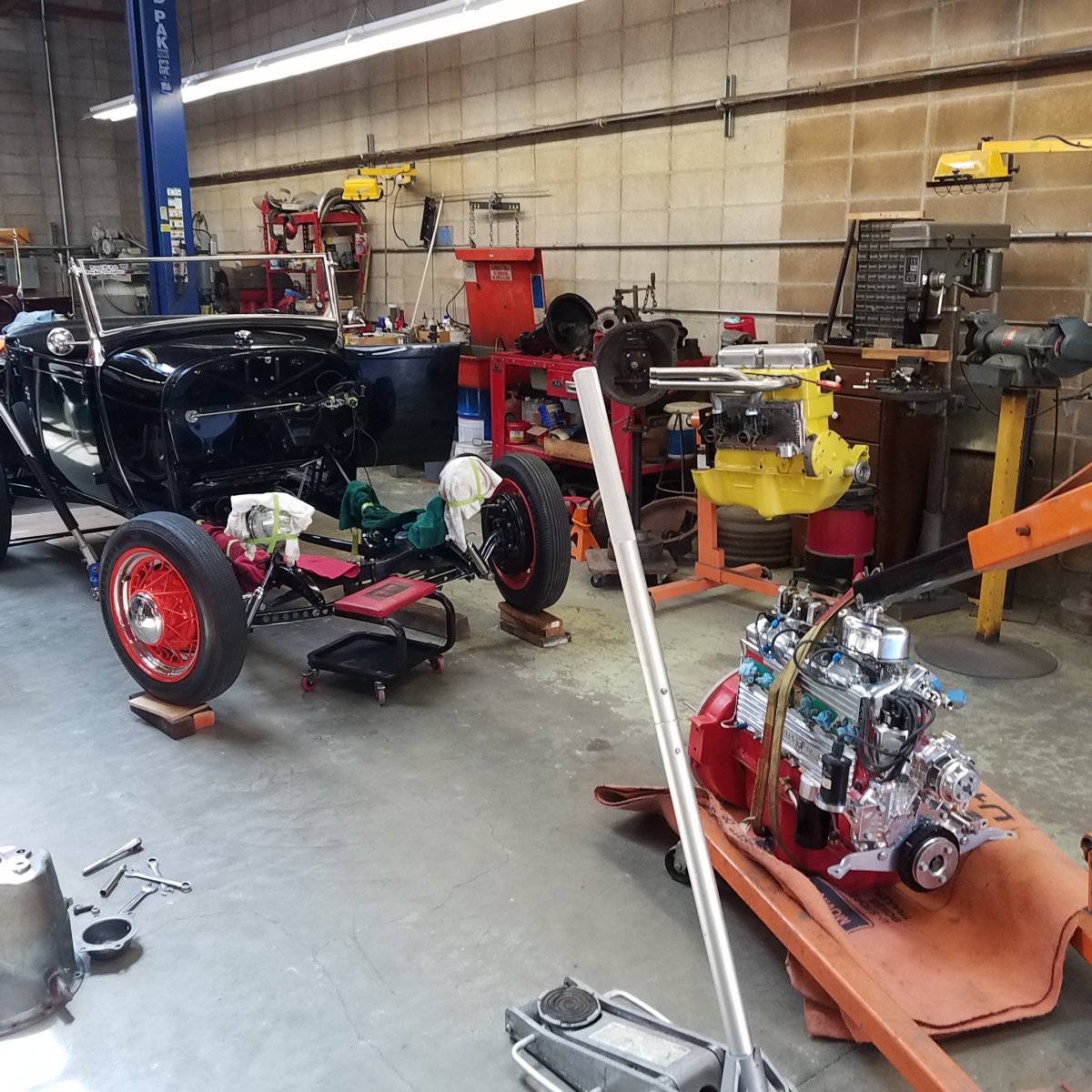

  5. This is Jack Dewar's Hobby Shop! Max McLain who broke the crank in his Jenkins headed B block; is putting in a borrowed Riley 4 Port engine for the Santa Margarita F.A.S.T. Time Trials next month! Max'sEngine.jpg
    GuyW, Jet96, v8flat44 and 3 others like this.
  6. Both engines in the picture are absolutely beautiful. One day I'd like to make the drive up from Lompoc to come pick your brains!!
    Old Dawg likes this.

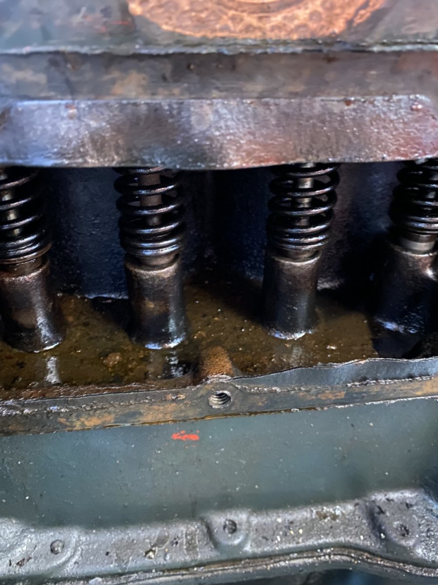

    Hi everyone - Today's finding made me scratching my head. I own a G28 4Banger. I opened the valve cover to check the lubrication system and made an interesting discovery. There're no drill holes in the main oil line. The G28 definetly got oil pressurized camshaft and crankshaft bearings. Did I overlooked some? Does anyone got a clue how the oil runs and how I'm able to check the system? Thanks a lot and many greetings from Germany.
    Daniel IMG_20210527_162006.jpeg IMG_20210527_162016.jpeg IMG_20210527_162006.jpeg
    Sent from my LYA-L09 using The H.A.M.B. mobile app
  30. V4F
    Joined: Aug 8, 2008
    Posts: 4,391
    V4F
    from middle ca.
    model "T" has the end that works .
