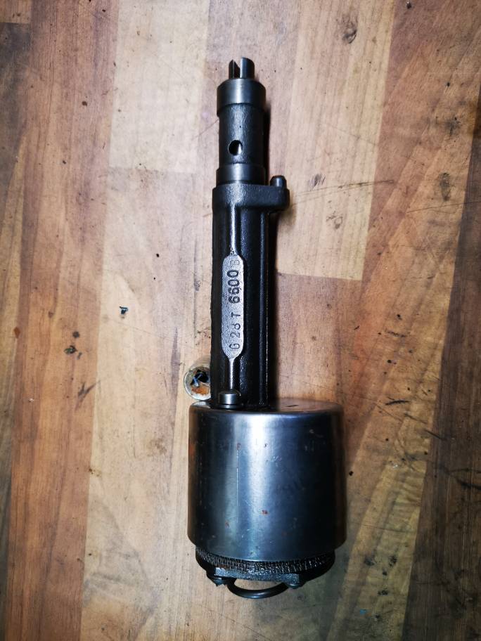

    John, thank you so much for your input.
    I checked my old pictures and found the pipe you're talking about. So far so good.
    Today I tried to figure out if the oil pump feed the pipe/cam/crank correctly. I removed the distributor cap, spark plugs and pulled the starter several times. While I was doing that I filmed the valve train. But after all no oil flow was visible.
    The engine was build by a professional engine shop some months ago. They mounted a high volume pump from Bill Stipes. And made a short test run.
    My worry - the G28 oil pump got a recess on the top. I'm wondering if the shop machined these recess in the high volume pump?
    Is there any chance to check the oiling system without dropping the pan? The G28 pan is huge and I'm not able to drop w/o removing the wishbone...
    Shouldn't I see some kind of oilflow around the valve lifter after pulling the starter 3 or 4 times in a row?

  4. Daniel,
    I don't think you will see any oil up in the galley just from a little cranking.
    If I remember correctly, the lifters are hollow on the cam side. This allows for the natural pumping action to push oil up to the top of the lifter, there should be a small hole in the side of the lifter exposed when the valve opened.
    That may be a problem since the lifters have been changed to adjustable.
    You may be able to see a relief cut in the top of the pump housing if you take the plug out of the side of the block.
    John

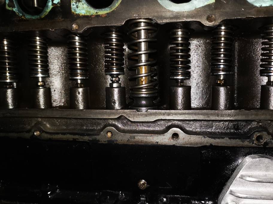

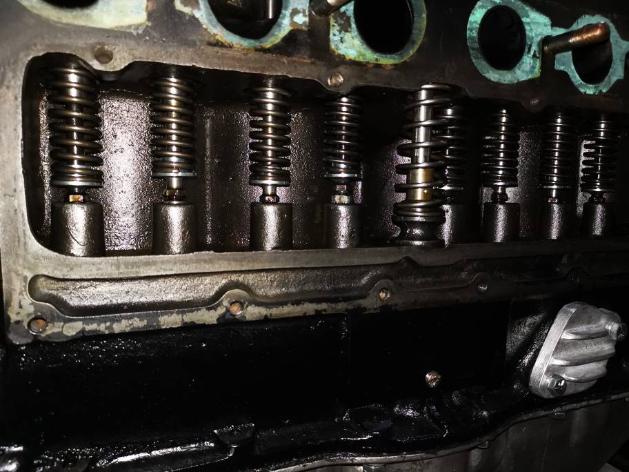

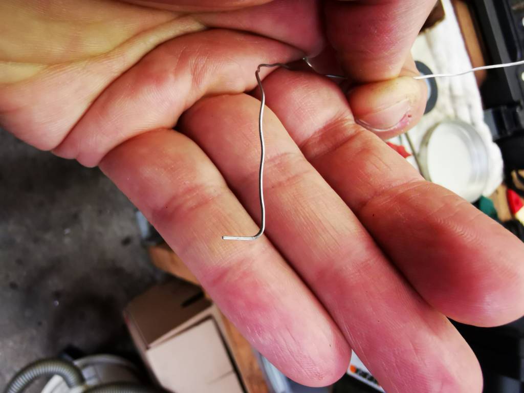

    New day - new observations.
    Tried to find out if there's a relief or not without dropping the pan.
    Managed to light up my borescope and unscrewed the pump holding screw on the side of the block. After many tries I made some pictures. Hopefully you can see the billet pump housing and the brass "triangle".
    I couldn't see if there's an relief or not.
    So I tried to poke with some 90 degree bend wire. On top and bottom I was able do insert the wire completely ~5/16" (green area) . On the left and right side was impossible (red area).
    So what is the conclusion now? [emoji2369] Am I good? Got my engine oil pressure? Should I fire it up for running in? Questions over Questions [emoji23] IMG_20210529_212503.jpeg IMG_20210529_120932.jpeg IMG_20210529_212548.jpeg

  11. Daniel
    I was thinking about it today
    The real answer is to drop the pan and verify
    They may have drilled a hole on the back side of the pump to feed oil
    Can you ask the shop who put it together
    best of luck John

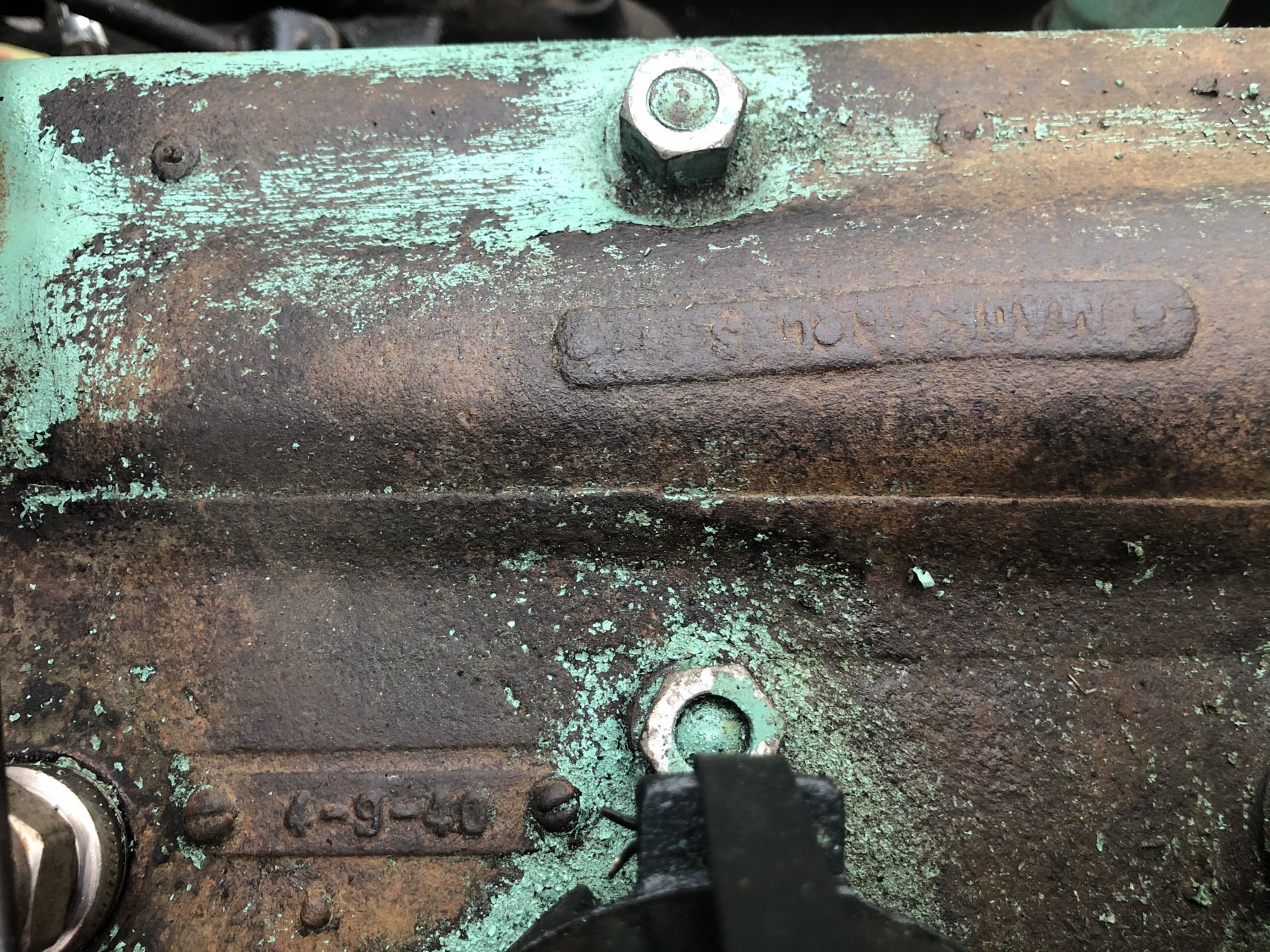

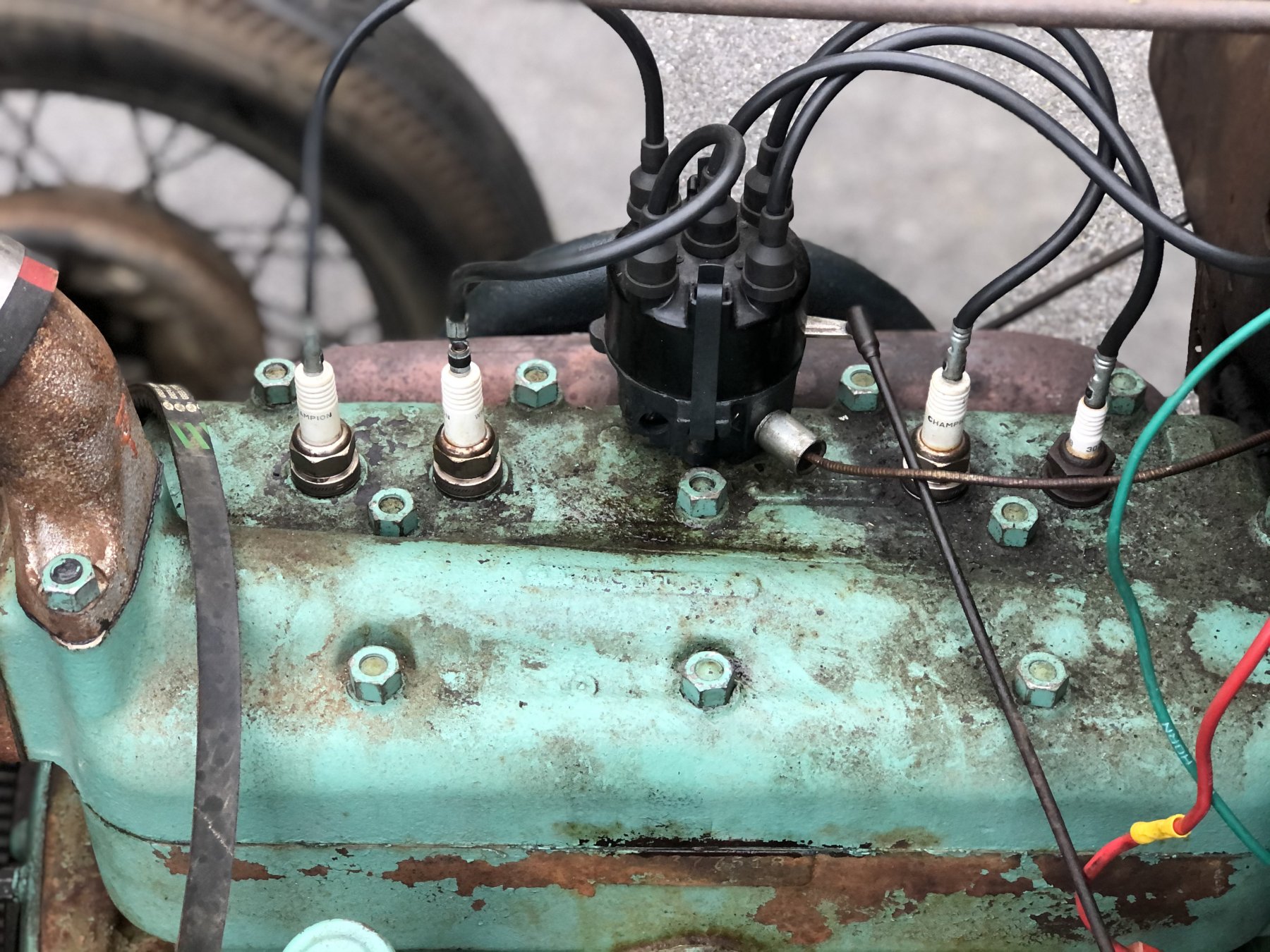

    Anyone recognize this head? Seems to have a raised stamped area that is different. I still can’t make out the letters/numbers. I think it may say “MADE IN USA”.

    from middle ca.
    not an expert in any way , but could be stock head

    Yeah. I don’t know. I have a few other Model A heads that I thought were stock and they don’t have that raised area.
    Wonder about the weird light green color.

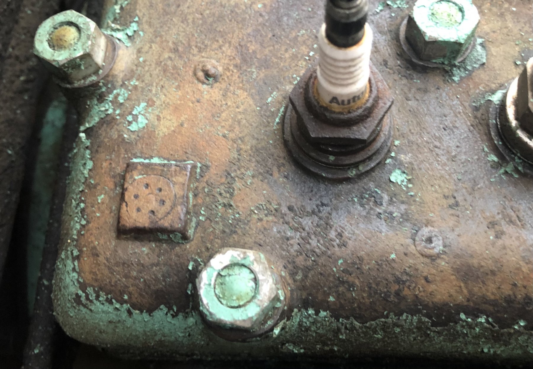

    Thanks Retson! I didn’t see any F2s or MFs but there is another tag.

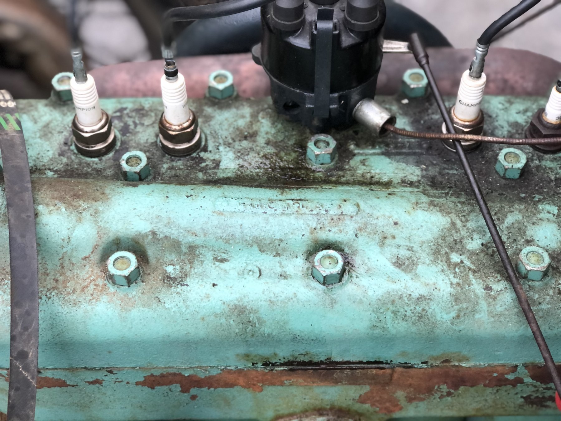

  27. Is there any marks underneath the waterpump area?
  28. Tribalmonkey
    Joined: Feb 17, 2019
    Posts: 921
    Tribalmonkey
    No. But once I started scrubbing a bit the paint wiped right off. Easier to see the the one tag now. 4-9-40

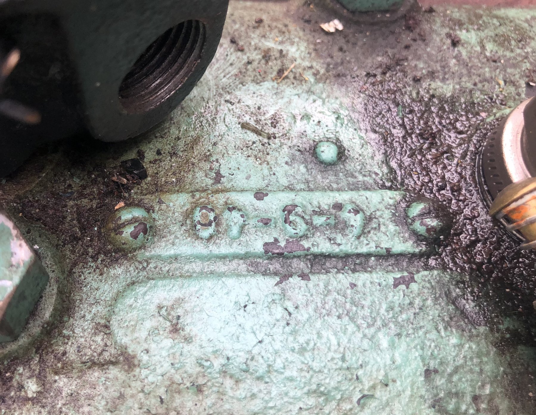

  29. Tribalmonkey
    Posts: 921
    Tribalmonkey
    There is also this stamp near the passenger firewall.
