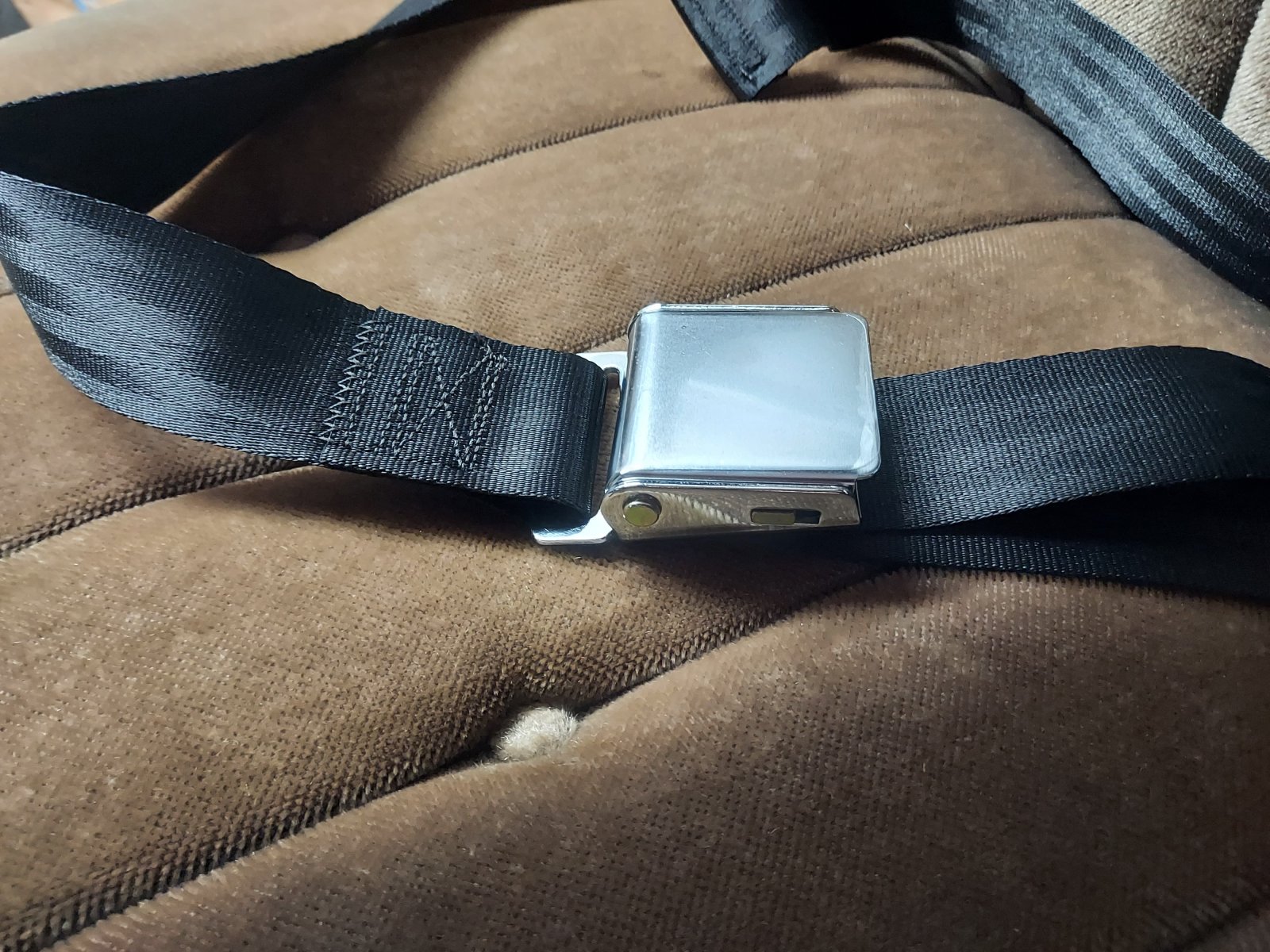

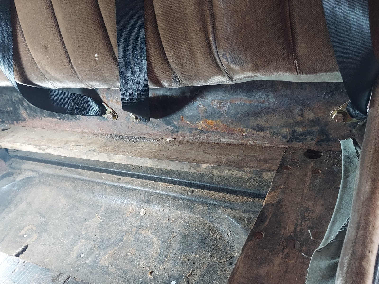

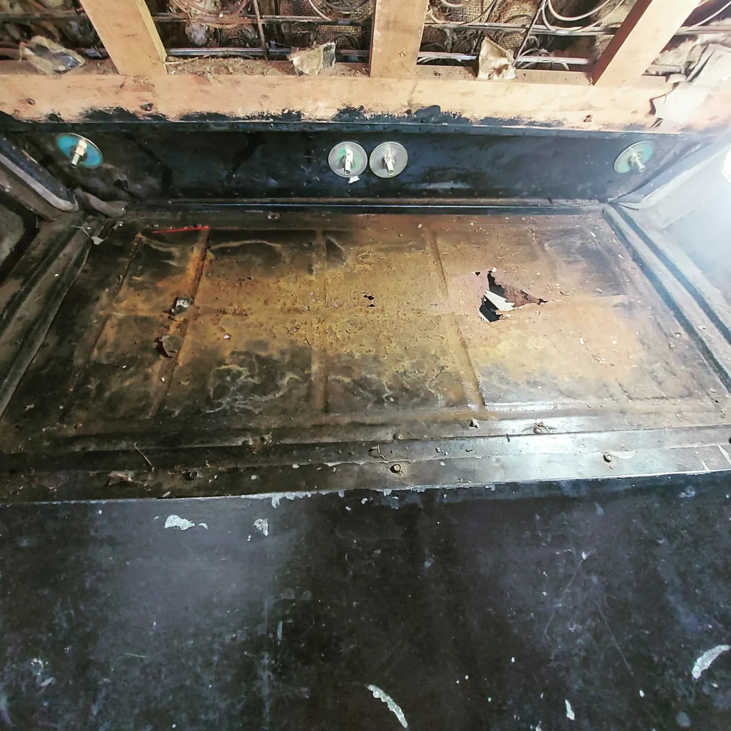

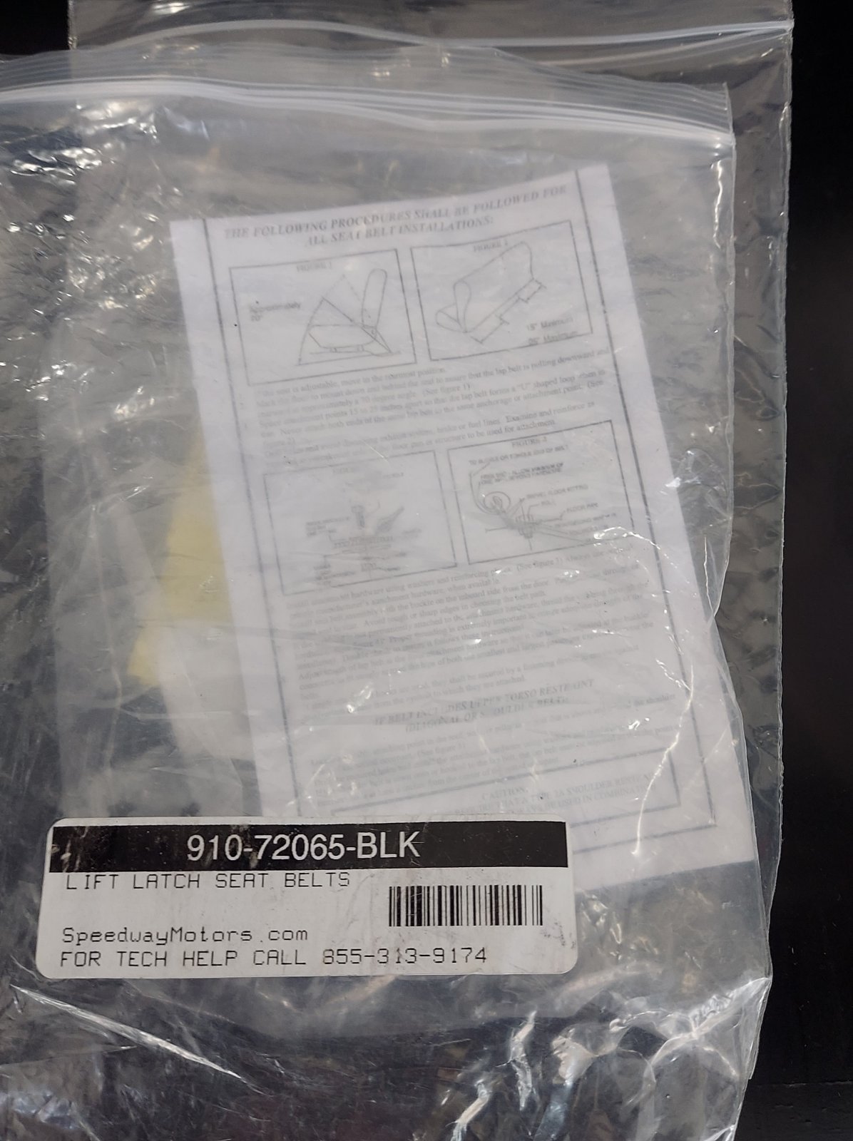

    @panhead_pete - Yeah, unfortunately Andrews doesn't cover seatbelt installation for roadsters in his book. Ultimately I've just got to find a good place to drill and bolt in, but also to avoid shearing under stress. My current "seat" isn't really a seat, it's just two cushions that fit in that space and mostly stay put. I've got a fixed back Glide seat ordered, but it won't be here for months.
    Also, I've already been following your dedicated thread closely. I'm going to order the same belts thanks to your recommendation.
    I'm right behind you, as I'll soon be moving to wire wheels, 750s/600s, and dropping my fenders at some point. I just keep getting distracted by driving it instead of working on it, which is fine by me.
    Trying to figure out how you have these great cars in Japan. :) There must be a story there. Really like what you're doing.
    Hope to get some time on the car this weekend.

    Looks good. That’s how I installed mine.

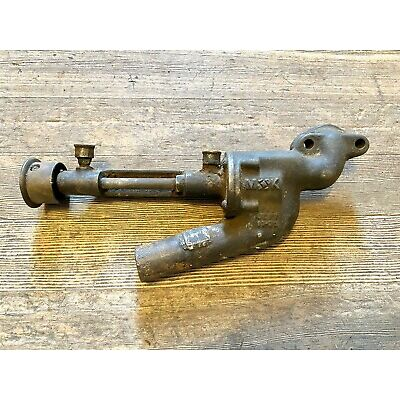

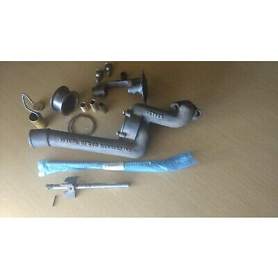

    Somehow my goofy old brain has gotten started thinking about hanging a water pump on my B engine with modern bearings and a carbon seal.
    I don't care for the afterthought look of the V-8 pumps on an adapter hanging off the front of the head and obviously pumping hot water out of the top of the engine is less efficient than pumping cool water into the bottom.
    There appears to be a large variety of aftermarket water pumps for the Model T engines and some are pretty sleek and ***y looking, haha. Currently there are a half dozen styles on ebay and mostly priced at under 75 bucks. Here are a couple examples.
    I think I could fairly easily build a replacement drive ***embly for either of these that would use a modern water pump bearing and carbon seal. I'm already sort of thinking about a serpentine belt setup so driving the water pump off the back of the belt just above or behind the alternator might work alright. Looks like I'd need to make a custom oil fill tube, no worries there.
    Here is my question, are the water inlet bolt flanges the same or similar size on Model T, A and B engines? This is not a project that is going to happen right away, just organizing my thoughts and possibly gathering some parts and ideas.

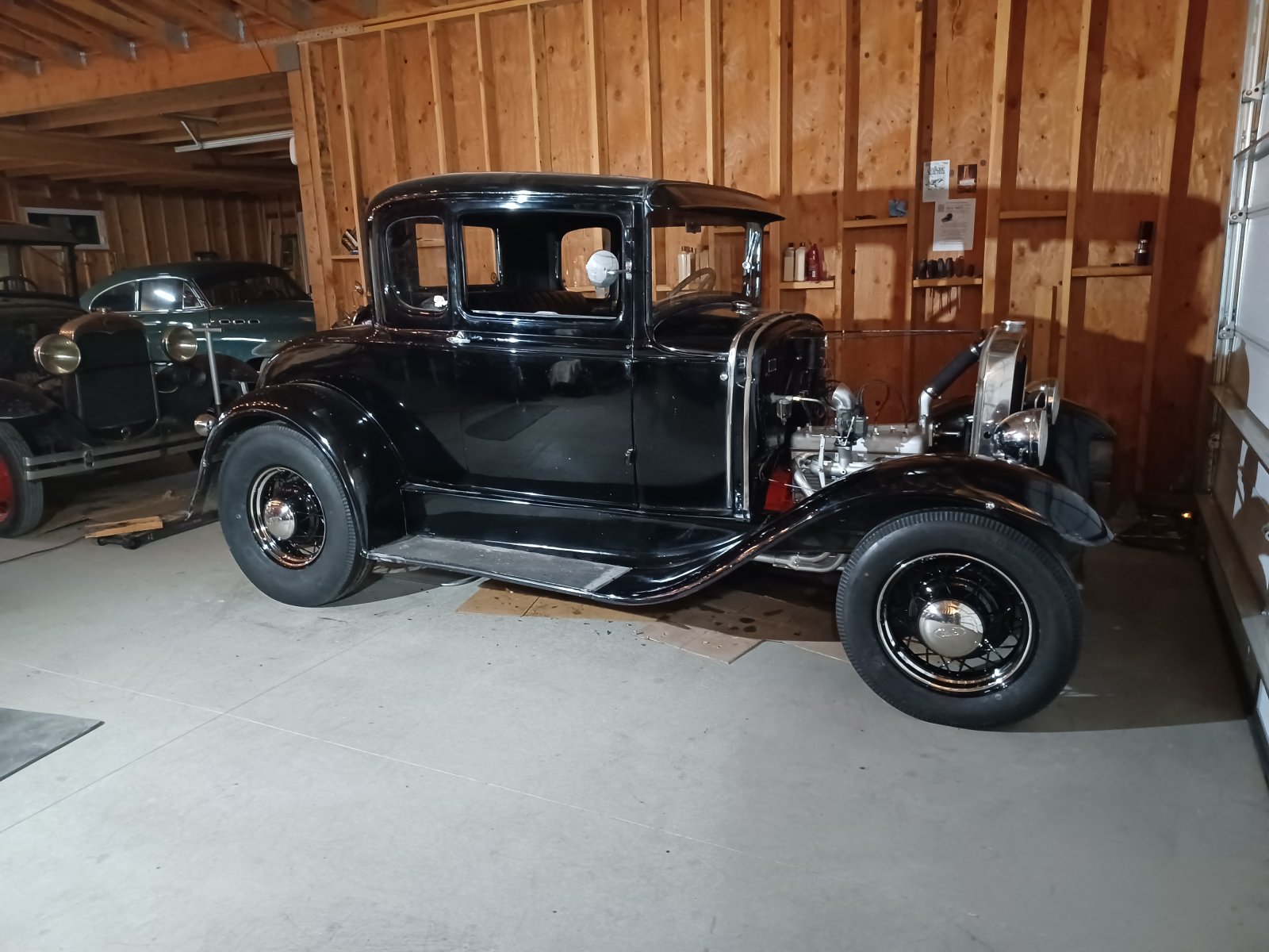

    Looks real good Dan....how does it run?

    I don't know the answer to your question but I'm having great luck with the lip seals and new stainless shafts available thru your friendly Model A house. You change the cartridge and install the new shaft. It can be purchased with an impeller too. It's a pretty easy job. Collectively probably over 30,000 miles, with the one, with the most miles, being about half that. No more leaking packing and three row/10 fin per inch Br***works radiators with a 3# cap solved the cooling problems.
    Just did a round trip to Denver and back plus another 100 + miles on top of that with the garage crawl
    Couldn't get the defoggers to work in the snow at Monument p***...about 10 miles of it. Other than that, trouble free and the Riley flat headed B motor moved me 65 mph to and from no problem IMG_20220501_064340651.jpg

    Haha, looks like Charlie Yapp didn't want anyone to miss the fact that he changed pumps. Surprised he missed the oil fill tube.
    Thanks guys. It appears that the A bolt flange might be a bit wider, not enough to need big mods. Anyone else got pictures?
