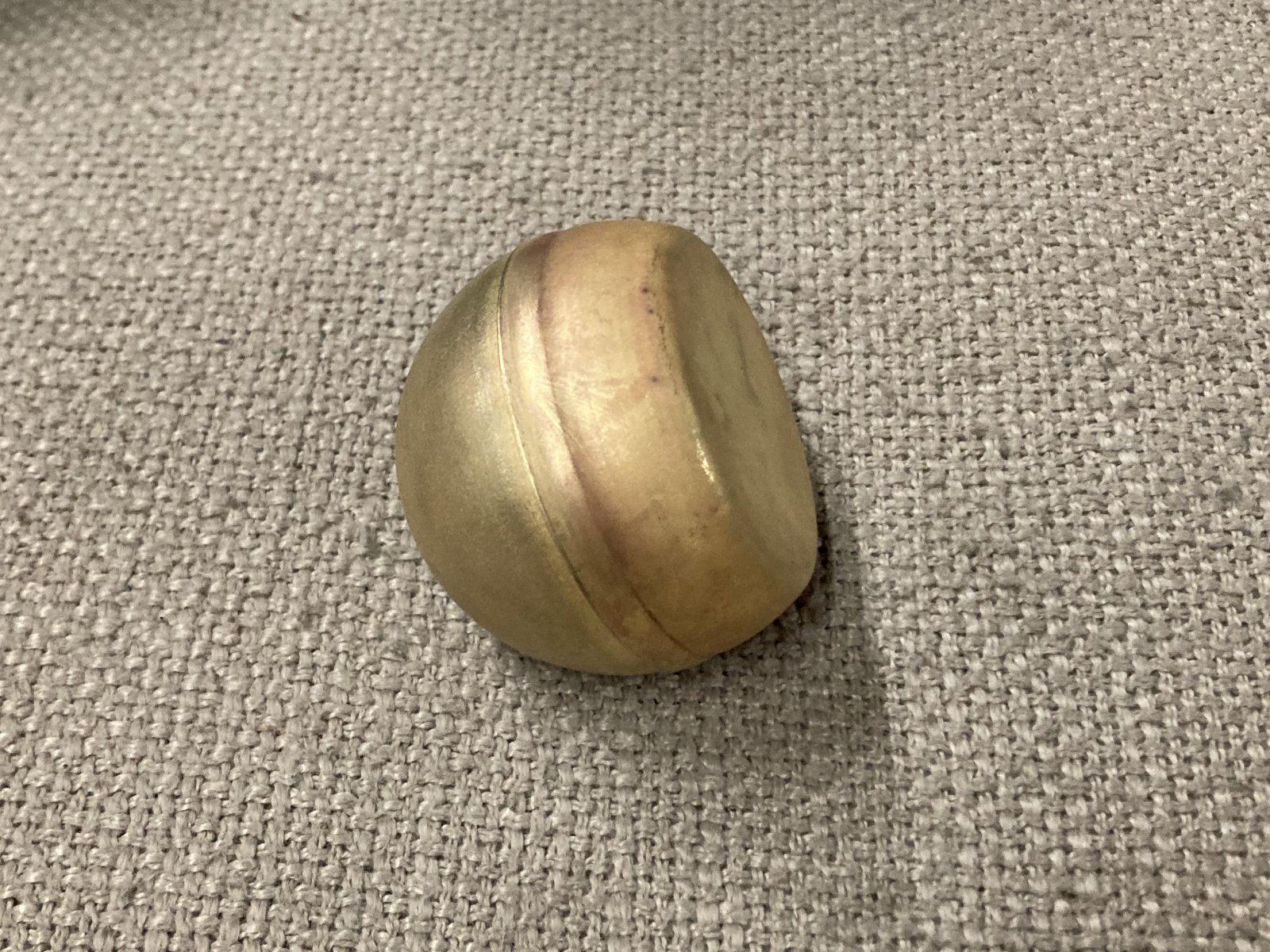

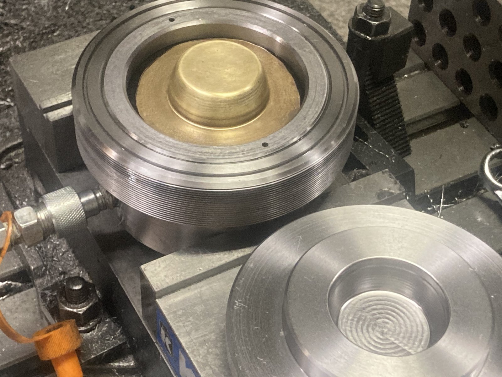

    Gettin the bugs worked out of forming new Winfield float balls. Spinning em didn’t work out, so workin on hydraulic forming this time:cool:

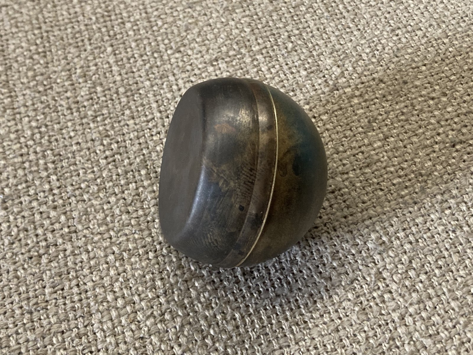

    Just need an acid bath to clean it up, and a bit of solder...:D
    A little vinegar...

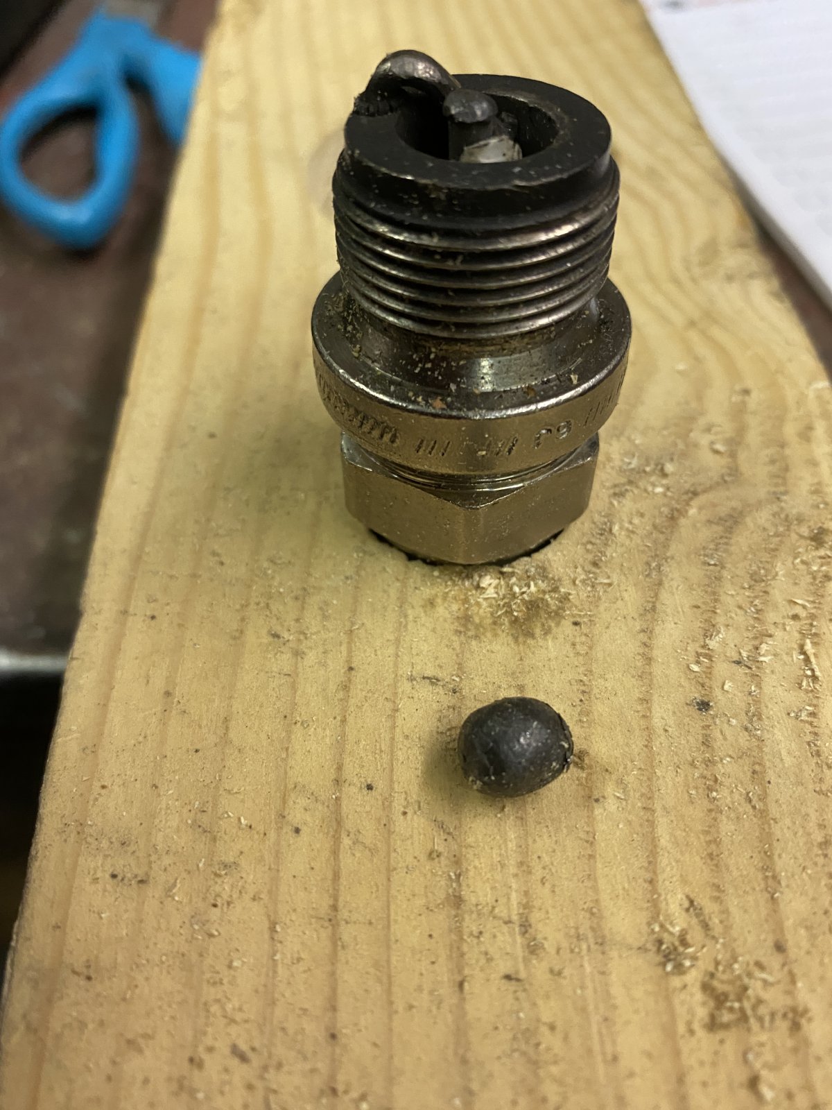

    Last summer, my CCPU with the CRAGAR quit during the Speedster Reunion. Finally attacked it today and found the broken spark plug and the round piece of metal in #4. Looks like lead but is magnetic. I’m running a OHV CRAGAR and a Weber 32/46 carb. Any thoughts? F99538DD-4990-44C6-A93B-BC79F447B734.jpeg
    Are all the screws still in your throttle and choke plates?

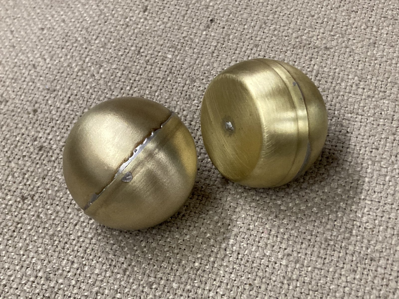

    Did a little soldering tonite... and yes, it floats!:D

    Not real proud of my solder joint on this one (got it too hot)... but had success making the Winfield S float this morning. They are both on weight, on size, and float right! :D

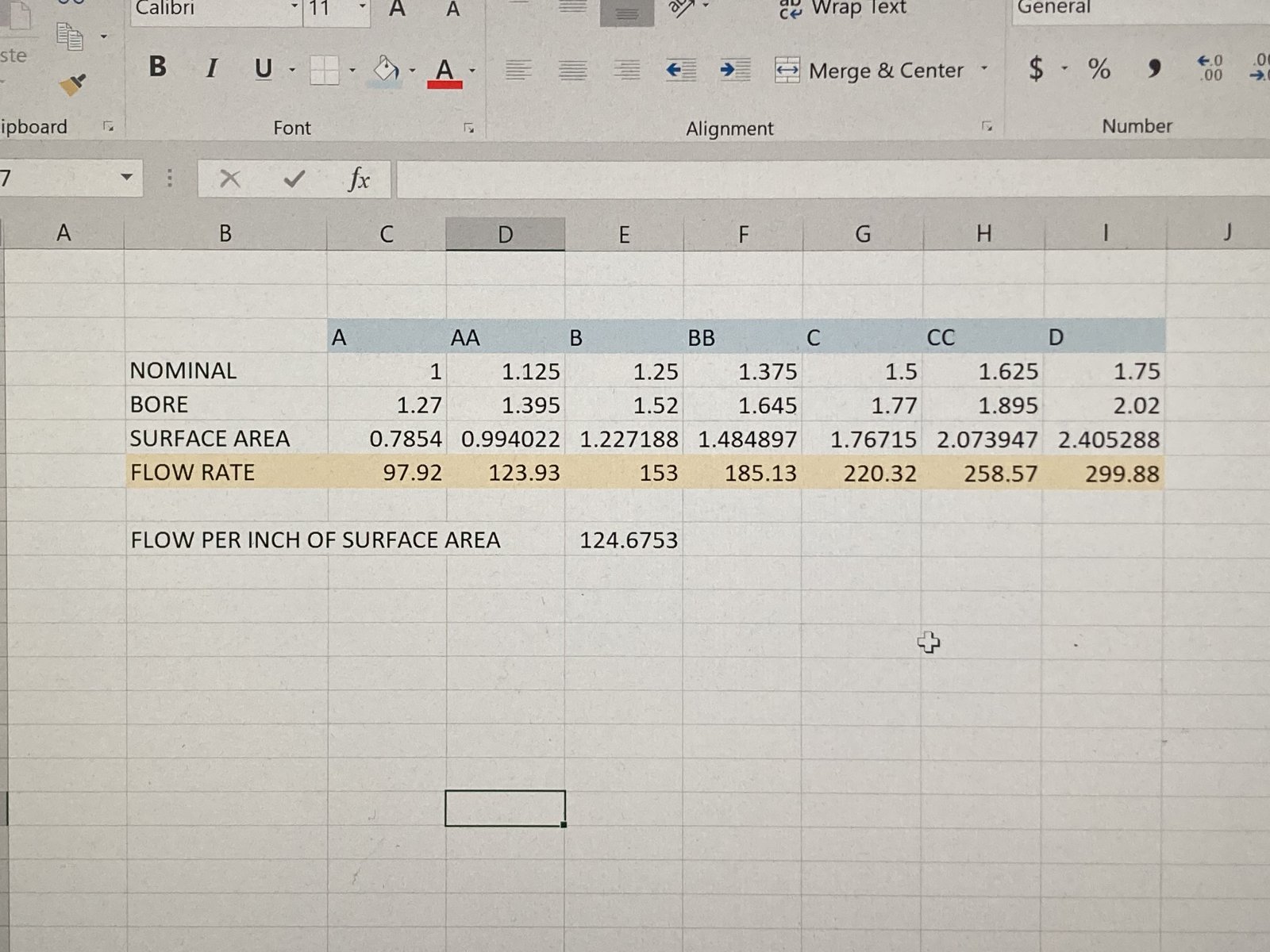

    Adding this chart for carb size comparison, seems to me an 81 flows about 110 cfm...
