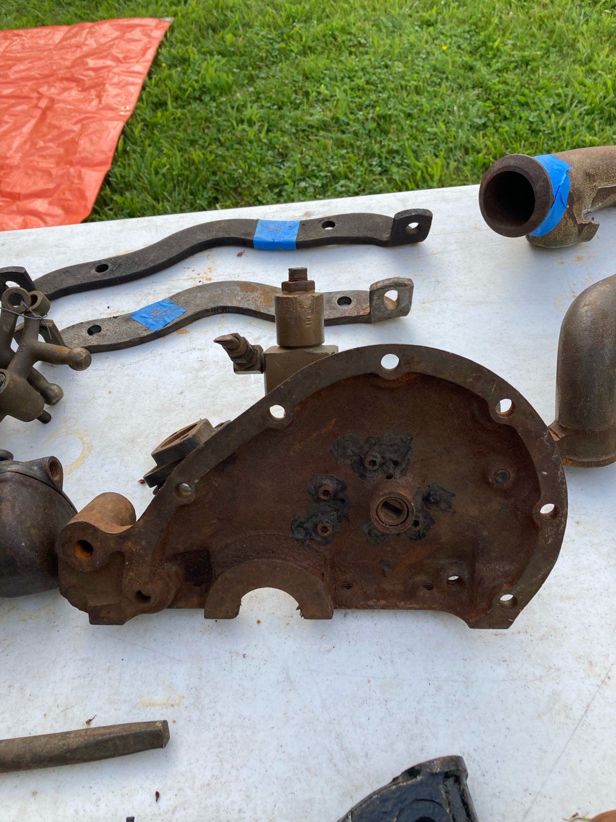

  4. Those that have fiddled with front drives, have you ever seen something like this before?
    Trying to figure out how to adapt something that either attaches on the cam via a right hand thread on the face of the cam, or something with the cam nut. 67422455510__C760A5AE-F4F3-4DB5-B42E-636604F22CB1.jpeg

    I am no authority when it comes to the A accessories, but the V8’s used a tanged ****on to drive the front mounted dizzys. T folks machine a tang on the back of the cam to drive a VW oil pump

  9. I appreciate the comment! I checked out the vw pumps for T's, thats wicked! Mine looks like it accepts the tang of a distributor shaft or something similar. Time to get to work...

    That front plate is clearly home made with its brazed in screws, so anything is possible as to how it was driven. I don’t think there is room for a special cam gear nut that extends beyond the end of cam without cutting back the thrust plunger boss. Probably had something low tech like a 5/16” or 3/8” screw in the nose of the cam, with the tang machined into the head...

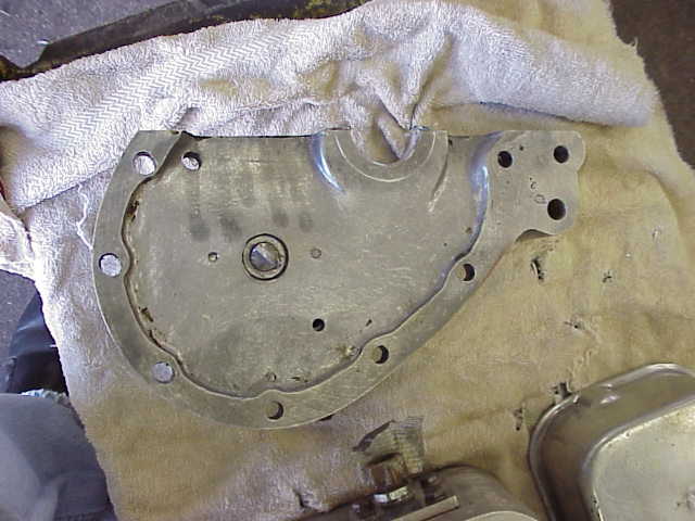

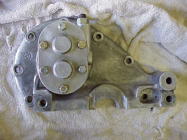

    Here is a cover that I have. This oil pump was tang driven by a grove in the end of the cam.

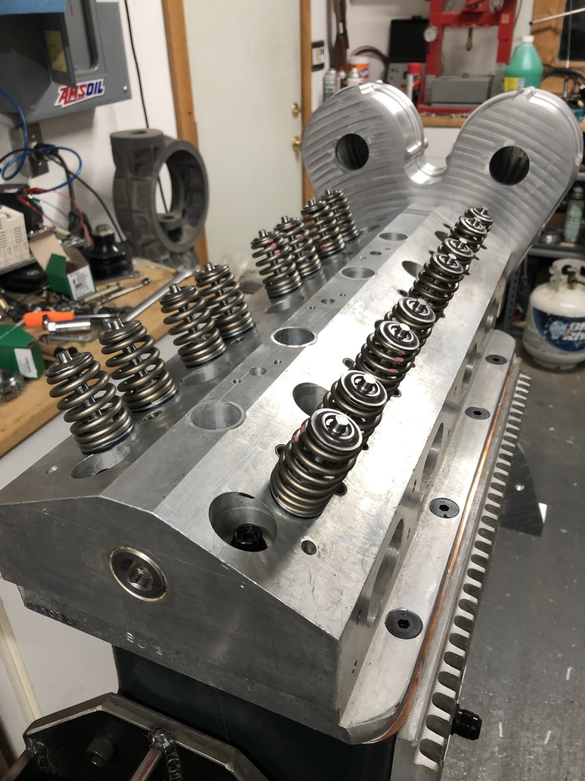

    @johnneilson that's some nice work. The head sort of reminds me of a Jaguar but with more valves.

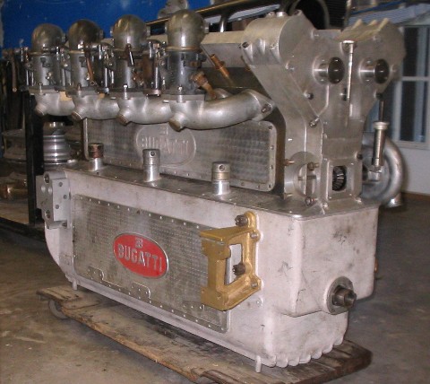

  25. The37Kid

    First reaction was Type 50 Bugatti with all the machined surfaces.

    Bob, I think it was the angle of the pic for me and probably didn't hurt that I just got a couple of old Jaguar heads today a**** other parts.
