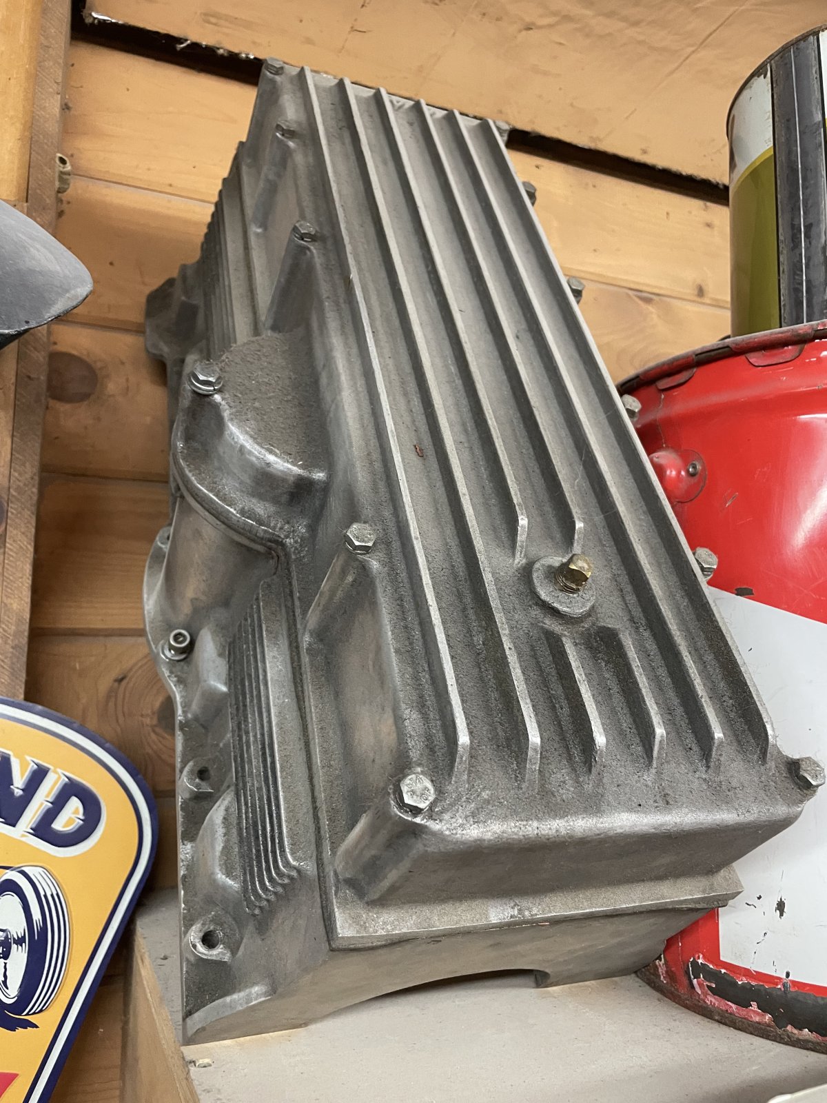

    IMG_3840.jpeg I bought this 2 piece oil pan from an “old guy” in CA in 1987. He said it was a Rutherford pan. I was 18 then, now I’m the old guy.
    Dan from Ohio saw it on my car and I believe he said he made it. In a A ch***is the tie rod interferes.

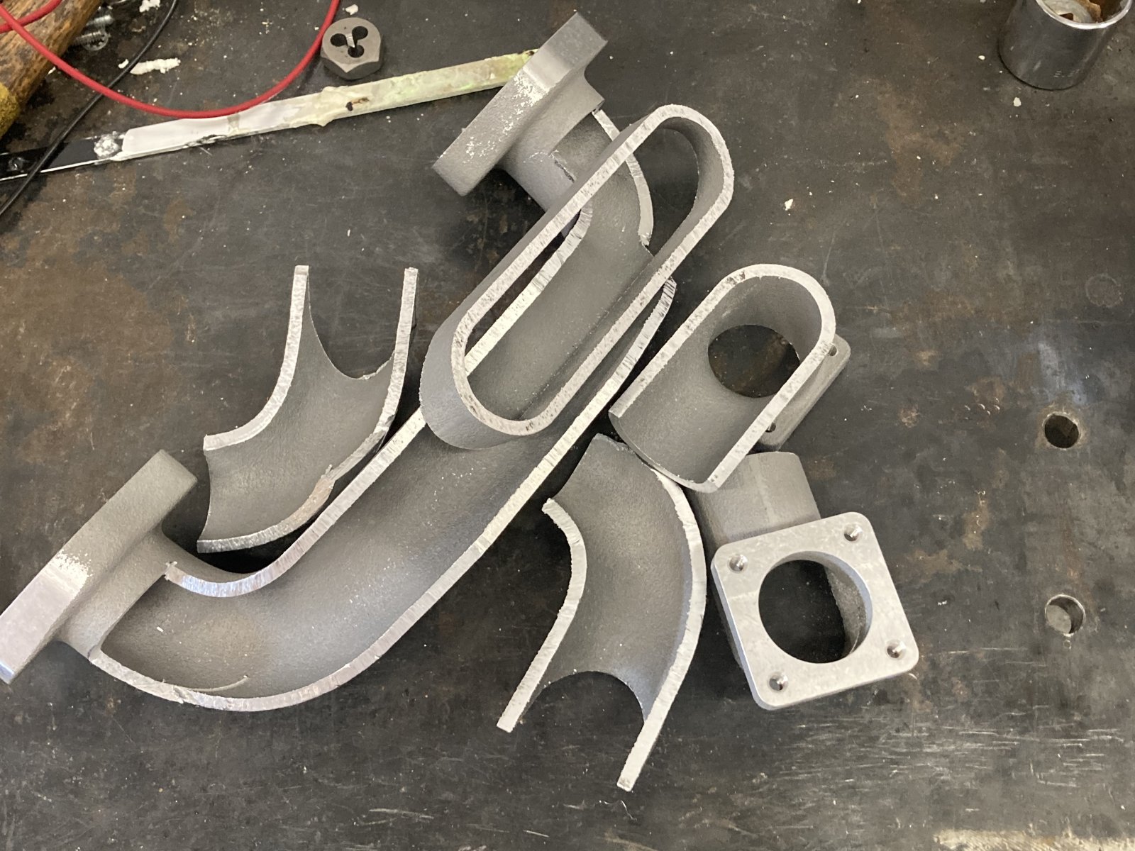

    No guts… no glory! Now for some quality time with the band saw:confused:

    It can’t get any worse…:eek:

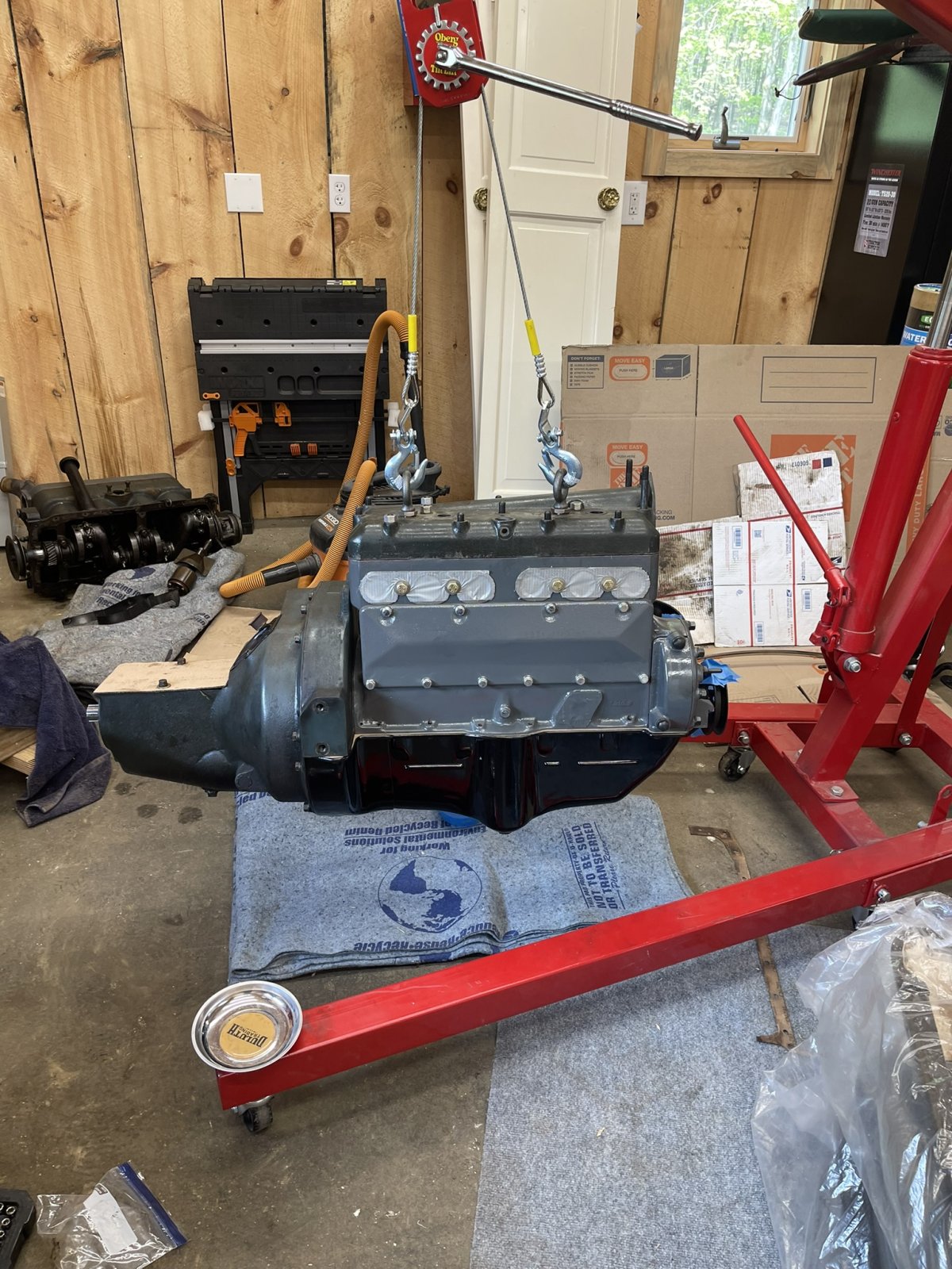

    Making some progress!

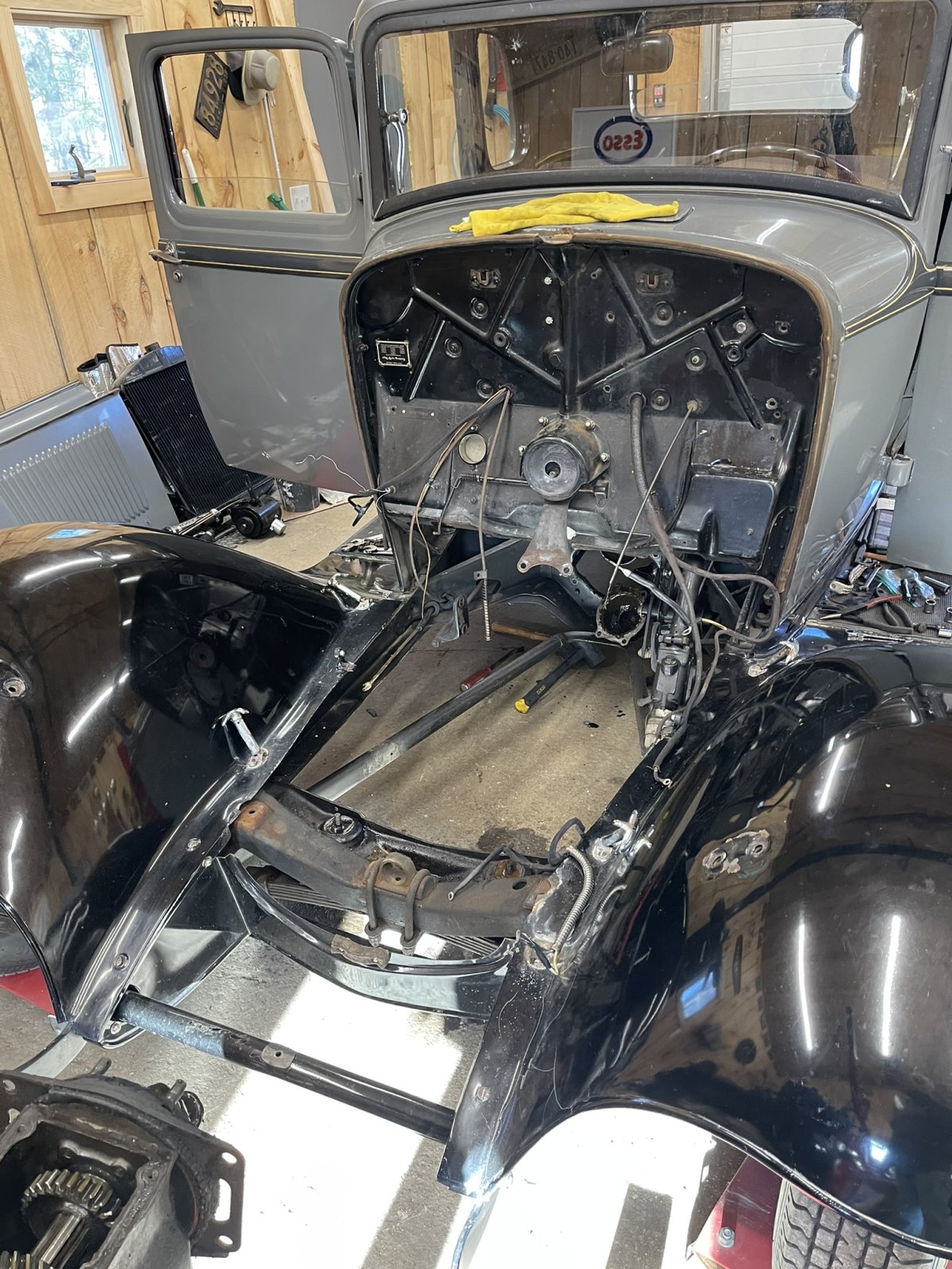

    Engine in and ready for setting the hood, inner fenders and grille.

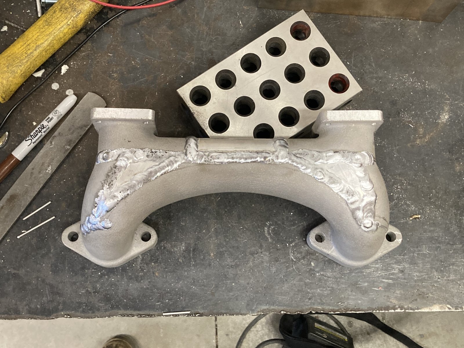

    Mama said she wanted to be left alone to read her book all day… Cool! I’ll be in the shop!:D

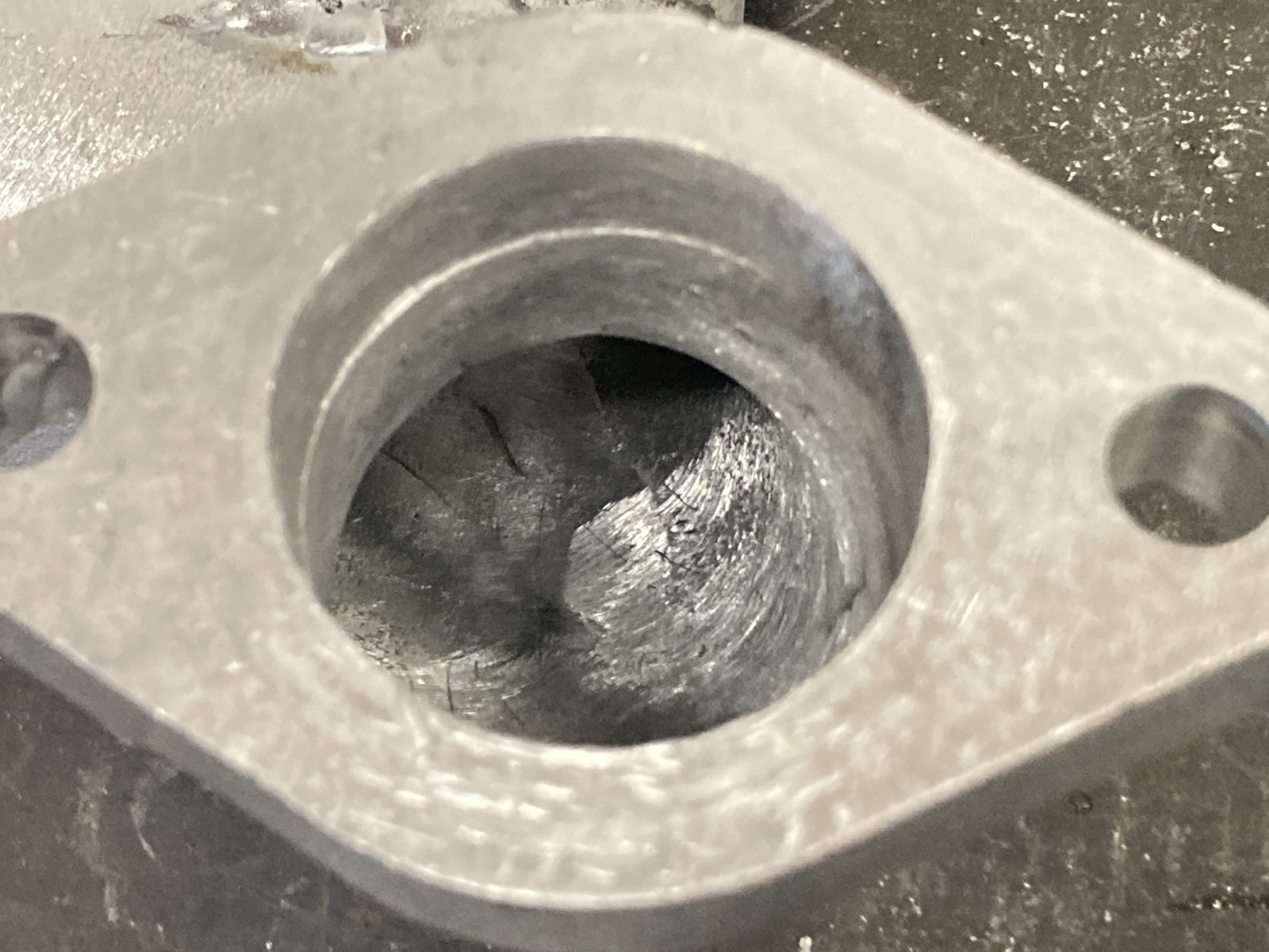

    Finished up the welding this morning and got the easy side of the manifold blended out. It may be a candidate for polishing after all! The drawback to full penetration welds is all the stalac***es in the runners, nothing a carbide burr and a couple hours won’t solve. Just have to resurface the flanges now…

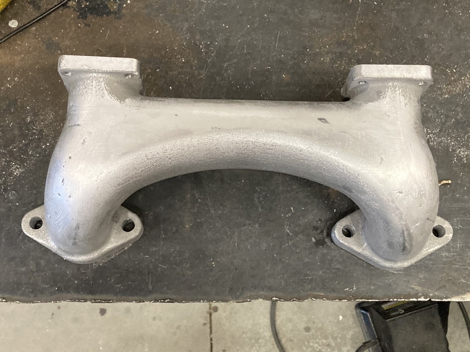

    That looks like the a nice casting, what is the purpose for all this work, better flow? Better carb position? Aesthetics?
    Looking good @Kevin Pharis
  18. Kevin Pharis
    Joined: Aug 22, 2020
    Posts: 724
    Kevin Pharis
    from Califunny
    It’s a looooong story… so short version. Custom cast manifold to crowd 2 Winfield’s close together (sideways) on a plenum style manifold. Works great… as long as I’m driving straight! I had underestimated their sensitivity to fuel sloshing. Having another cast without drawing the wife’s attention was not likely to happen.
    Soon I will be able to mount the duals back on the car to see how it runs (while turning). I know the pair of carbs are too big given the sideways mounted experience, but will be making sleeves to size the Winfield’s down from B’s to A’s. Will reduce from 300 cfm to 200 cfm (probably still a bit too big)

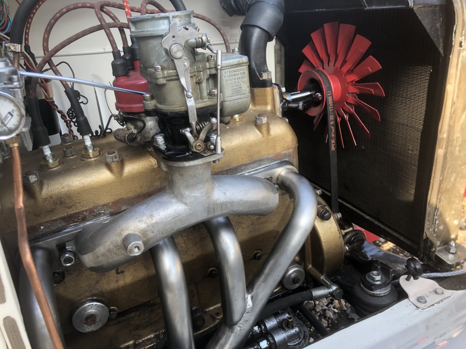

    Wow Phil that's a crazy looking little fan on that hopped up 4 banger

    @hotrodfil
    I believe that little fan may be intended for use in the southern hemisphere… where toilets and fans run in the opposite direction;)

    BMC east/west models are all sideways with radiator on inner fender, hence the pusher fan. Might work OK if you reverse down a really looong driveway

    @hotrodfil
    Lookin closer at yur engine, what plugs are you runnin…? I can only make out part of the number but looks like LZK??? Google says maybe 12mm x 26.5mm thread? I put 10mm plugs in my T and looks like we have a similar problem… loose boots! I have yet to find any wire sets for these smaller porcelain plugs as they are all intended for use with modern direct mount coils. Have been considering making a mold and casting my own boots from silicone…:eek:
