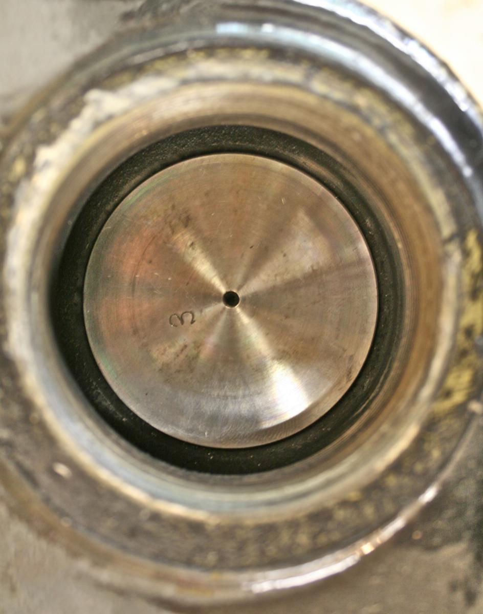

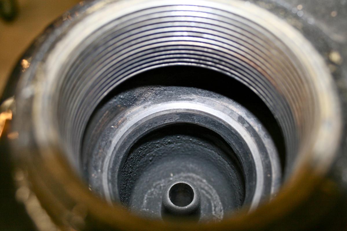

    For what it is worth, some photos of a Mercer valve seat and chamber. They are different from a Ford but they still are a flathead (T-Head). They were designed as a racing engine and were very successful and are almost 7:1 CI which was about 3 points higher than everything else at the time. Take a look at the space on the left hand side of the valve in the first photo. That is the clear space they provided so that the valve can breath all around on the back side, the rest of the chamber and cylinder is to the right.
    Into the threaded area above the chamber is a valve cap the bottom of which is flush with the top of the chamber. There is approx. 3/16 clear space between it and the valve at full opening. The two plugs (one per side) are in this cap directly above the valve.
    To get an idea of how they are constructed look at the video I posted earlier today.

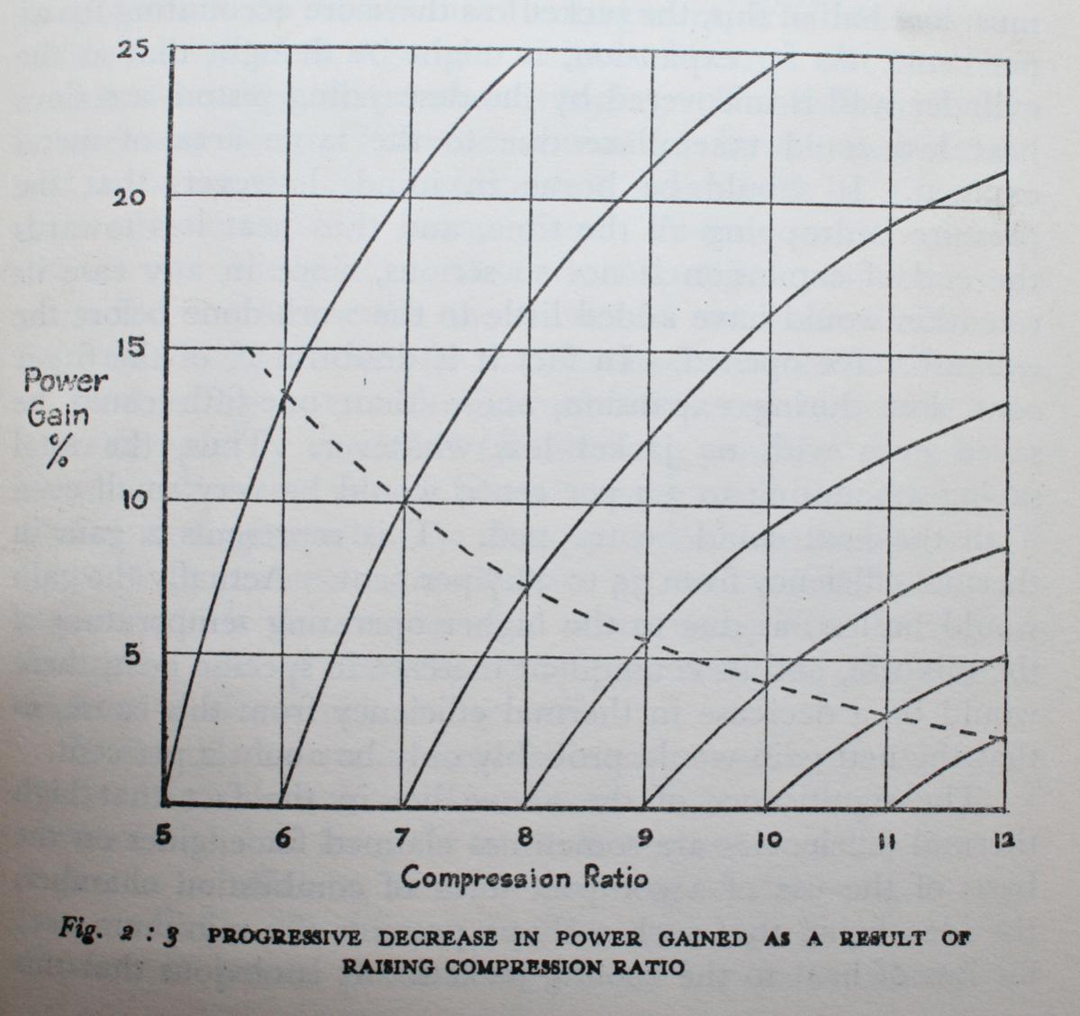

    Some more interesting reading and charts from Philip Smiths Compe***ion Engines book explaining changes in CR and fuel.
    The last chart giving pressures at different CR ratios is interesting. The text states at ignition the pressure raises to 3-4 times the pressure on the chart.
    So next time you think that a so so valve job, ring seal to cylinder, warped head or questionable head gasket is OK look at these figures. A 6:5 to 1 CR when it fires produces 600 - 800 PSI !!

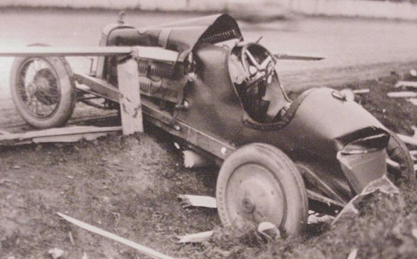

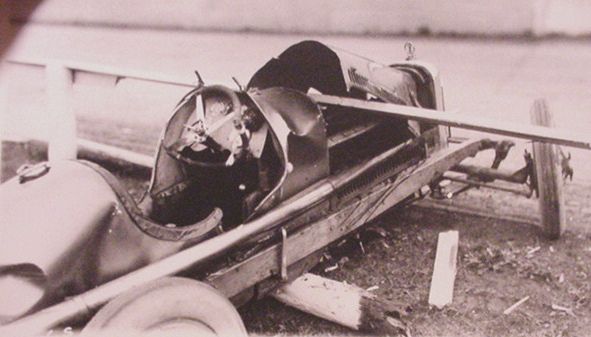

    The37Kid
    The Earl Cooper #2 crashed at INDY in 1925 on lap 127 on the SW turn. He was back in '26 with a FWD MILLER.

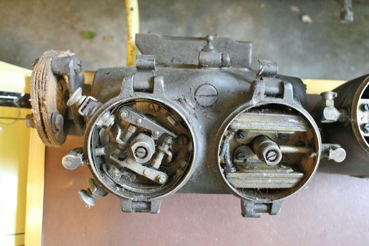

    I am trying to show the average person who wants some more power in the end without all the trouble that is going to come from very high compression. The only way to be safe with a Ford and high compression (over say 8:1) is five mains which is out of the reach of many people.

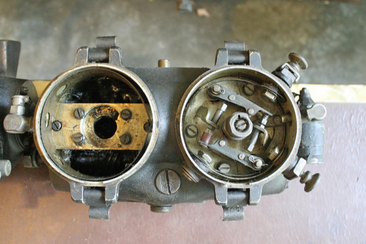

    Jimmy Wilburn, Fort Wayne, Indiana 1938.
  27. Bigcheese327
    Joined: Sep 16, 2001
    Posts: 6,741
    Bigcheese327
    What's he hiding under that rag? Special carburetors?

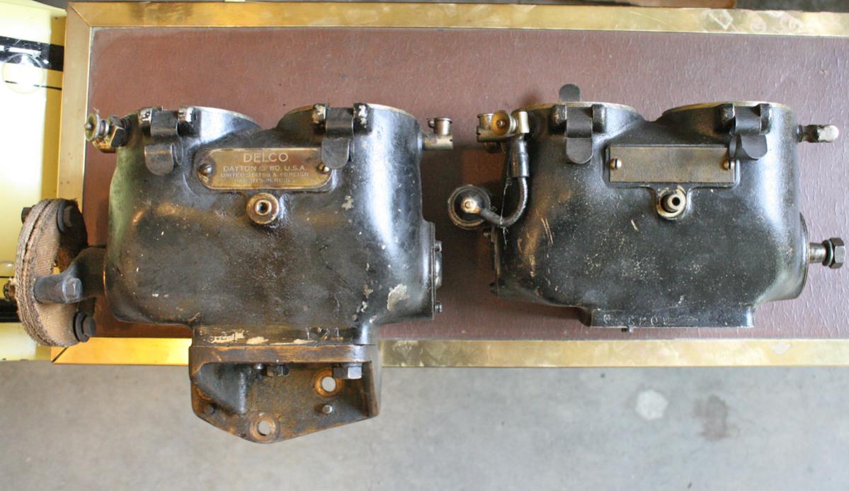

  30. I once worked in a screw machine shop that made lifter conversion kits to convert hydraulics to solids, When the chevy V8 started to gain in popularity we worked on developing a lifter that was compatible with all cam materials. The most commonly used steel for m*** production was at that time known as leaded screw stock now I believe it is 12L15. It was found that if the rockwell was above 65 (file hard was the term used then) that the lifter would work well. 12L15 is not a direct heat treating material it was case hardened. The firm we made them for, Thomas Magnesium later Val Vee Engineering, made up the term "Specially Chilled Steel" This was considered quite funny to those in the trade. Dempsey Wilson ( Clay Smith Cams) did the development as he ran them in some of their boat engines. I remember the boss, AK Ferris, saying that the engine blew at 7 grand but the lifters looked good. There were no engineers involved just a couple of old time hot rodders. The bottom radius was something like 27" laid out with a string and a pencil on a manila folder transfered to a piece of shim stock then which was then used as a pattern to dress a grinding wheel which was then ground on the cutoff tool and polished by hand, Many years later I ran diesel injector cam followers out of 86L20 which is a far better material as the internal structure retains a medium strength where as 12L15 has a soft center kinda like an egg. I have considered making new large foot print lifters out of 86L20 but not sure the demand would be there. When I now need a hardened part such as a rocker shaft I use O1 or 41L40 bar ends from my son. I heat treat the parts and then I "soak" them in a lead bath for 1 hour at 800 degrees to draw the part back to around 45 to 50 rockwell. Just some more trivia for you from my cave!
