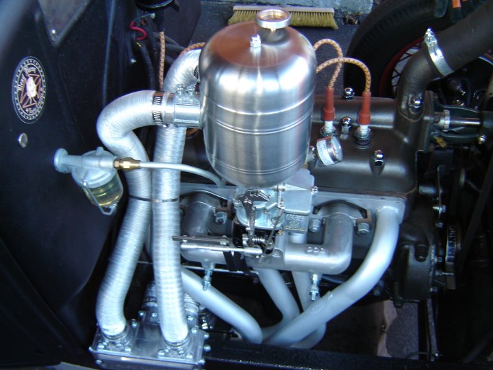

    I also get some black on the plug mostly on the one closest to the fire wall, running a stromberg 97 ( 2009 one ) 5.5 head mild cam, scalded dog header, had major issues with carb icing, fixed it with a new heat set-up check out my post on it.

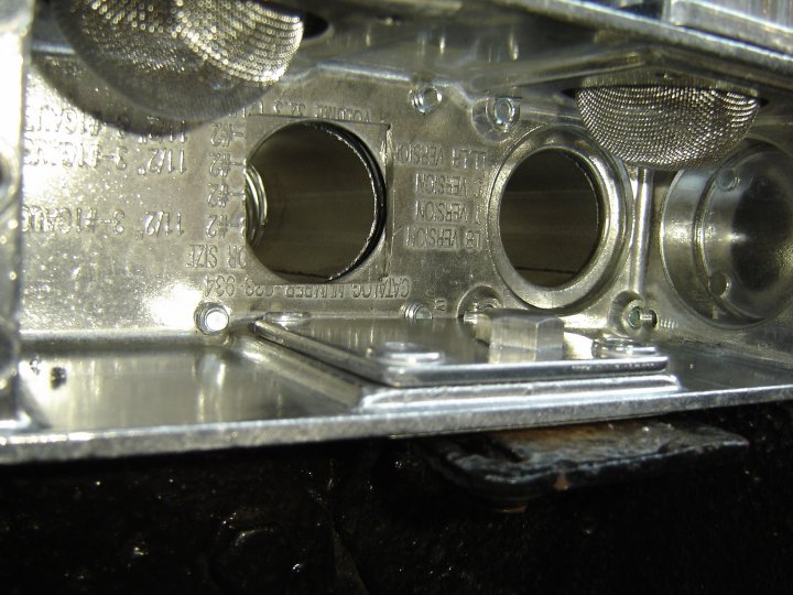

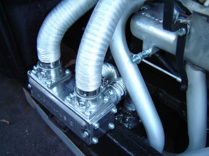

    After running my banger last year and having major carb icing issues i made this heat box set-up ( Munson thermal Regulator ) i had to give it a cool name. I will post more pics and a video this weekend, It keeps the canister on the carb at 115 degrees and the carb base still feels cool but not wet and frozen like it was. Runs much smoother also. no more hesitation and stumbling:D The close up pic is inside the heat regulator it has 2 fine mesh screens made from a tea ball , it worked perfectly, i will post close up pics of everything since I could never find a good solution that looked cool online. i know I cant be the only one with the icing carb problem, By the way there is another heat collector box that fits around the manifold that you can not see in these pics, I will be sure to make good pics of everything soon:rolleyes:
