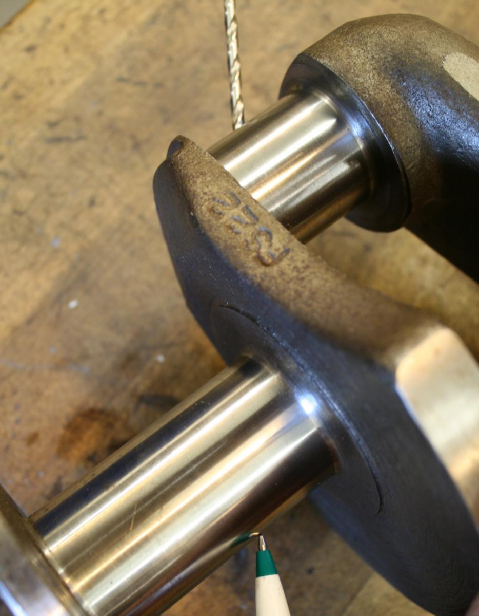

    I'd like to drill my model B crank for oil pressure to the rods. I know there was some plans in a Secrets of Speed from way back. But I can't find it. Does anyone have the angles and measurements for drilling? I know the holes will need to be a bit of center on at least the mains.

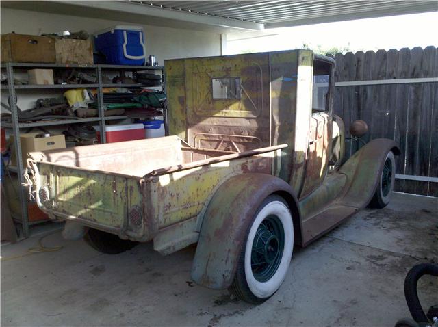

    You guys might have remembered this truck when I bought it about 9 months ago or so. I wanted to keep it patina'd, drop it, and juice it. Well, I just got it on the ground yesterday. Ive been thrashing on it to get it done for the Santa Maria show this year. Im having a few small issues though; the drums seem to spin wobly and the wiring is kinda weird. I turned the truck off, made sure the lights were off, then went in the house to shower. I came out and it smelt like burning diahrea outside. I checked the truck and the wiring cluster was burning! It wasnt bad enough to burn anything, but I definatetly will be pulling the wiring out of it and making a small harness with a switch for the lights. Scary though!

    I have done it several times but do not have the angle measurements handy either. I have also done counter balanced ones. I use the angles in the books as a guide but in the end use the angle that suits the crank, as A, B and "C's" are all slightly different.
    Set it up in a milling machine and angle the head with your drill or a piece of true, ground rod in a collet or chuck as a guide (check to make sure it does not run out at all) and set the angle so that it will not break thru in either radius. I first cut a flat spot on the journal with an end mill and then center drill it. Then drill the hole slowly taking care to keep withdrawing the drill and get the chips out and to keep applying cutting oil. If you are careful you will not have trouble, but it takes time and patience.
    If you want the rear hole to be in the middle of the rear journal if you need it there for the oil supply from the bearing, try this. Drill from the back end forward to intersect the hole to the rod journal in a lathe, then drill another hole down at an angle from the rear main to connect with this. Then plug the hole out the back so it cannot leak.
    Because of the angles involved you will find that the two holes will leave you with an area .375" long on the center main. I open this up as you see in the first photo and feed the oil from the bearing to the center of this area.
    The third photo shows you about where you will end up on the rear main journal (by the pen) if you drill all the way thru and the other two photos show you how to drill it to get it were you want. Again plug the back and when you are all done take it to a good balancer.
    This is a counterweighted B that I have shortened and cut the counterweights down to clear the cam and I cut down the journals and had them ground to fit in a T as the mains can't be much bigger than 1.625" - 1 5/8". It is going in my T with the BB Rajo overhead several posts back. It may look a little different from your crank but every thing else is the same. When you are done the oil holes all need to be champered. I do not use inserts but use diesel marine babbit and keep it thin and have never had any trouble, even in racing applications. While I am align boring I cut the oil grooves for the feed to suit the locations of the oil holes. Just think it all out and take you time, if will come out OK.
