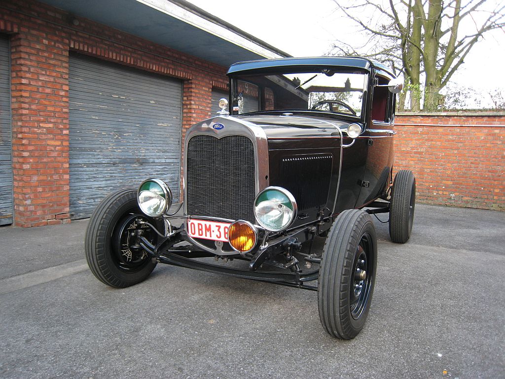

  20. Mine came close yesterday...
    After loosing a spot of s**** metal from outside the garage, I decided to spend the cash I would have made on a security camera. Wireless, motion sensitive - nightvision too. Thus the weird colours in these pictures.
    Checked in today and... that's weird? Someone has moved the A? Except - no other pictures except these two? Nobody seen walking up to, or away from the car? Bare in mind I have quite a few pictures of pigeons in flight - the camera is sensitive enough....
    Any guesses?
    Nope?
    So. checked when I came home. The A is not just pushed against the garage door - it's pushed them in. Hmm? And the car is in gear too? Ah. Reverse. Lifting the bonnet reveals the problem. The second aftermarket starter switch to fail. Perhaps damp? Certainly enough to suddenly connect itself, drive backwards until it hit the door, where it sat until the switch burnt out and the new battery ran down....
    So. Check them cheap starter switches!!! Been dry for days here - the br*** nut on the battery lead was discoloured from the heat, yet I wiggled the starter rod and water came out...

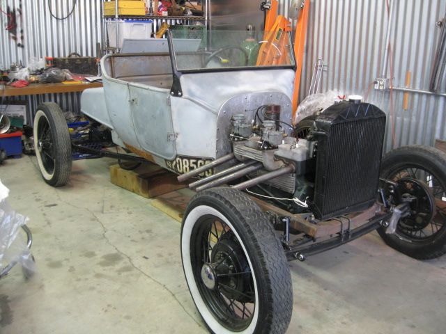

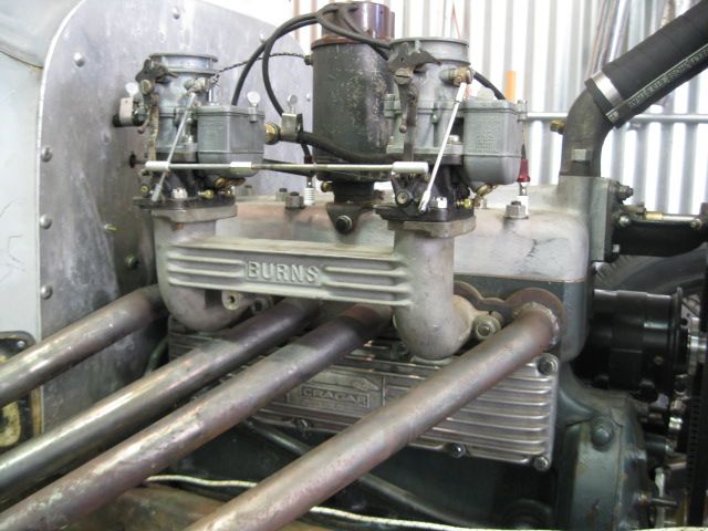

  27. GARY?
    Joined: Aug 15, 2005
    Posts: 1,631
    GARY?
    Here's a couple pics. I'm really excited to get this one on the road.
    The body and frame came from Chris on the HAMB and the rest from all over Oregon, California.
    Repop Winfield head, the rest is old stuff.
    I 'm gonna' have some tuning to do. Trying to run 2 97s on a mostly stock internally A block. #42 jets in there right now.
    Wish me luck fellas!!
