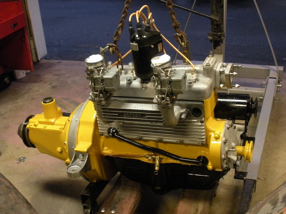

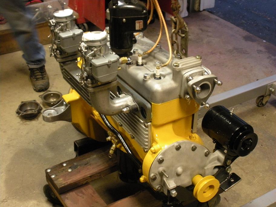

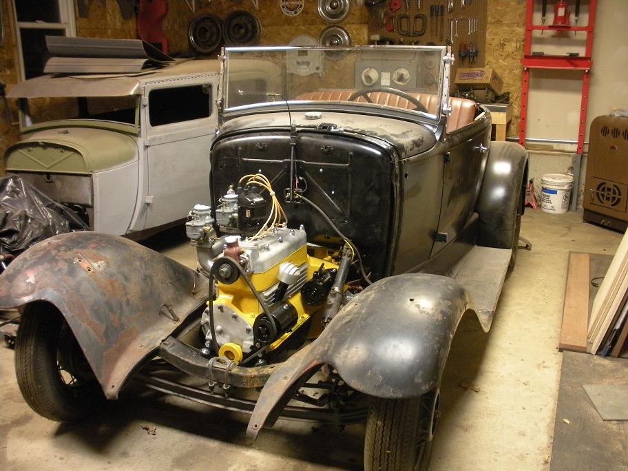

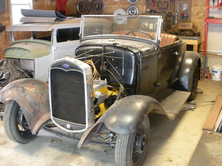

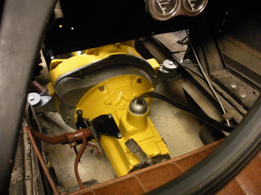

    Below are some photos of the progress we made yesterday installing the motor and trans in my 31 roadster.
    I bought the car last February from a father/son who had pulled it from a storage container in long island NY. As the story goes, it had been sitting +/- 30 years in the container at a salvage yard. The father son had bought it to restore but decided to sell last year. I bought it with the intent on getting it mechanically sound enough to drive for the summer (2009). New brakes, rebuilt rear axle, steering, ignition, wiring, etc. etc. This all took longer than hoped but by early September we were ready to make some shake down runs. The motor had shown good compression in the drive, idled and yard ran well, but started ******* oil out the rear on the first drive when we were really able to put a load on it. Like most projects, plans changed.
    Around the first of this year a friend of mine found in NH the motor you see in the pictures. The motor had been built in the fifties as a hot banger motor, lost a piston, and slid under a work bench. The motor had pressurized mains, larger exhaust and intake valves, porting, hot cam, super winfield head, wico mag. The engine was gone thru this winter/spring with new pistons, adjustable lifters, the crank counter balanced, lightened flywheel, modified the oil pump and added the intake and carbs.
    Yesterday we put the two together. The trans is a rebuilt 39 and we used the clings adapter kit. We also used the front and rear floater motor kits. All of these kits are good quality and aside from us working thru our own learning curve with these kits, the install went together pretty smooth.
    The aluminum timing cover and finned valve door cover are our castings and for sale if anyone's interested. The plan is to drive the car this summer with this motor while I finish my B motor and my friend finishes a lakes modified to put this motor in.

    That is awesome, looks like a part B, part v8 kind of deal, I like the dist off of the end of the cam idea, looks like it used the early v8 flywheel too.

    Rockman, that motor and ****** look great !!
