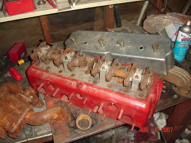

    finally back in the world of bangers. scored a C motor a while back, and have not got around to it.
    Just moved into a new house, with 1,000 sq foot shop down stairs. room and freedom!!
    so, i spent some money and bought a mallory distributor from Chris. need to find a dual intake/ carbs and get a cam ground (will call Mr. Elgin).
    Got a line on a 26/27 roadster body, so...we see where we go.
    anyone have a spare '39 box? i am thinking late 40's/50's time machine with a belly ****on nose (doosh shell).
    going to start tearing into the motor and see what i have got.

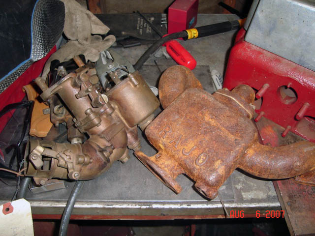

    ooo..spent some money...but need more parts...why always need more parts?
    anyone have a pair of frog mouth carb tops they would like to part with (need to fit 94's) and a '39 box :)
