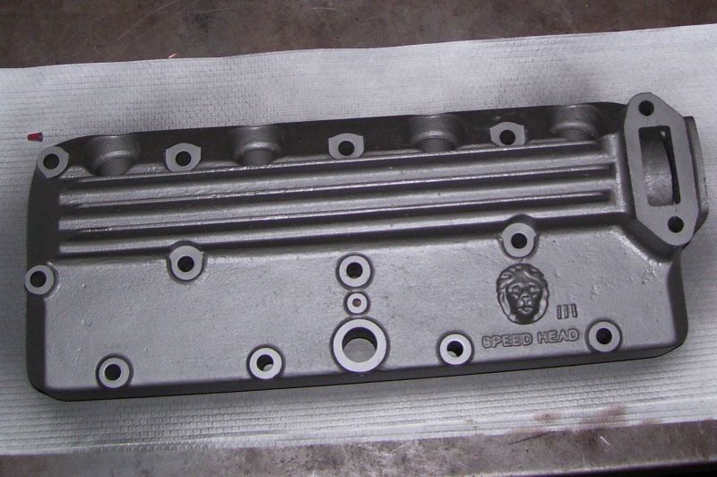

    I'd say there's a few guys here who'd like one of those valve covers ;)

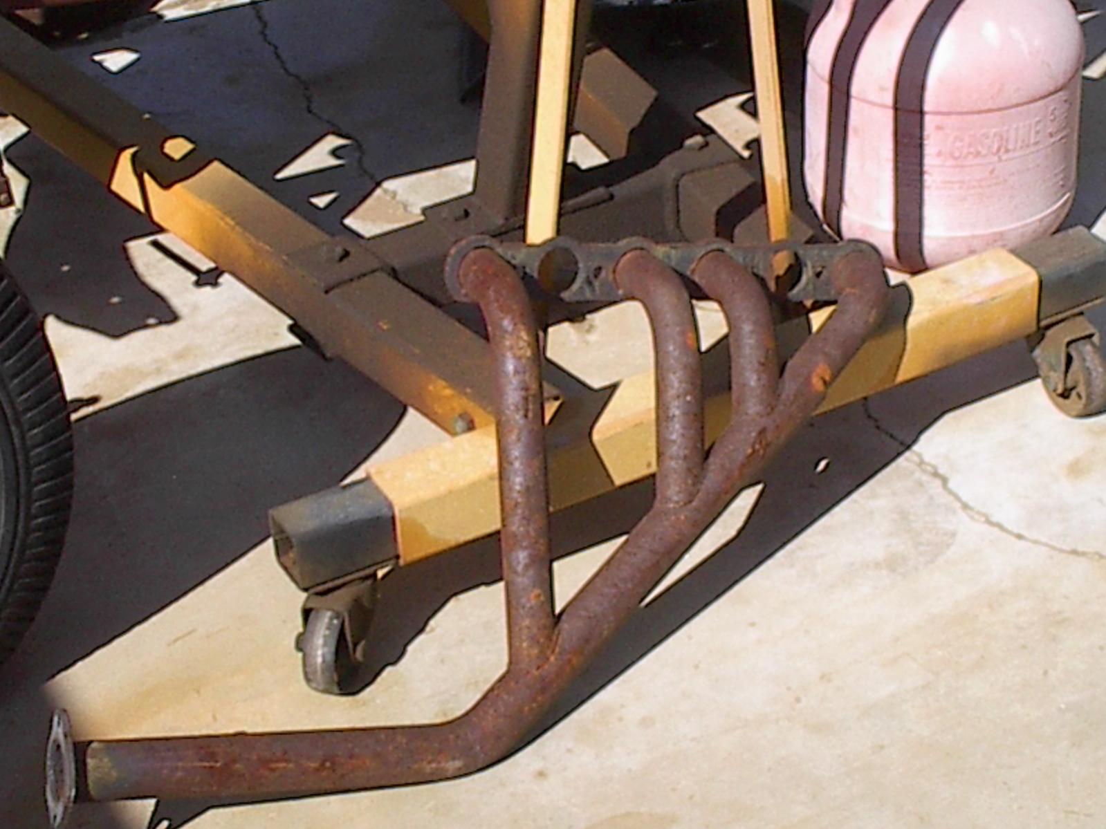

    Here is a header from 1939 issue of Ray Kuns Automobile Racing.
  4. The stock muffler is rather restrictive. I think the exhaust manifold works okay especially with the Aries muffler which has larger tubes in it and was/is dyno tuned but is "pricey". A straight pipe would help. I think it is similar to a Volkswagen as the restrictive exhaust limits the RPM and torque. I have a header similar to the one in the photo laying around somewhere if you like the original look. I would swap it for something.

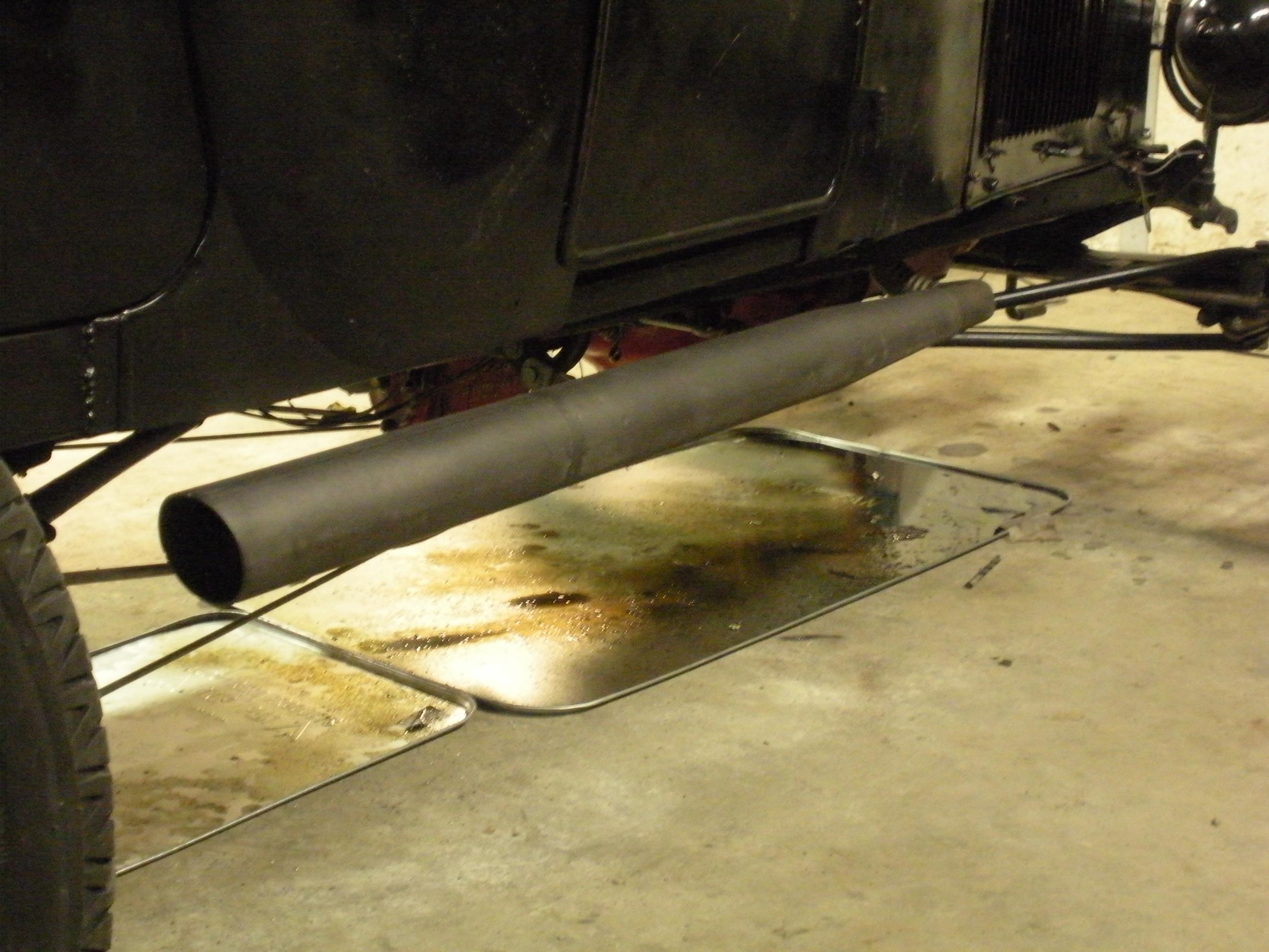

    Chris,
    I did the same thing on my '26 T. I originally had a gl***pack on it but it was too quiet....So I agree, they sound weird without a decent "Bark" :)

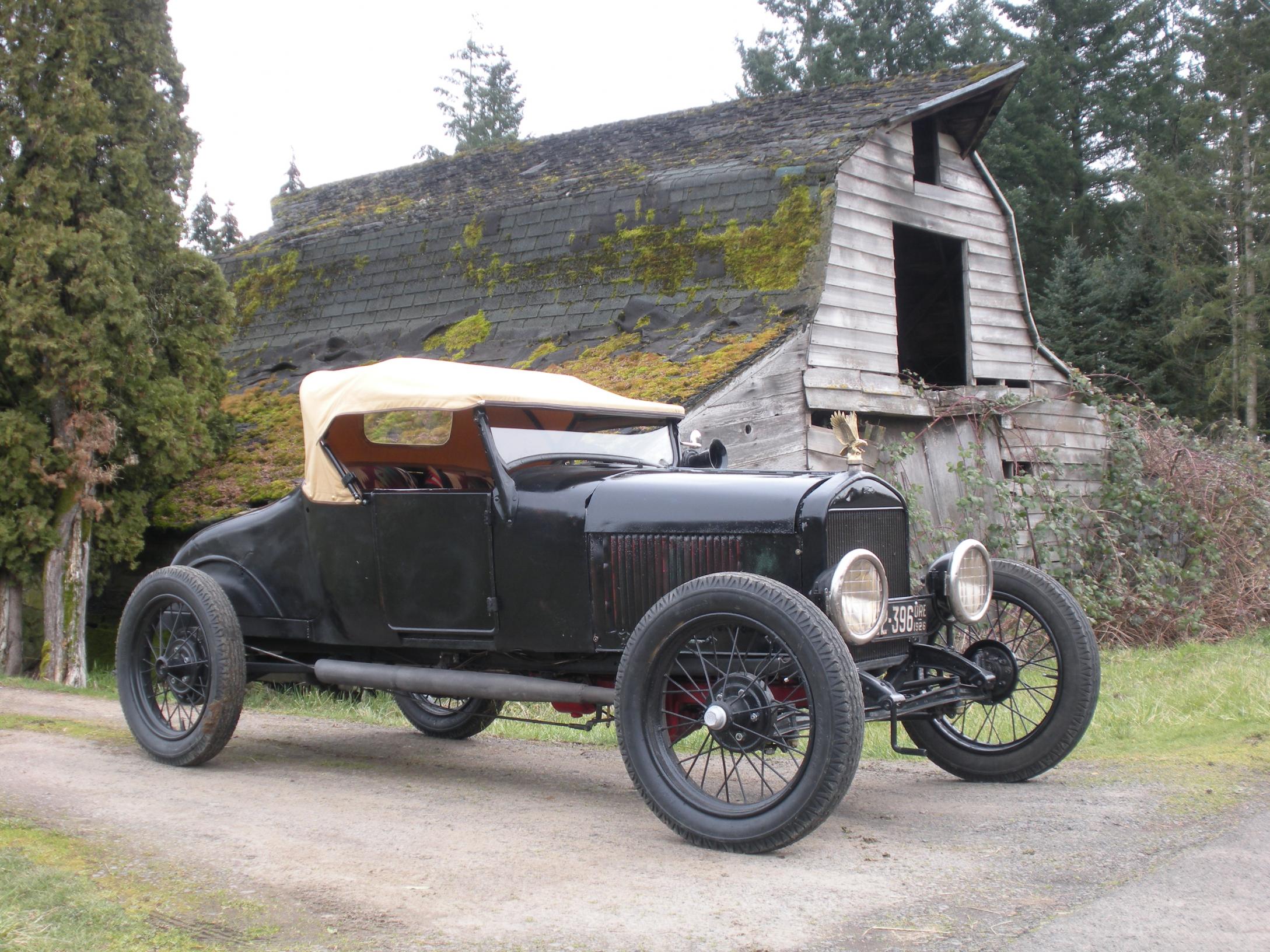

    sweet ride (MR. T)
  12. Chris
    Joined: Jan 5, 2005
    Posts: 14,500
    Chris
    That is one of the most *****in T's I have ever seen!! Got anymore pics???
  13. Chopped50Ford
    Joined: Feb 16, 2003
    Posts: 5,854
    Chopped50Ford
    Alliance Vendor
    MrModelT....awesome looking roadster. You have to post more picts :)

    Thanks to all!
    That is exactly the look I was going for: 1930 to '33 early dry lakes "Gow Job". I was heavily influanced by the "Multy" Aldrich and R.Hodge Ts, so I based my roadster on both. It is a blast to drive. I eventually plan to refine her with all the correct period speed goodies as someone my age in 1932 or so would have done.

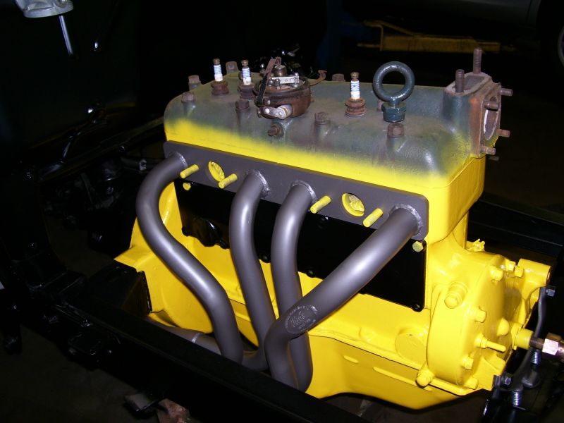

    First a new Brookville RPU tub and bed. The "phaeton" tub I've been working on still needs a lot of work and I want to drive it this summer. So I picked this up - may sell it in the future, may just build another car....
    Next up is the new header - straight from Salt Flat Matt at Geardrive.com. Great price and it fits perfect. I did the measuring and figuring, he did the hard part. It was mounted up within 10 minutes of me getting home tonight!

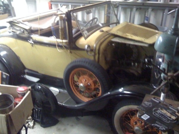

    Got to spend a little time with the 1930 cabriolet last night. It's been dead for a couple years now, started having parts borrowed off the engine, went through a move and basically has been sitting patiently in the corner.
    About a year ago, after spending all day rebuilding the carb, leakless water pump, adjusting brakes to get it on the road, I went to turn it over and heard a POP inside the engine. I found that my distributor had rusted solid and wasn't in the mood for getting the spins. I threw in the towel, shut the door on it, and kept working on the coupe.
    Last night decided to open up the engine and found that the distributor drive off the oil pump had sheered the roll pin through it. It also had a lot of wear on the drive teeth. Had another drive gear, made another roll pin from a nail that fit perfectly, and put the valve cover back on. Got another distributor and converted it to electronic ignition, stabbed it, set the timing and hopped in. The old girl jumped to life on the first crank! A few more things to ****on up, but hoping to drive it to a Model A meeting this Sunday!
    Just happy to hear that little banger purr again!

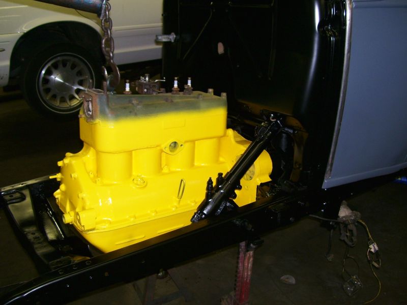

    Here's where I am so far. I should be on all fours next week.
