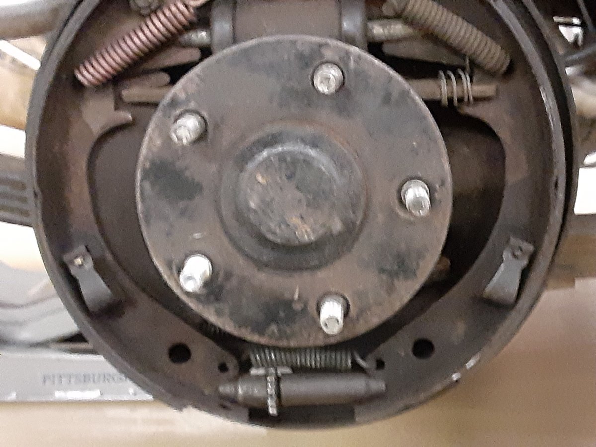

  7. When I picked up my 210 this week from the frame straightener, he pointed out one of the wheels was sticking/hanging up making it difficult to move the car around.. which I then noticed as well. When I got the car home, I figured out it was the right-rear wheel, so I pulled the drum. I had remembered reading about how the car moving backwards (re)adjusts the brake shoes. I watched a video on youtube about the 60's era gm/chevrolet self-adjusting brakes. When I pulled my drum, I noticed some of the parts in the self-adjuster video weren't in my assembly. I used a pair of pliers on the star wheel to close up the distance between the two shoes. This allowed the wheel to move freely again through it's full rotation. I'm sharing a photo for those in the know, to see if anything may be out of sorts...

    Absolutely NO self adjustment mechanism there. There would normally be a lever and spring that contacts the star wheel, a small cable with a guide/fulcrum, and a loop on the opposite end that goes over the pin above the wheel cylinder. Self adjusting brakes were a later feature and not available yet on 56 Chevrolet's. They can surely be added however. I am Butch/56sedandelivery.
  9. Agreed. I hadn't worked on a brake before yesterday, so I thought the star-wheel itself was the majority of the self-aduster. I spent the rest of my evening studying the video I mentioned, and looking up self-adjuster kits on the web. Found a high of $47 for rears only, thru Danchuks, and a low of $7-$8 a wheel thru RockAuto.
    Anybody have any idea why the star-wheel had spun so far out as to almost lock the shoes against the drum? When I pushed the car out of my garage and onto the U-haul auto-transporter, to take it to the frame straightener, it moved easily. When I arrived there we had some trouble getting it off the trailer - may have been the sticky wheel. I had strapped it down at the rear-wheels, backwards on the trailer, since the majority of the weight was at the back of the car.

    With the rest of the other parts missing the star wheel can move on it's own maybe vibrations during the trip turned it.

    Wheel cylinder stuck further open maybe?

    It might not be the star wheel at all, the way they were designed, the lower spring locks the star wheel to hold adjustment. It might be a damaged parking brake cable or frozen brake lever giving the problem. Just a thought... [emoji848]

  13. Hmmm... you may have something there. Because there is no driveline in the car, I was using the emergency brake alot while transporting the car to & from the frame straightener.

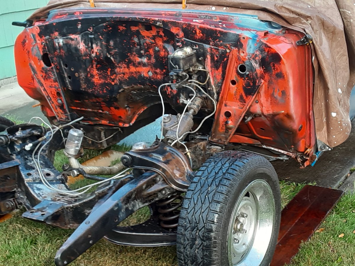

  16. So, today was pressure washing phase 1 - Before I strip the front end I wanted to get the bulk of the grease & oil film off everything. I bought cans of oven cleaner at the dollar store, like suggested in other threads. I had done a little bit of pre-scraping to get the little bit of caked grease off. I used two cans of oven cleaner on the firewall and chassis spraying generously into all the nooks & crannies I could. Even working outdoors with a light-breeze the oven cleaner fumes weren't easy to avoid and are strong. Also tried out my new Ryobi 3100 pressure washer I bought at HD last week. I let the degreaser set for 30 minutes and it had dried in some places. Everything went pretty well and I'm pleased with the general degreasing. The pressure washing even blew some of black & blue paint off the firewall exposing more of the original '56 Matador Red.
    Next, I will pull everything I can off the frame forward of the firewall, and do another piece by piece degreasing, before I start prepping for firewall & chassis paint.

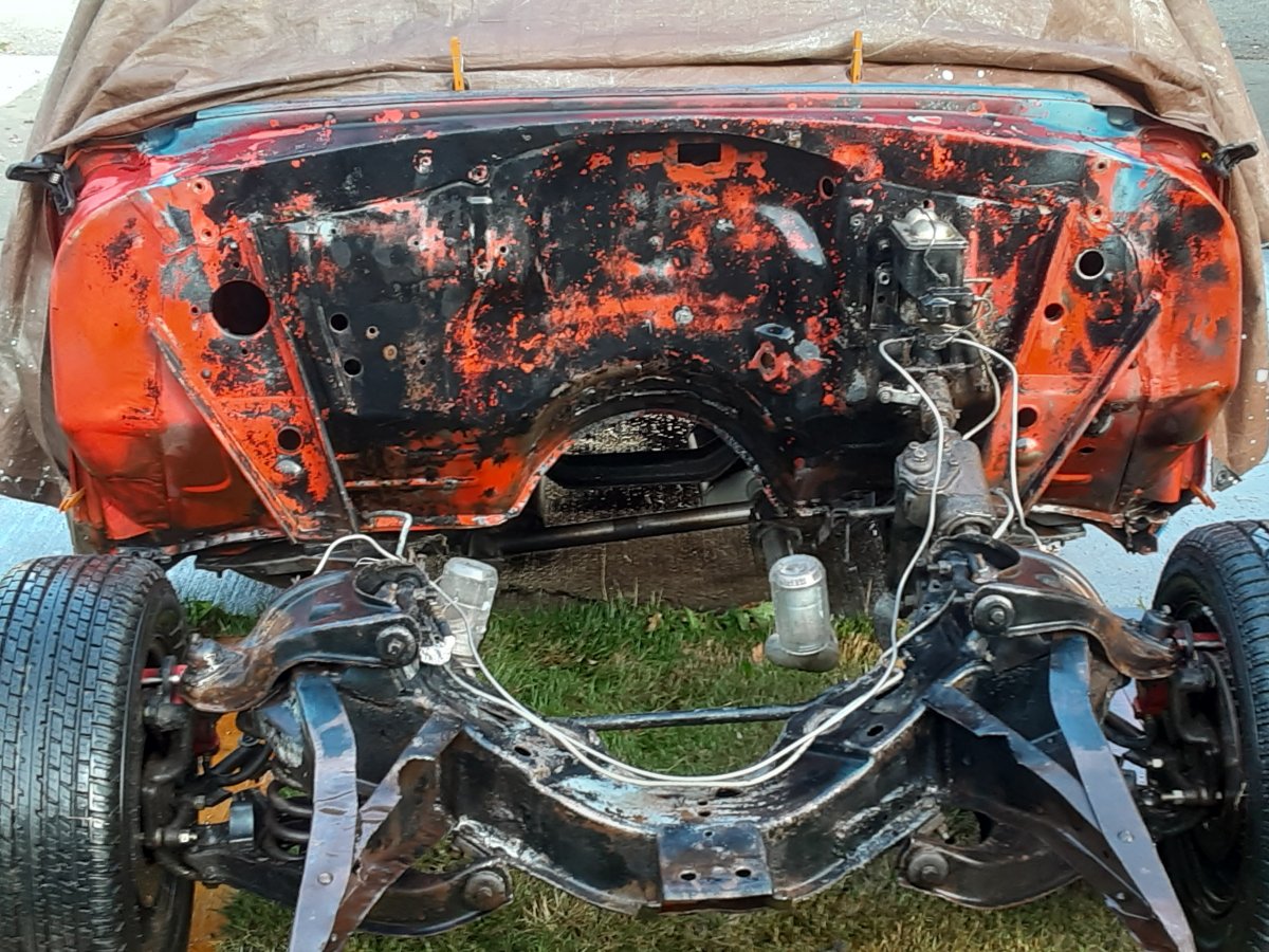

  17. Here's the latest... pulled the steering wheel, steering mast, master brake cylinder and front brake lines Friday & Saturday. Just need to pull the front suspension apart now, to have the front completely stripped. I haven't had a chance to read my '56 shop manual yet, but I'm wondering if all I need is a pickle fork and coil spring compressor for specialty tools, for those of you who have been down this road before.

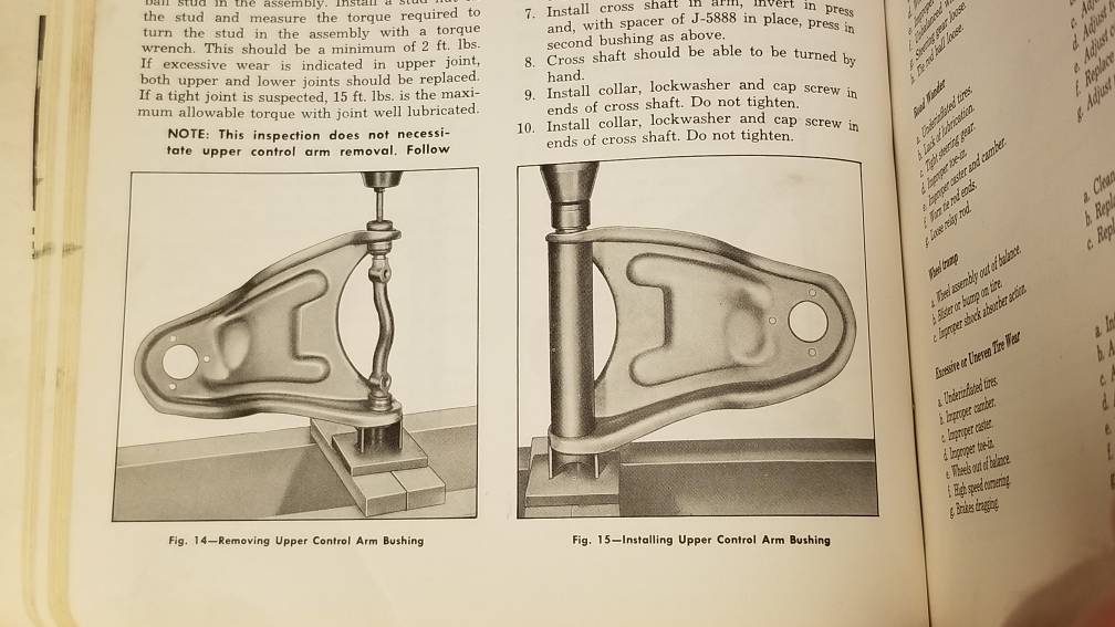

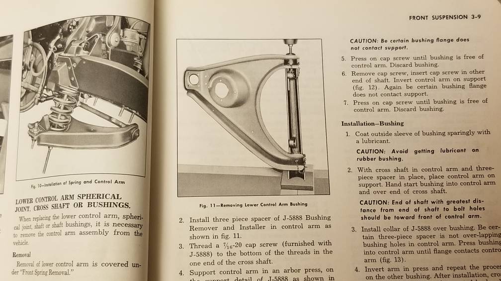

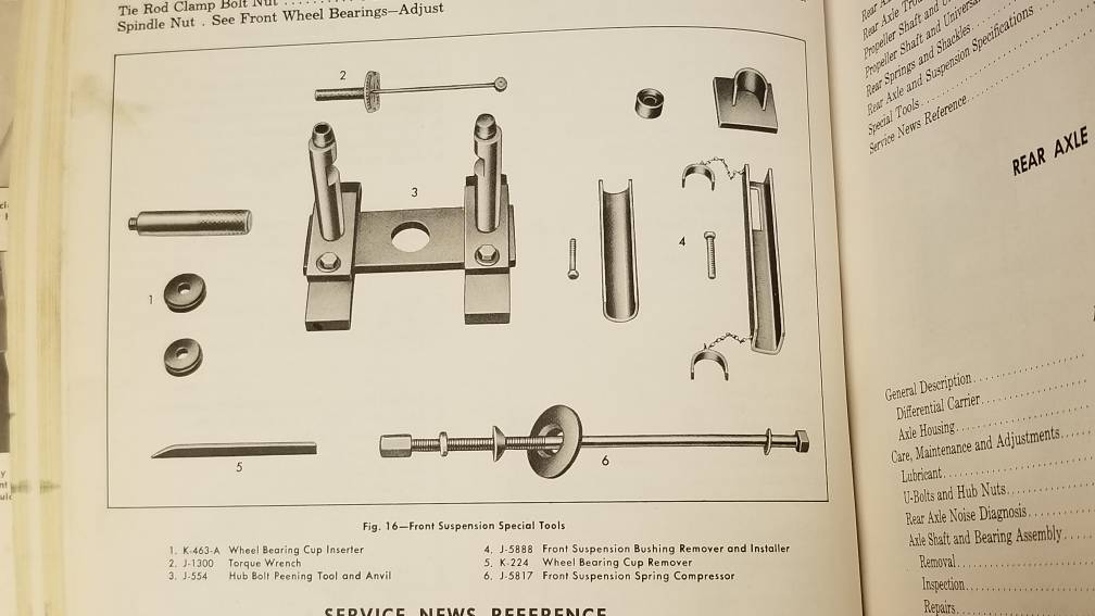

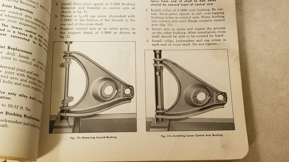

  23. I'm planning on replacing all the bushings in the front end and maybe some ball joints. Tie rod ends look low mileage. I have a 20T shop press, but you mentioned a specialty tool for the bushings. Any guidance on choosing the right tool for bushing replacement? Just may help me fill out my Summit order so I can get to the $99 free-shipping threshold...
  24. 427 sleeper
    Joined: Mar 8, 2017
    Posts: 3,305
    427 sleeper
    The main pieces you're going to need are the supports for between the control arm bushings. They're not really needed although they are recommended and can easily be made with a scrap piece of pipe with a large enough ID for the bushings to pass through. Cut it so it fits between the ears of the control arm, and then cut it in half long ways. This is only really needed on the install process. For removal, just press the shaft down to push the bushing out of the arm, flip and repeat. You're probably gonna need the help of a torch too, after all these years, but try it without heating the arm first. If it seems like it's taking alot of pressure to get it to break loose, keep the pressure on and start heating the arm around the bushing and it should break loose.
    Her are some pics of the dealer service tools so you can judge for yourself what they are supposed to look like and how they're used.
    Hope this helps, Jedd 20191104_190846.jpeg 20191104_190903.jpeg 20191104_190943.jpeg 20191104_191001.jpeg

  26. Many, many thanks for the clear, concise reply - that helps!

    You also might consider some offset cross shafts for the upper arms to get some extra camber adjustment. I think that they give an extra 2° positive camber.
  28. I'll look into those. When I googled the j-5888 tool, I came across some web-links with dimensions on how to make the needed tools out of scrap square & round tubing. Seems easy enough, just will need to track down some the right dimension scrap - thanks again!
