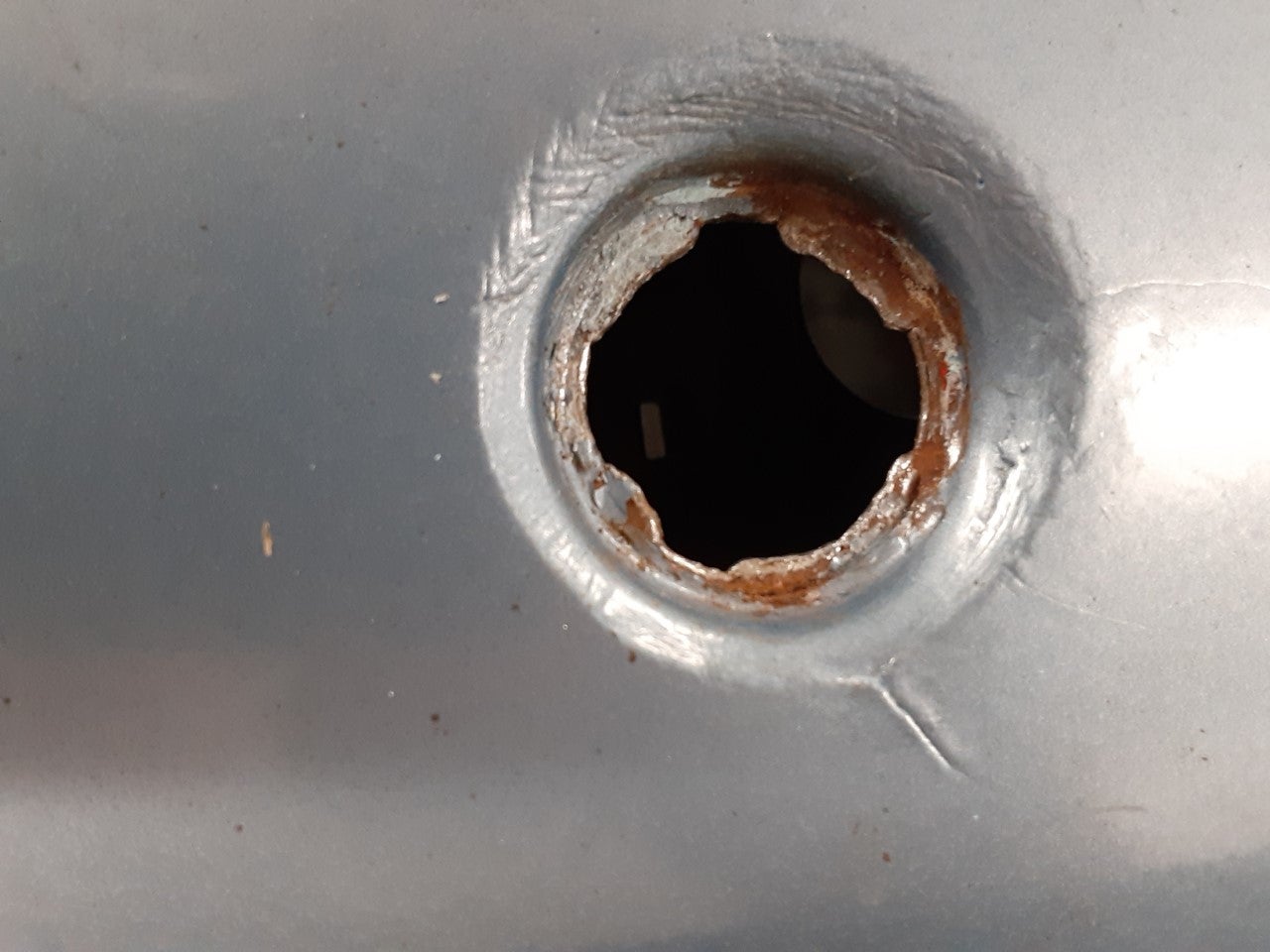

    Before I bought my car, someone punched out or wallowed out the factory trunk lock hole on my '56 210. I only noticed it when I purchased a match set of locks to go on the car as all the existing ones were mismatched (one was even from a Camaro, the PO told me). I found the wallowed out trunk hole when I went to put the new lock on as the PO had jerry-rigged a lock to stay in the hole. But, I buggered up the jerry-rigging and the hole was so messed up, the lock cylinder would just rotate in the hole when you turned the key. So I set out to fix it.

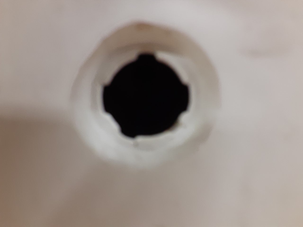

    I didn't think ahead to share this with anyone so I didn't take a starting photo. The hole was so wallowed out, you could hardly tell it had 'teeth' to clock the lock cylinder firmly in place. The first photo of the white trunk lid, is an unmolested, factory stamped hole, which I referenced for fixing my 210 HT's trunk lid.

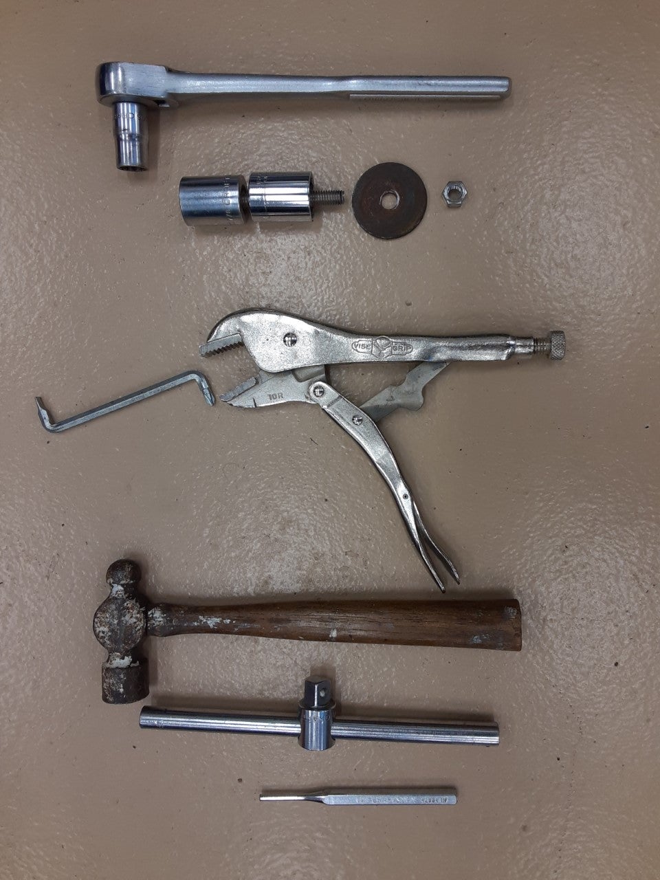

    The next photo is the trunk lock hole after I roughed it into shape using a ball peen hammer and punches to fold the clocking tabs back into approximate position. I could only get so far with the hammer & punches, so I turned to my impromptu slide hammer (vise grip and right angle screw driver). I was able to get the shape pretty good and the lock cylinder clocked properly and stayed in place when turned, so I called it good... for a couple days. But the very wavy clocking flange must have been eating at me, because...
    This morning, I couldn't sleep, and out of no where the thought came to me to press the clocking flange using opposing socket bases as a... mandrel? (I'm a novice metal worker). So I took 7/8" sockets base to base and threaded a bumper carriage bolt in them (1 socket behind the lock hole, the other in front of it) I then used a large flat washer and nut to draw the two sockets tight against each other to flatten out the trunk hole clocking flange. It worked out pretty slick.
    Does the repaired lock flange have the same snug fit as the factory stamped hole? No, but it's miles better than before.

    Repurposed tools used:

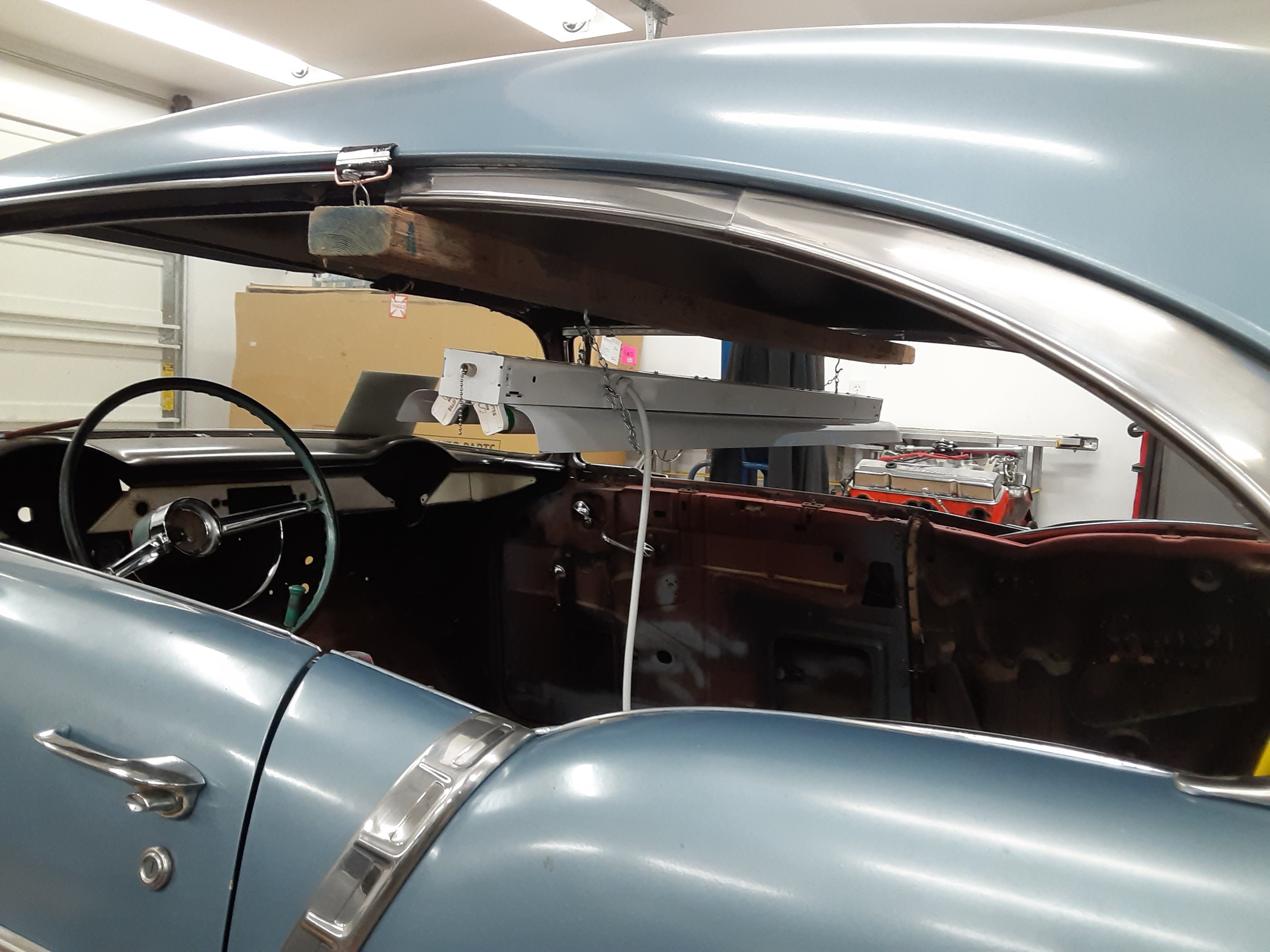

  11. quick update...
    Yesterday: hung a 4ft light fixture inside for my floor project.
    Today: 2 words - spotweld cutting.
    That is all.
