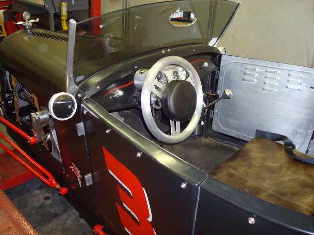

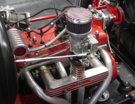

    Finished updating my Zipper lakester with new steering wheel and replaced the Mooneyes EFI with one of the British 97's. Also reworked the stock A pedals, replaced the powered coated red fuel tank with a spun aluminum and put some spun aluminum Raydot Cobra side mirrors to tie everthing together.

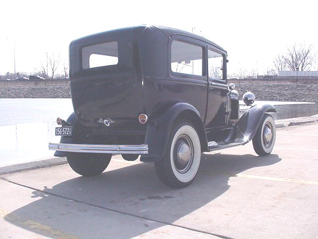

    Banger in the water:D do I **** at taking pictures:D

    That is one mighty handsome Tudor you got there, John :D:D:D
