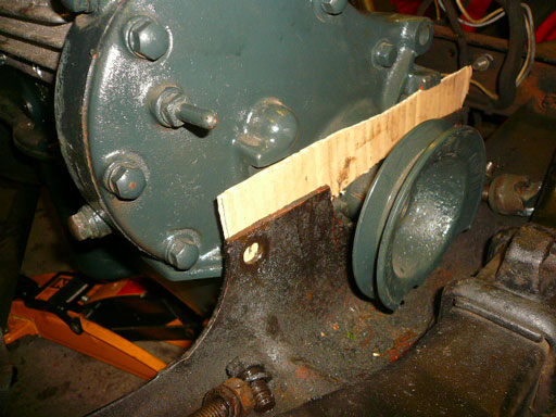

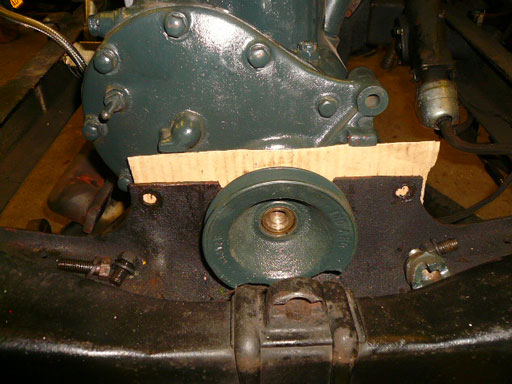

    This is my problem
    any options would be great :(
    I am not sure I can change the timing cover plate - I do not think it is as easy as that.
    I am sure the model B is different to the A
    any help would be great
    I do not want to cut the cross member.
    red cover is model a

    maybe I could make a model B style mount like the one in the picture - cardboard template. as per pics?
    But the engine is now slightly raised at the front if I do this

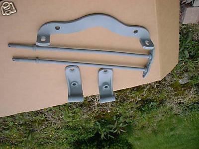

    Ok I have found a mod on page 401 of FORD Model A car by Page - I will scan and post.
    The mod suggests to cut the cross member and shows how to fit a standard later model a mount.
    But then the problem is that the standard model A mount does not mount up to the Model B mounting holes.
    I may have to make a plate simular to the model B mount.
    or buy the upgraded front float-a-motor kit and then weld on some tabs to it so it fits the model b mounting holes.

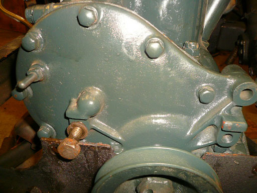

    Simon,
    Firstly the ch***is is a very early "AR". The front crossmember was taller to allow the engine to bolt directly to it.
    This was found to cause excessive noise and vibration to be transmitted to the ch***is. Also I believe with the flex from the ch***is fighting the solid structure of the engine the ch***is was prone to cracking.
    Ford recognized this and changed over to the sprung front mount early on in production and also updated the dealers through the service bulletins stating that all cars in for a service should be changed to the new style mount, an early factory recall if you will!
    I've a copy of the Ford instructions for this which involved cutting the lip off the crossmember and drilling new holes.
    Moving on...

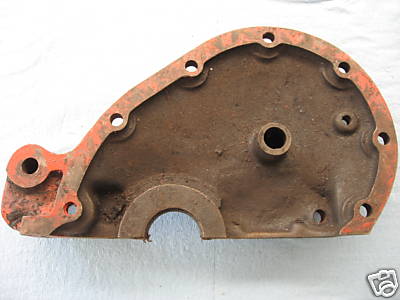

    Your problem is the front timing cover. I don't know what it is but its not 'A' or 'B'!!
    This photo shows a conventional front engine cover, the one that was removed from the car?
    The mounting ears are in the very bottom corners of the mount.
    Now compare it to the the cover from the engine your trying to fit to the car.
    The mounting ears are not only a closer together but also alot higher up the cover as well!
    So much difference in position that the left side mount is joined to the cam plunger!
    Also notice the extra support ribbing on the odd ball front cover.
    Simple solution... Fit the 'A' front cover from the engine you just removed. A 2 minute job that doesn't even need the engine removing to do.

  23. http://idisk.mac.com/forever4/Public/pages/timingcovers.htm This is site, if you can open it, that has photos and explains the changes in the timing covers. The cover with the elongated boss for the timing pin was used as a replacement after 1932 on both "A" and "B". The difference is the location of the hole. It also shows the difference between the early 28 cover and the later "A" cover. It appears that if you choose to use the later "A" or a "B" cover you will have to modify the crossmember.

    I tried to view all these on Vince's site earlier but the link was down. Emailed him saying the link didn't work as I had a hunch that the odd ball front cover was a '33-'34 one.
    Now its back up.... Weird...
    Looks like Simons cover is a '33-'34.

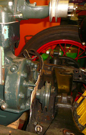

    I have an old mod for the ch***is in an old book I have from 1930
    here are some more pics of the build
