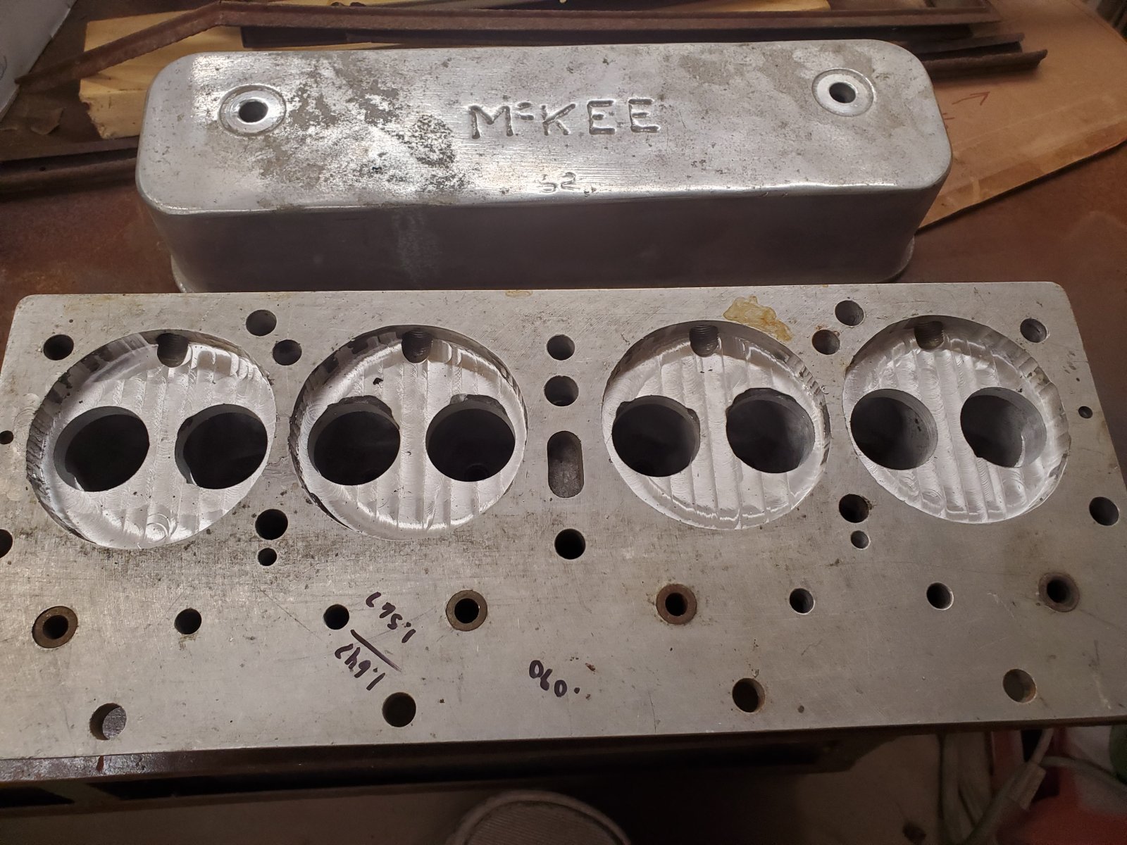

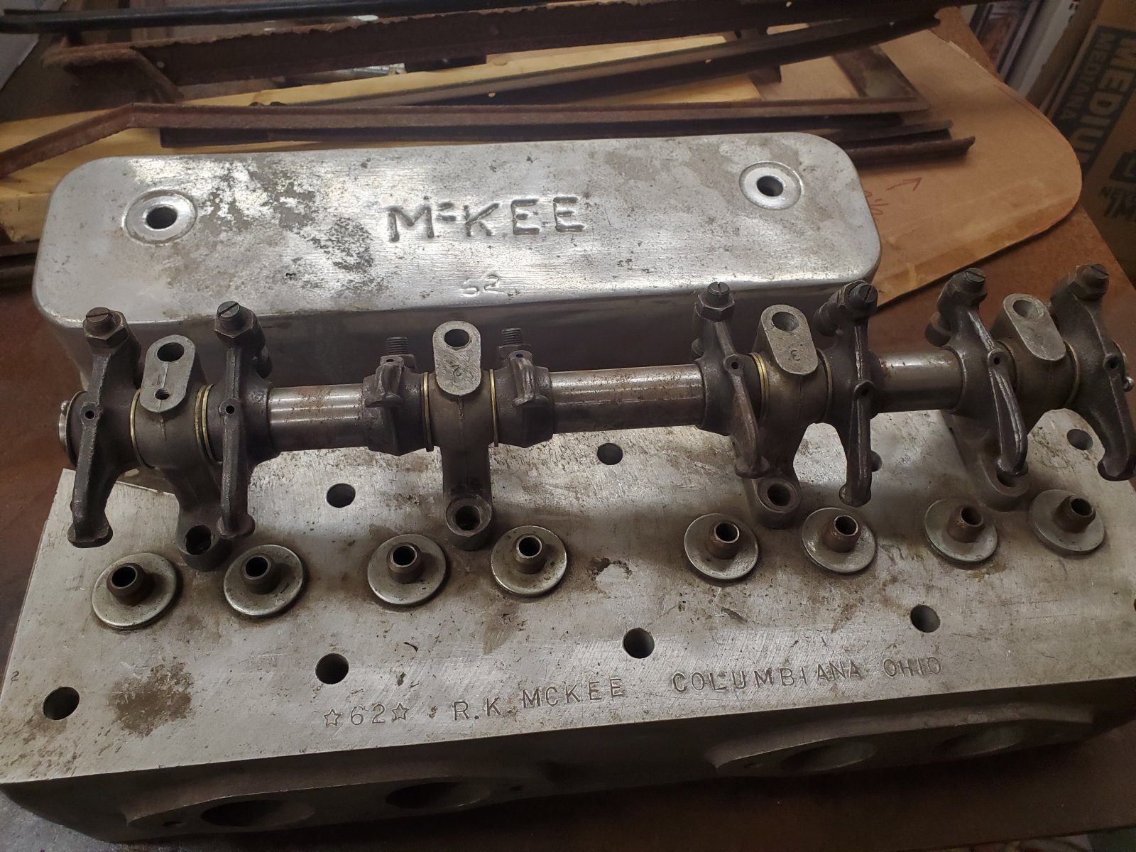

    I bought this Mckee head several years back and sold it to a friend that had to have it. Now i had to have it and got it back.
    Looking for any info i can get on it. The head is missing valves and could use some machine work in the valve seat area. Dont think it was ever finished and run.

    Do you suppose that it is serial number 62 from the Star 62 Star? Kind of like how Henry had the frames numbered.

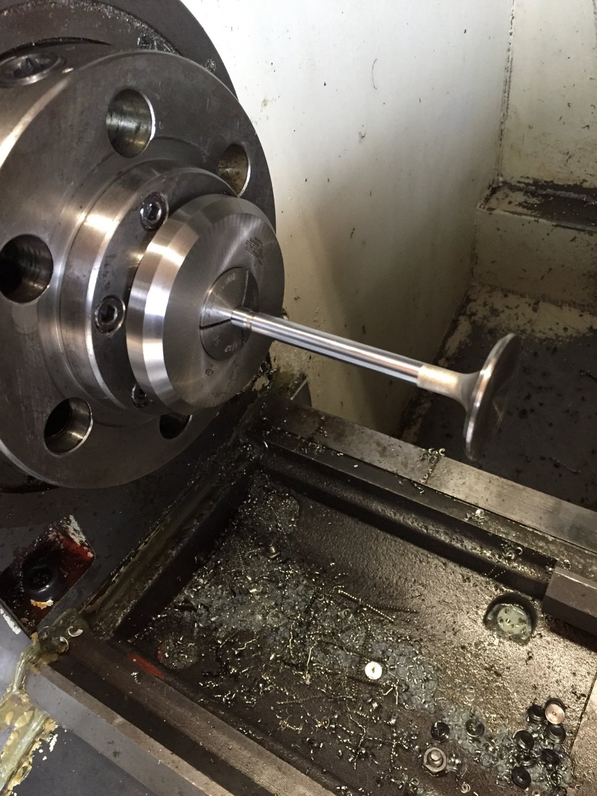

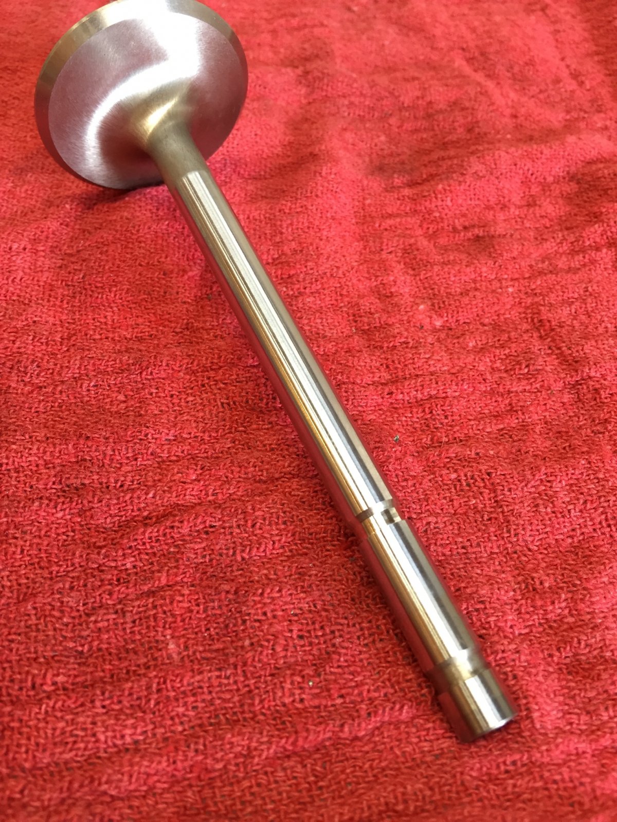

    Finding valves can be a pain... I always go straight for the Manley book to find something close. Avoid cheap valves as the chrome stems and stellite tips are important for longevity. Materials are important too, unless you like doing valve jobs. Springs seats can be spaced up, and keeper grooves can be recut further down. Manley has custom order options as well... get almost anything you want for $25 bucks a piece. May not have stellite tips or be ***anium... but not too bad for special order!
    Here is the extra keeper grove I had to cut for my banger O/H. No sweat for a carbide grooving tool!

    Yes i would think the 62 is the serial number. Its on the valve cover too.

    Clark, do you know about Thinbit Co. for carbide grooving tool bits? Their stuff really woks and is way cheap, at least the last I bought from them.

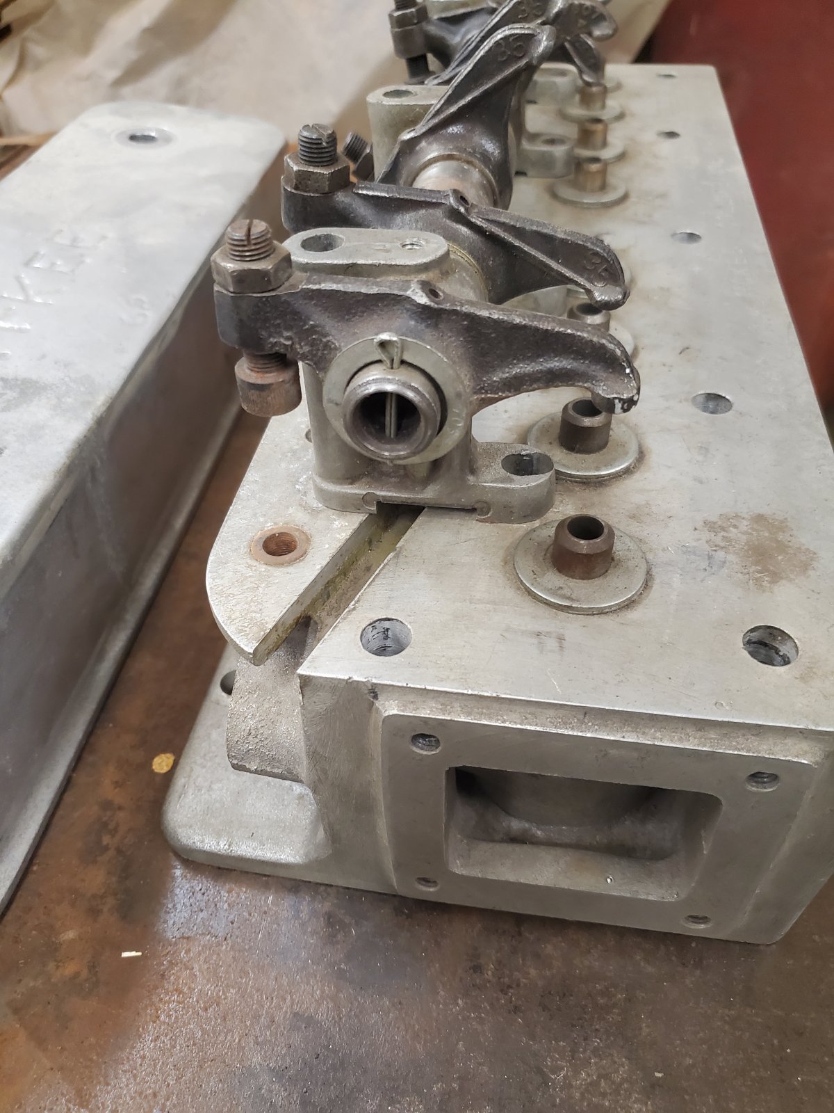

    Have any pic's without the valve cover?

    Ya won’t need pop up pistons with that thing!
    Whats with the groove in the head under the front rocker tower...? Clearance for a rocker oiling tube...?

    Yes the groove is for rocker oiling. Not sure how they went about it

  18. Does each rocker have a groove? It looks like there is a boss that may be drilled out in the bottom of that rocker? Like where a line would run? Similar to the spray bar on my OT L24 6banger

    I think he was talking about the deep groove in the head itself. Not sure about the individual rockers

    Thanks for posting the head pics Clark. Looks like someone used a bridgeport freehand to cut the CCs.
