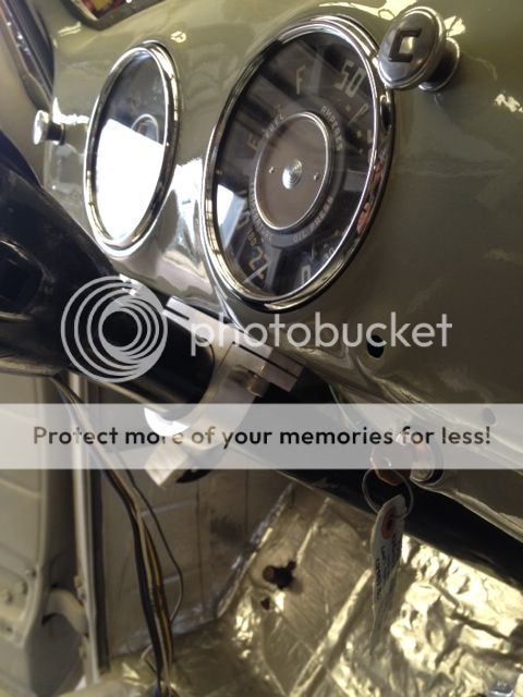

  11. Gramps drew up what we wanted for our column mount and took it along with a block of aluminum to a good friend and he made our mount for us. I'm really happy with how it turned out.
    He's gonna take it back and have a small section cut out of the underside so that we can put the factory wire cover back on and run the wires down the column.

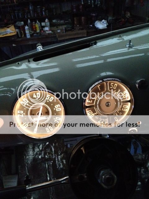

  13. This was the first time we've hooked up the battery since doing any of the wiring. Stereo fired up and really sounds good for only having the 4 small speakers. Wipers (Electric kit from Classic Parts) worked like a charm, and gauges lit up nice. It felt so good to turn that key (we're using the original key and a hidden push button start, instead of the pull device we made earlier) and have all that stuff work right. A big thumbs up for rebel wire. If I get to build another, it will have a rebel wire setup in it just like this one.
  14. We also managed to get the steering pretty much figured out. We just have to pull the column one more time for the cut in the the mount and then we'll be ready to mount our support bearing and hook up all the steering.

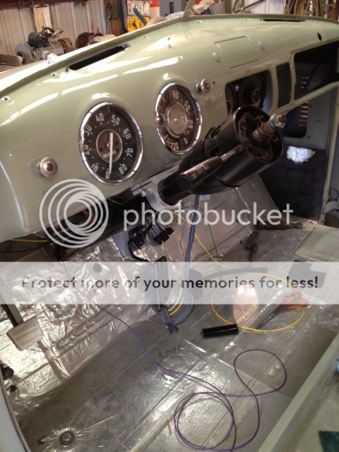

  27. Made another trip down yesterday to work on the truck. Had to make a little more progress before the potential snow storm later this week. Steering is all together and welded up. Wheel turns really nice, and even though there isn't a ton of clearance all the angles look good and have enough room to operate.
    We also hooked up the shift linkage and it all works nice. Length of travel is different (longer from PARK to R) than the column originally had so the indicator isn't quite spot on, but it's close enough. We re-routed the vacuum line and gave everything a little more room in that area.
    Pressure switch is all wired up and ready to go.
  28. We made a couple of plates that bolt on and hold the column tight at the base. The mat/carpet should cover them up great and the column shouldn't have any wiggle.
