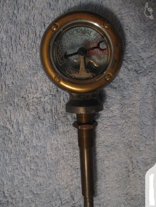

    Your roadster has been a significant influence on my build. You seem to be finding some really nice accessory parts lately. My latest purchase was this calorimeter - I like the exposed mechanism over the mercury thermometer - very steampunk.

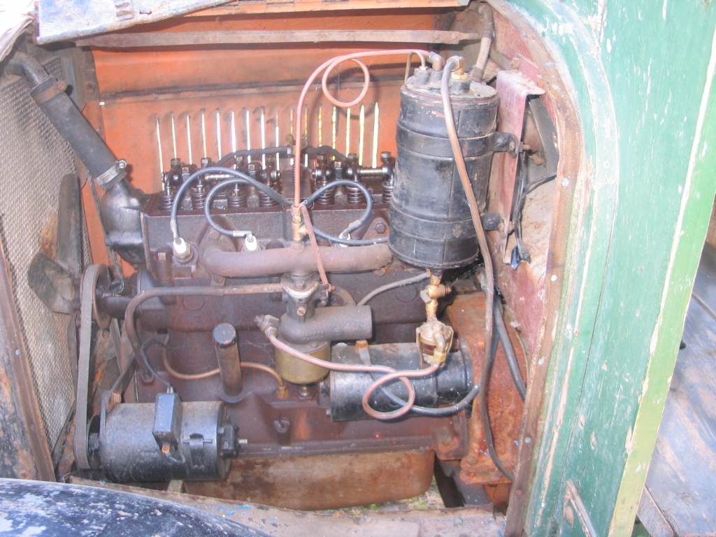

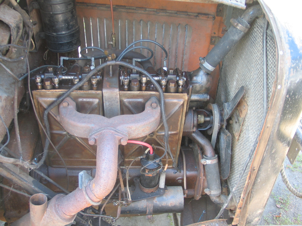

    I just looked at the Hambs SU thread and I see you were going to run 1 & 1/4 SU's on your chev 4 - did you get around to it. Not much info around on SU's being run on early bangers. Dont know anything about car in pick below?

    I ran a set of 1 1/4 SU's on the C4 in my avatar car. Performance was fine (higher compression, cam, 3 port head, inserts, pressure oil and counterweighted) but after a while, I didn't feel that they looked vintage, so swapped them for a large updraft off of a forklift with a flathead Chrysler (Plymouth) 6. The SU's gave more at high revs, but since there is virtually no competition events for bangers around here, the updraft was perfect for everyday driving.

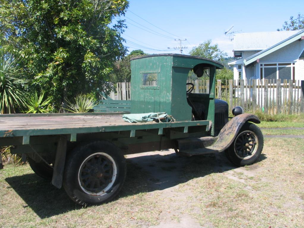

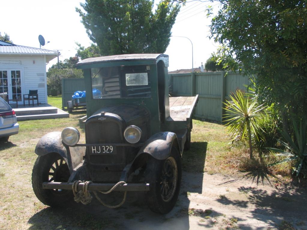

    Sad about your Chev - that was a real nice looking roadster. I sold my running barn find 28 chev truck a few years back fully expecting some twit to restore but was pleased to see it in a VVC mag over the weekend looking unchanged and in use. Picks below are as it was when I sold it. The wooden Colonial cab was standard as NZ didn't get factory cabs on chevs until the 30s.
  23. Kume, did your truck have the BIG Chevy 4 engine (looks like it)?
    Herb, REALLY sorry to hear about that car getting flipped!!!
    Six Ball and Stogy like this.
  24. Kume
    Joined: Jan 23, 2010
    Posts: 1,007
    Kume
    Mac I have heard talk of the 'big chev 4' but motor in my old truck was identical to car motor but with cast iron pistons and 4 speed box. I think engine number defined the truck motor but i wasn't aware of any other differences.
    The NZ 1928 truck had 4 wheel brakes but retained the 1927 sheet metal.

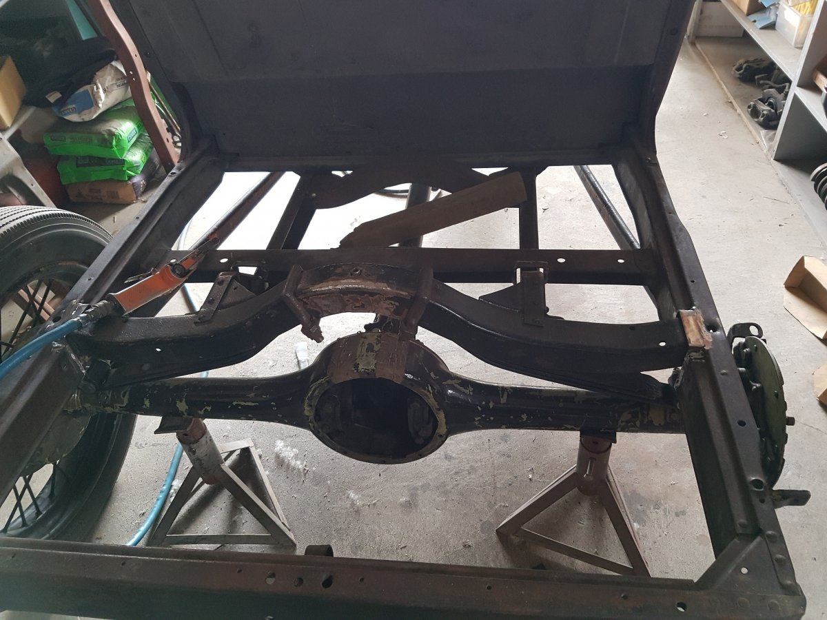

    well nearly two years, one divorce and two house moves later - some progress, albeit tiny. Front end and engine mounts sorted. 27 chev hubs on T axle works nicely. Second T cross member at front holds chev front engine mount. Decided to z the chassis slightly and drop rear spring, chev rear axle installed with model A radius rods .
    Another rear T cross member installed to take chev brake idler. Roadster subframe modified slightly to fit over everything. Not much suspension travel at rear but enough for my purposes. Andre Hartford's going on all four corners. Hoping 6 inch drop will look subtle. 20160421_093131.jpg 20161114_142117.jpg
