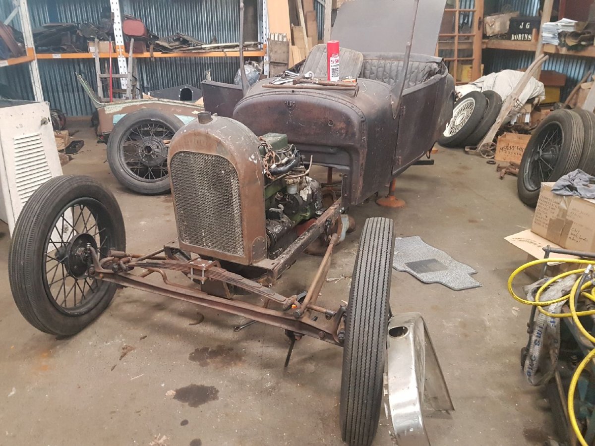

    A quick update after a little progress. Front end sorted including newly fabricated tie rod and steering completed (thanks Jodie). Just need to modify shock arm angles. Body on and ready to get ch***is mods certified - cross fingers. First time it has rolled on four wheels and am loving the stance at the mo - may raise rear slightly. Original recipe changed somewhat having ditched the whippet rad and using standard T a**** other changes that will become apparent soon. Rear brakes nearly sorted - using 1928 chev disc wheel drums on the rear to fit model t wires but adapter plate a little thick so some work needed there.
    Looks like a few T builds going on in NZ at the moment. 20170804_121227.jpg 20170804_121301.jpg 20170804_121832.jpg 20170804_121845.jpg

    I am not sure about radiator yet. My first inclination is to reduce the size of the top tank (take it back flush with the rad core) as the chev has a reasonably efficient water pump and doesn't need the thermo syphon effect so much. Or get a new rad fabricated. Either way pipes will need to match chev motor.
    My motor is ready to go - just need to fab an inlet manifold for the twin SU carbs and headers for the three port olds head.
