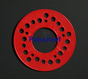

    In the never ending battle of loosing tools & parts in the abyss I call my garage I have misplaced a bright red wheel pattern guide similar to the one shown below.
    And I'm trying to determine the bolt pattern of the wheels that are on the red deuce sedan.

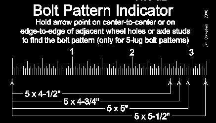

    Drew this up in CAD and put it on the back of my business cards:
    Canuck

    Now that's a service, well thought out!
    KK

    I love those plastic red and blue wheel pattern guides. I have 2 sets of each that I got at the swap meets. one set in my shop that I keep losing too all the time until I clean up and then the set I keep in my truck door panel that I mainly use for auctions, especially when I go to farm auctions. they always seem to have loose rims around. should see the look of other people when I first drag that out instead of a tape measure like others. then before I know it they have me measuring all the rims for them or they are p***ing my guides around the rim group.
