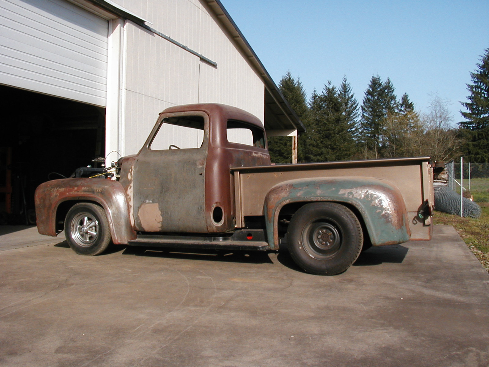

  5. Area.3.Fiftyone
    Joined: Jan 11, 2013
    Posts: 27
    Area.3.Fiftyone
    Yes, you are correct.
    If I do, I have a feeling you guys won't help me (which is a shame because I've read a lot of good information on this site - and the reason why I posted here in the first place).
    Regardless of the year, make: the question is still relevant.
    :D
    Not my truck, but what I am trying to accomplish.

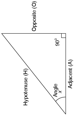

  6. Your thought process is correct. I have never chopped a top, but I know the amount cut out differs.
    If you want to do the calculations, measure the angle of the A-pillar (from verticle) and use that in a trigonometry calculation. Use your triangle! The overall elevation change of the chop would be the "A" side, your A-pillar angle would be angle "X". The calculation would be:
    cos X = A / H
    or H = A / cos X
    PM me if you need anything else.....

  8. Boyd Who
    Joined: Nov 9, 2001
    Posts: 2,196
    Boyd Who
    This diagram might give you a better idea...

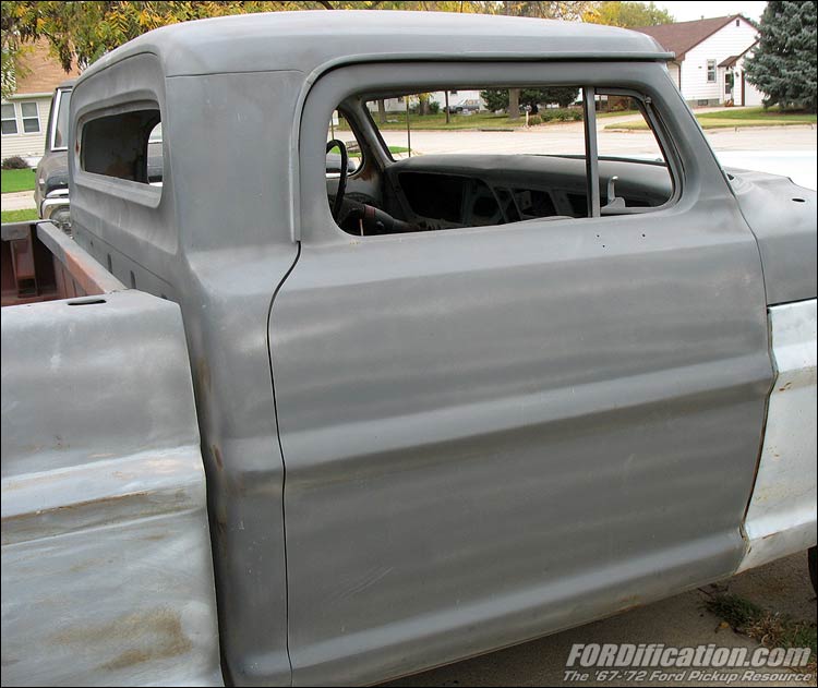

  10. flamedabone
    Joined: Aug 3, 2001
    Posts: 5,683
    flamedabone
    There is no real need to get that complicated. Figure out how much you want to take out of it, mark it with tape and cut along the lines.
    Hopefully, you are not chopping a 67-72 Ford truck like in the picture as that looks horrible, but if you are, remember that those cabs (and lots of other trucks too) are taller in the front than in the rear. If so, you might need to take an extra 1/2 or maybe 3/4 out of the front.
    Also, hit the search button for lots of good top chopping tech. Read everything and make your own decisions. Remember, it's only metal..
    Good luck and holler if you need anything.
    -Abone.

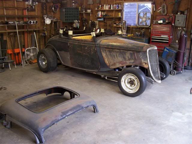

  11. flamedabone
    Joined: Aug 3, 2001
    Posts: 5,683
    flamedabone
    You might be able to tell in this pic...
    I wanted 4in out of the roof so I measured 4 inches out of the A, B and C pillar, marked it with tape and cut at the edge of the tape. Masking tape works bitchn for this.
    I cut 4 out of the posts, which is called a 4 inch chop. Yes, the actual drop is less than 4 inches, because of the pillar angle, but in the end it doesn't matter.
    Remember to cut the roof off first then cut off the 4 inch stubs. Trying to cut 4 inches off a roof flopping around on the floor sucks..
    Good luck, -Abone.
    PS. Here she is done.
