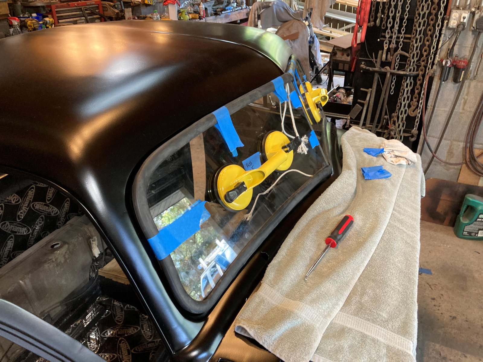

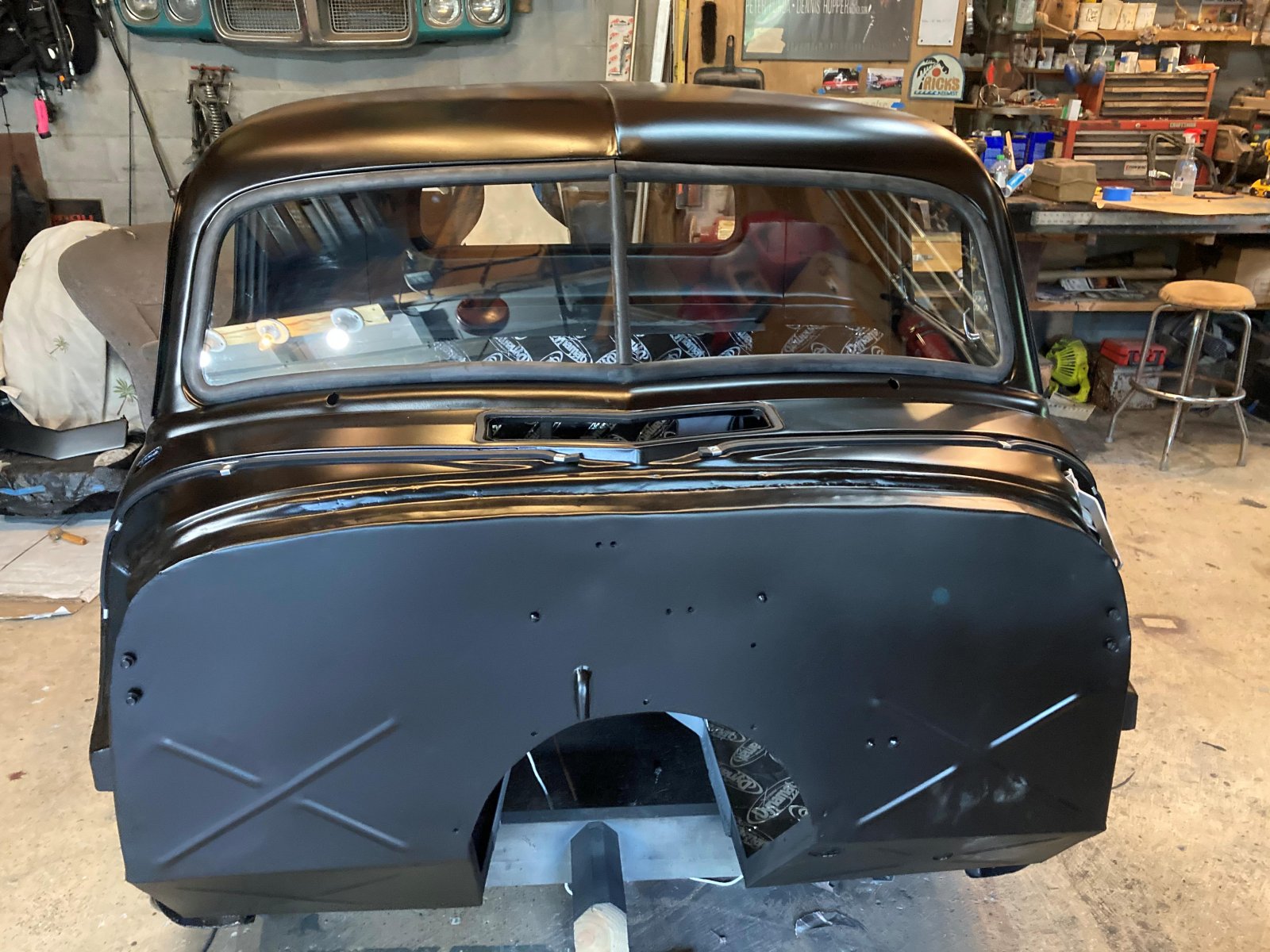

    5-30-22 Update:
    Some Success.
    I figured the windshield right, I figured the back window wrong.
    Using Masonite for the patterns was a good idea, easy to work with.

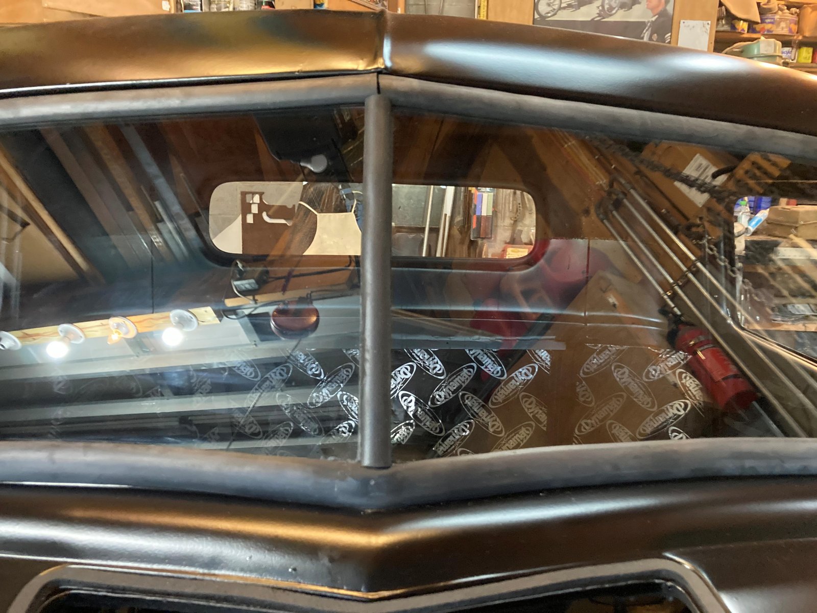

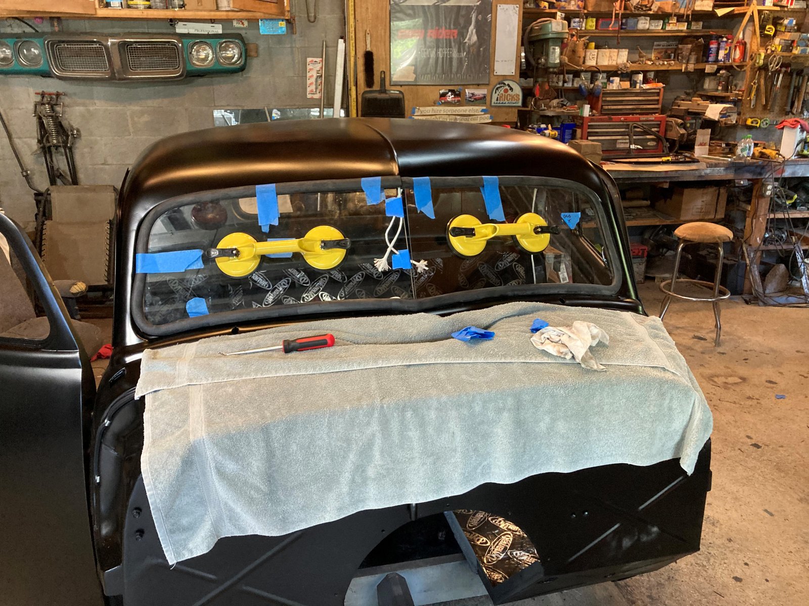

    Windshield:
    I installed it this morning, went real smooth & I was able to do it myself.
    I made an exact pattern of the opening & added 1/4" all the way around.
    I decided to butt the center seam, so I left a 1/4" gap.
    I used the rope method (3/16" rope, you install the glass in the rubber first, then set it in place), & started at the bottom so gravity was my friend. went real smooth.
    After install, I ended up with a 1/2"-9/16" gap at the center butt, which I figure too large to silicone, so I took a leftover piece of the back window rubber, modified it a bit, & used that as a center channel. I like it (much thinner than the original center strip).
    All the videos suggest sealer between the rubber & glass, and rubber & body. I prolly should do it between the rubber & glass on the bottom & sides.
    Rubber to body is sitting real nice, but maybe along the top & sides, I'll see.
    Back Window:
    Totally my F up.
    I made an exact pattern of the opening, & took off 1/8" all around (not enough).
    I never double checked the measurements after I made the pattern.
    After trying to install it I took it out & measured, was 1/4" - 3/8" too tall (same all around).
    So I trimmed the pattern, & installed it in the rubber to test.
    I'll have it re-made this week, should only be about $50.

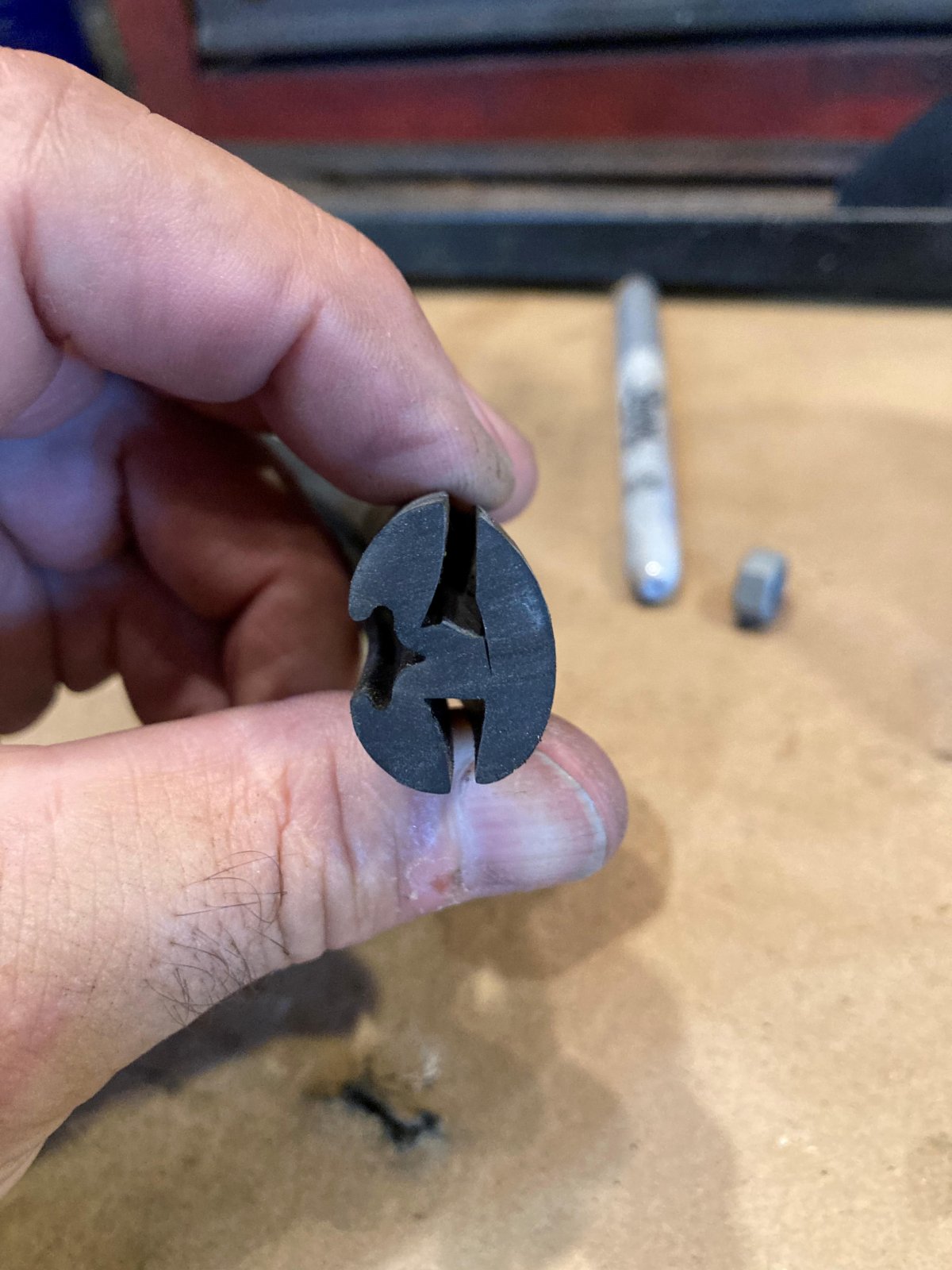

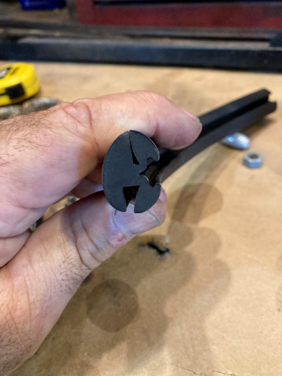

    Center strip detail.
    The 2 pictures or the rubber show the original back window channel, & the modified version.
    I cut the pinchweld side so that it was wider, & matched the glass side.
    Using a new razor blade it was not hard, took about 10 minutes at most.

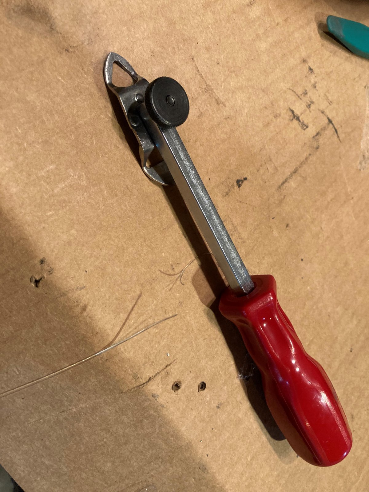

    All glass is done.
    I had the rear window re-cut, & it went in nice.
    Installing the lock bead was a bit tricky, but not too bad with the proper tool.

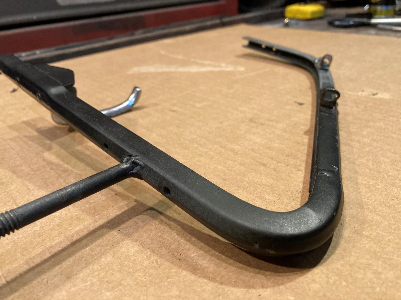

    Before installing the passenger vent window, I had to move the pivot point back to it's original position ( I chopped this frame in a different way & the pivot wound up too low), so the new rubber would fit right.
    Not bad at all (was easier than installing the door glass)
