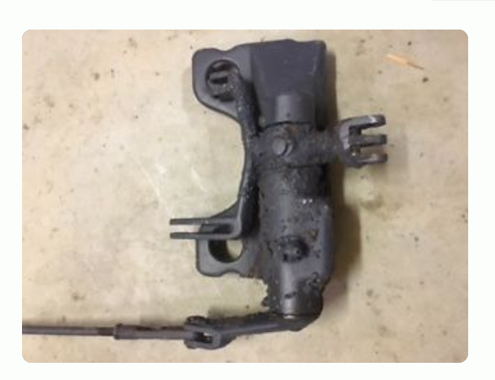

    1937 Ford mechanical brakes equalizer actuator

  16. Where's that part in the above drawing?
    Would the pedal be ~directly~ attached equalizer?
  17. squirrel
    Joined: Sep 23, 2004
    Posts: 59,682
    squirrel
    That is the part that is operated by linkage from the pedal (the bar hanging off to the left), and pulls the cables that go to each wheel (the four clevises).

    Also notice the grease fitting in that equalizer. Most of the time on old cars that area was bone dry, no grease! As were other spots on the brake system.
