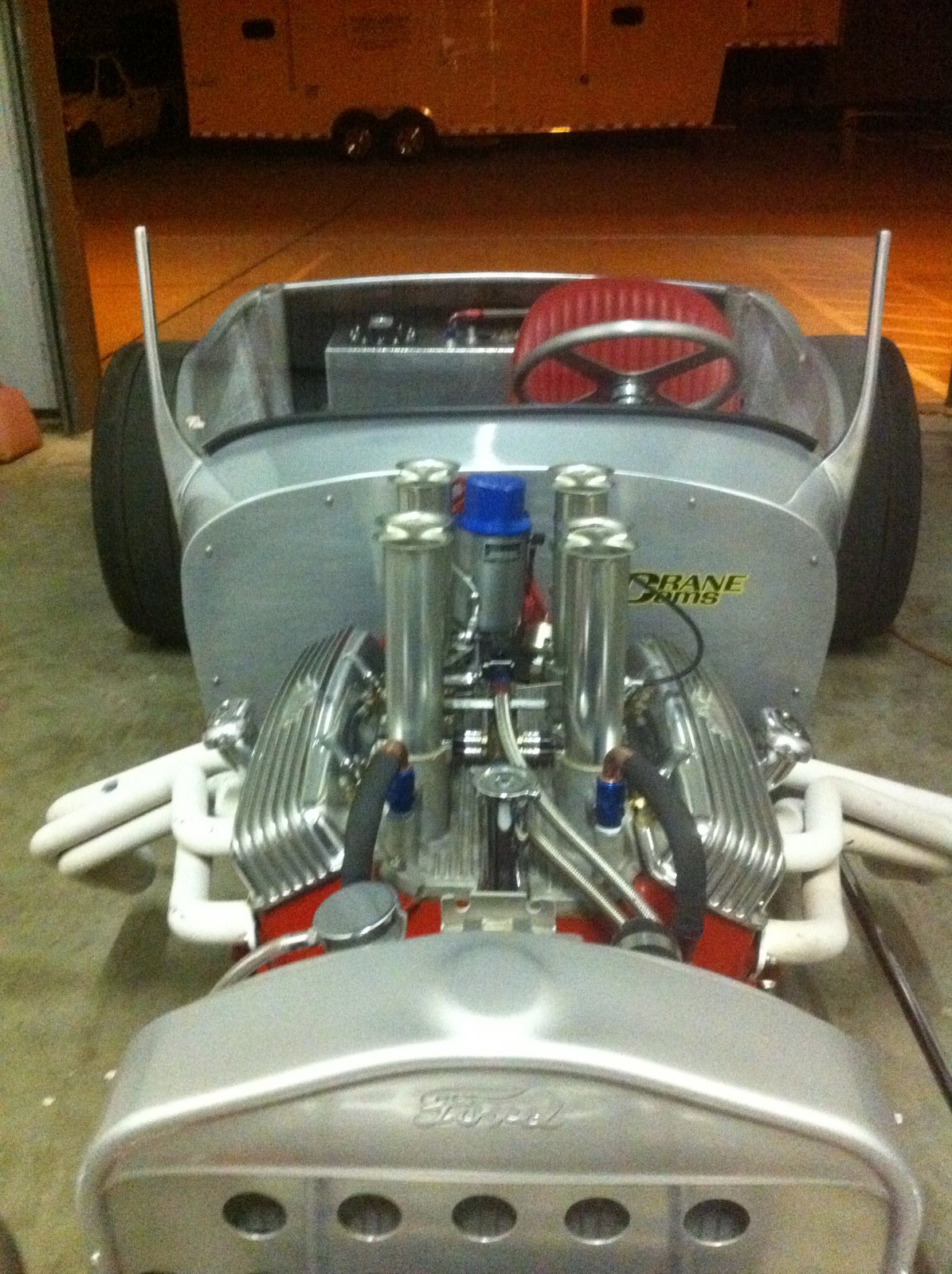

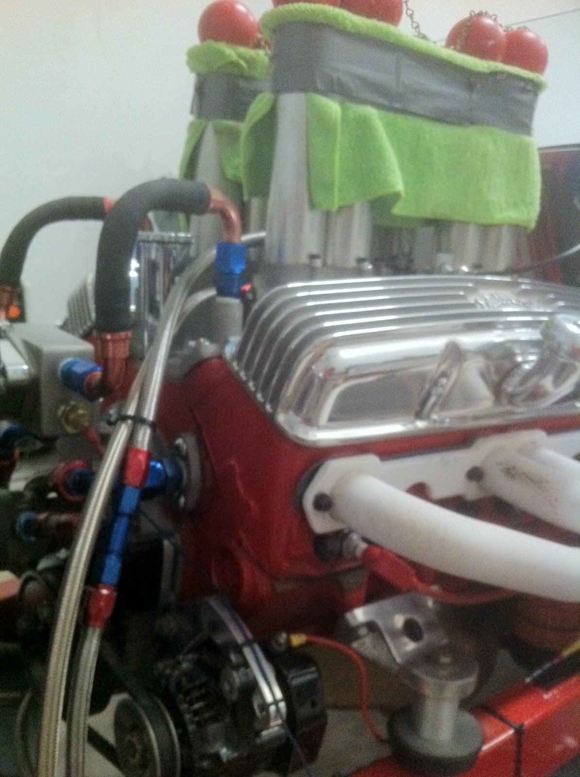

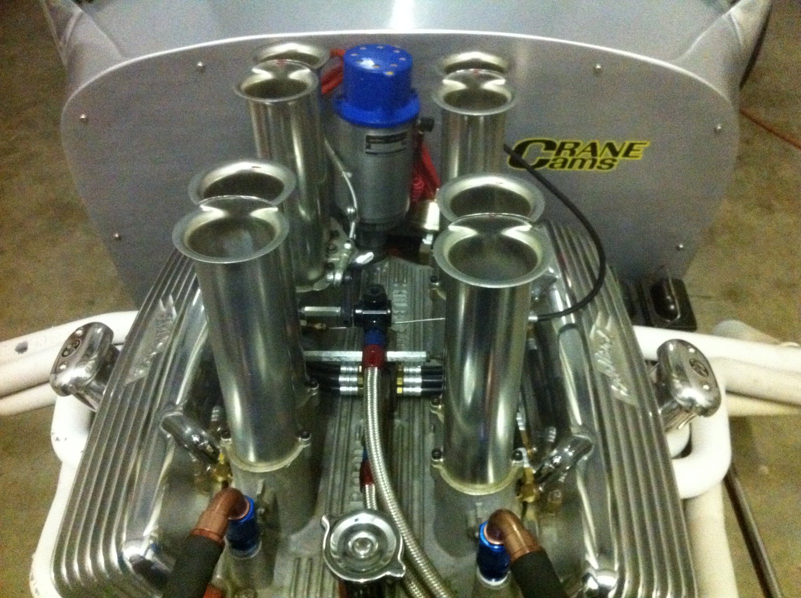

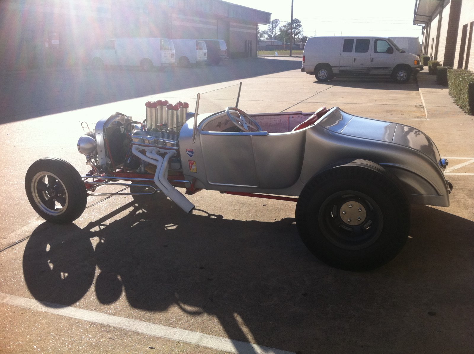

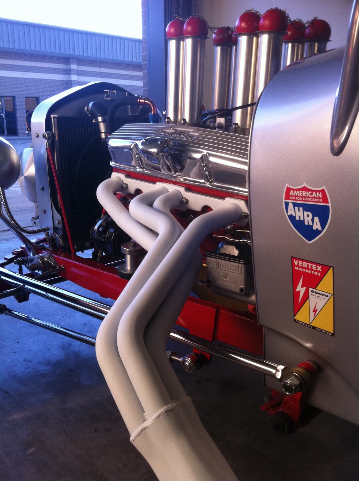

  5. Mike Lawless
    Joined: Sep 20, 2021
    Posts: 867
    Mike Lawless
    I've run MFI on my OT drag racer for more than a dozen years. I had a short flirtation with EFI on it. Being an old school guy, I just didn't wanna learn it. MFI is something I understand. I learned about it long ago, running on a 440 Dodge back in the 80s. My current system is quite complex as it runs eight nozzles on a turbocharged four cylinder engine. It's making just shy of 500hp out of 135 cubic inches.
    The primary nozzles are small, and I run an idle pressure control valve. This keeps the idle fairly clean. The secondary injectors come in at boost. A boost/pressure regulator allows increased fuel pressure to open the secondary fuel valve, and those nozzles start squirting fuel.
    Higher fuel pressure with smaller nozzles is a good thing. It's really ALL about the fuel pressure. The nozzle size, coupled with the byp*** jet is the pressure control. The higher the pressure at the nozzle, means you get a finer atomized spray rather than fuel just dribbling out.
    Although I run on methanol, I think my system is as streetable as MFI gets. It rarely ever goes out of tune, but methanol is a very forgiving fuel. The "streetability" is due to the idle pressure control. A lot of guys don't run it or even understand it.
    The beauty of MFI is the only thing that really screws it up once it is tuned is **** in the system. The fuel pump will lose a bit of efficiency over the long haul. I've made three byp*** jet changes in the last ten years. And, the car is consistent. Consistent enough to run only a few hundredths difference on any given day. How many guys with a stick shift car can say that?
    Another positive is that my son, who currently campaigns the car, is an EFI tech at an aftermarket manufacturer. He is sticking with the mechanical injection and learning about it.

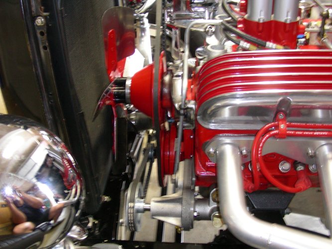

  22. I have been running Rochester fuel injection since 1963......do all my own work, tuning, etc. - on 315 HP 283s, and 375 HP 327s. Rochester is a constant flow system.......nozzles direct fuel into the intake runners above the intake valve. All my Rochesters have been trouble-free for thousands of miles........on non-ethanol gasoline. E-10, E-15, and E-85 will do bad things to these units.
    I also have modified a mechanical Hilborn injection system for my son's 302 Trans-Am engine. It also is a constant flow system, unlike timed injection for diesels and the new Chev direct injection engine......injection into the cylinders/combustion chamber. My son's car is extremely street-friendly.......very docile around town, but with instant throttle response. It has a custom barrel valve, by-p*** start-up electric pump, on-board wide band exhaust gas ****yzer, and a Dial-A-Jet (10 pills) for on-board adjustments (not needed often), a**** a few other bits and pieces I designed and made. We put together a calibration chart that uses ambient temp, humidity, barometric pressure for set-up and weather changes.
    '40 deluxe coupe - 327 FI engine.jpg '55 Chev 283 (fuel injection).jpg may 17 2009.1.JPG may 17 2009.7.JPG june 3 2007.10.JPG
    Shalamo, 6sally6, Budget36 and 6 others like this.
