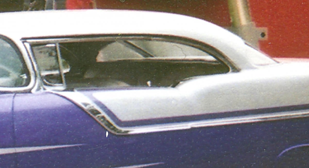

    Just spit balling here but this is what I've come up with so far;
    I'll use the springs out of the original handles as Cadillac will already be on top of the strength required for the return spring. I will also keep the spring tensioned at the original rate by keeping it at the original handle's length.
    I would like to use a tube down the outside of the mechanism to stop the ****on from moving sideways but I also want to be able access the internal contents if maintenance or adjustment is required.
    Thoughts?

    Cad, there used to be some more info on how I did it on the old HAMB. I had drawn out a diagram how I did it, and I think "chromed rat" took it and did a 'how to' using it.
    In essence, it is similar to your design. I used a freeze out plug for the door ****on, inside a piece of exhaust tubing. A bolt welded to the back of the plug, a fender washer on the back end of the tubing, and a hardware store spring inside the tubing, and a nut holding the plug and bolt inside the tube/washer.
